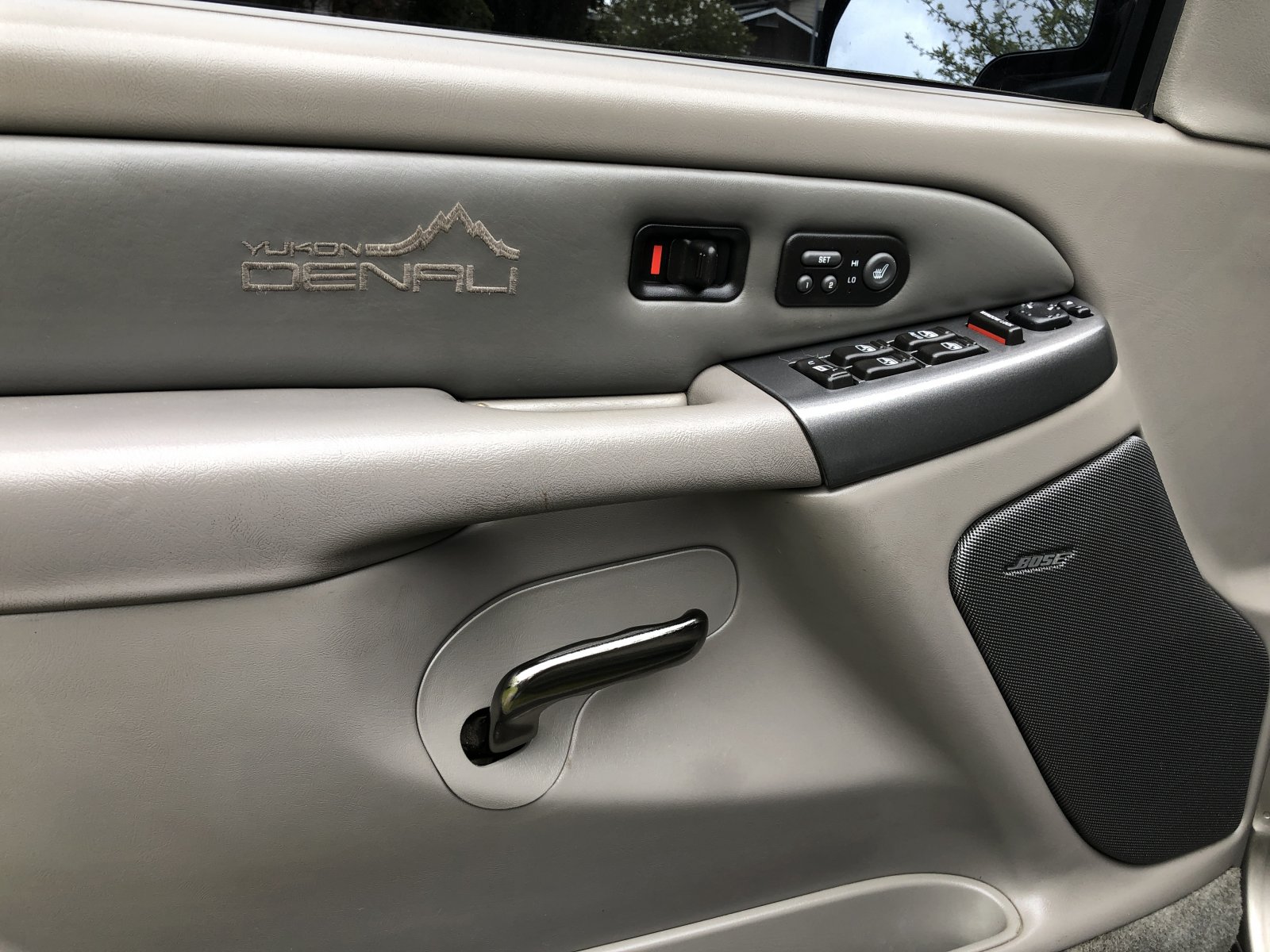

Door looks better with matching paint on the grill.
You know, I've had a talk with some of the other guys on the forum here and we all agree... you really need to find something to do with your time instead of just sitting around being lazy... you would be surprised at how much you could accomplish if you just set your mind on something and just got up and did it. ;)

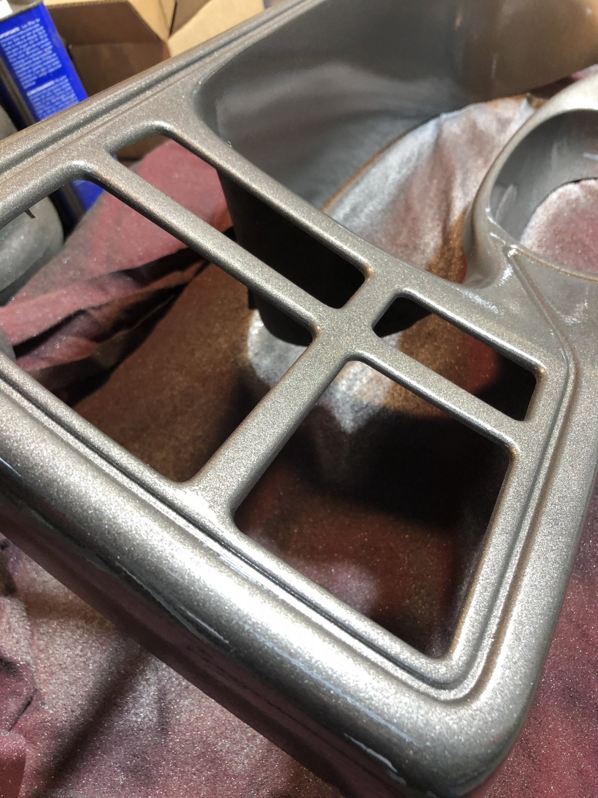

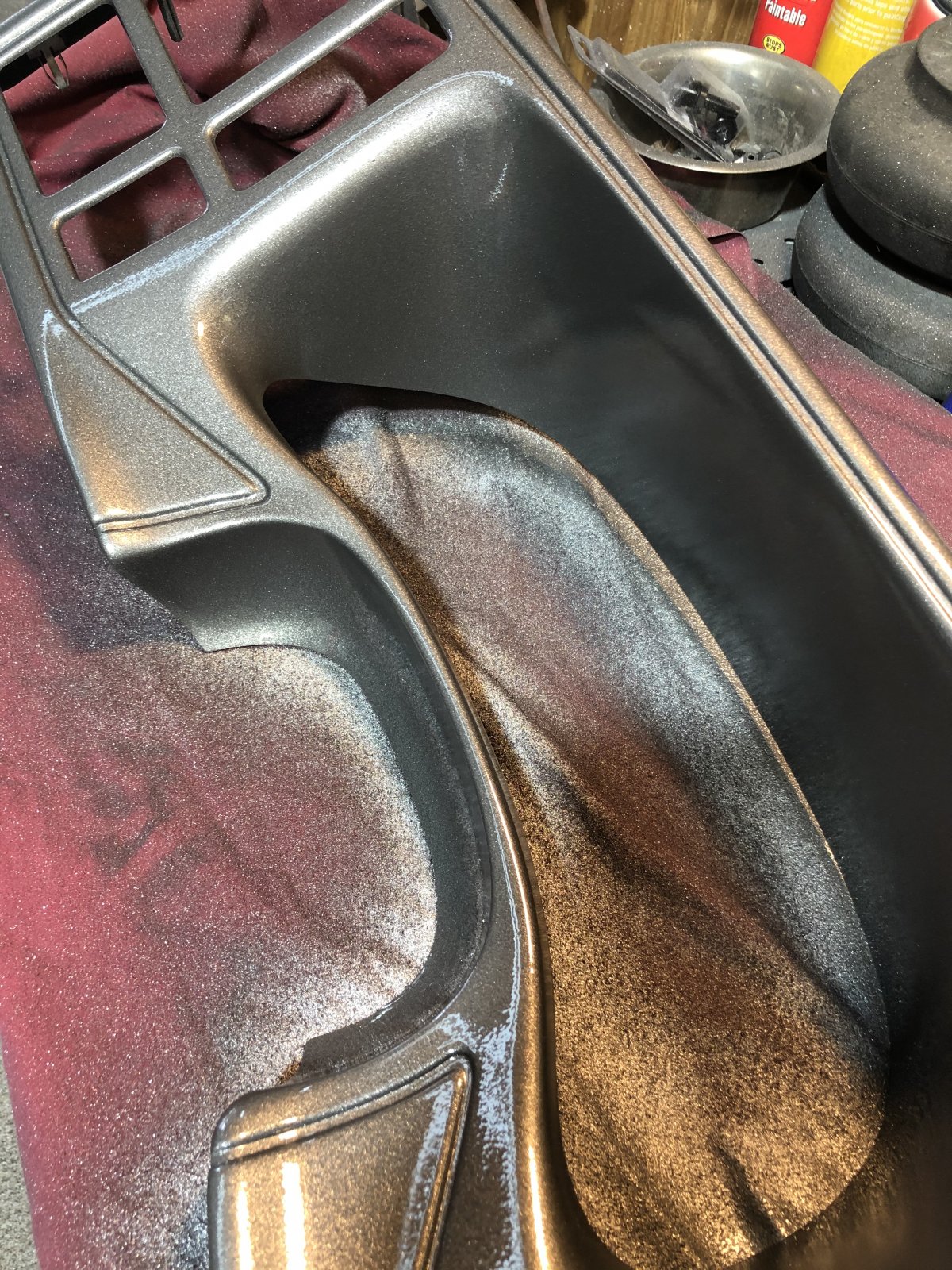

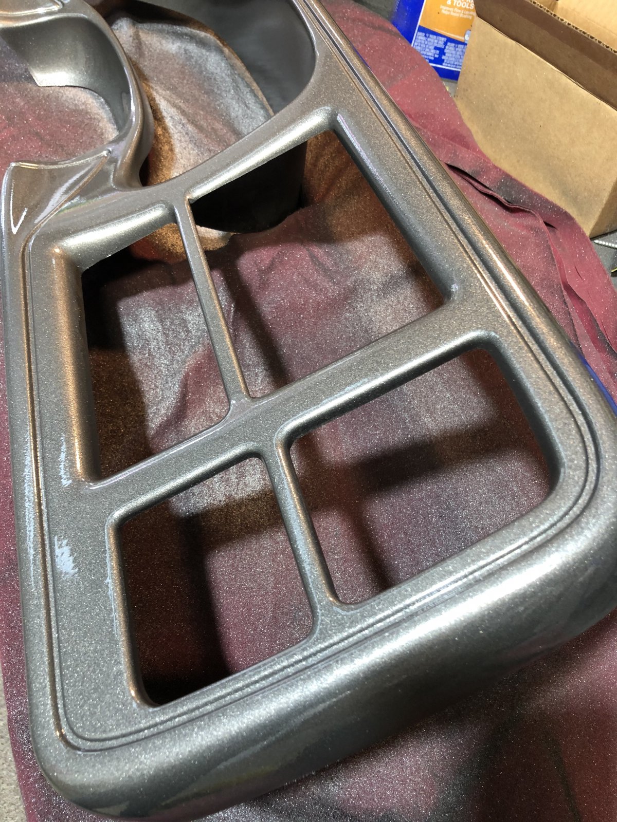

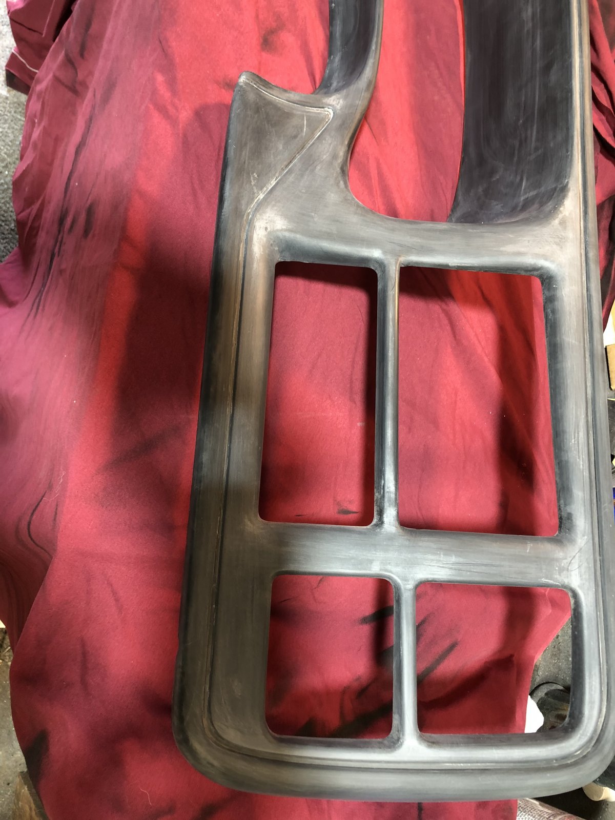

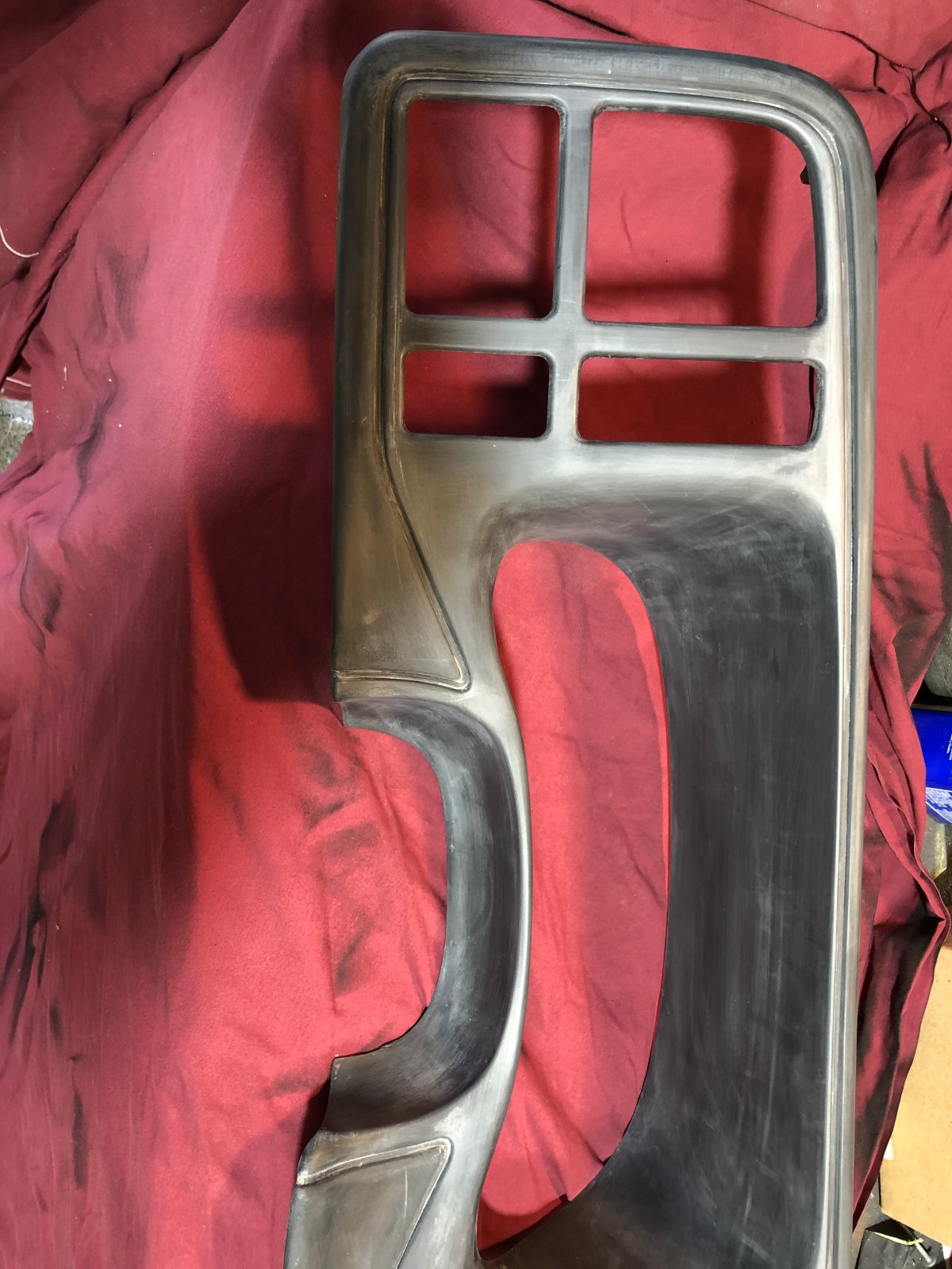

SprayMax 2k, it’s a 2-part in a can. Once you hit the mix button you have like 24 hours to use the can.
Only stuff I use . Half the time you don’t need to wet sand after. I usually still do but that stuff lays down smooth as glass.

That’s better. It looked like shit before!

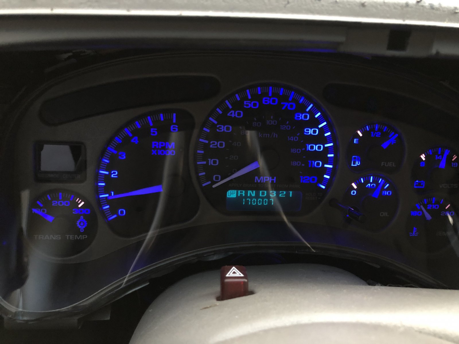

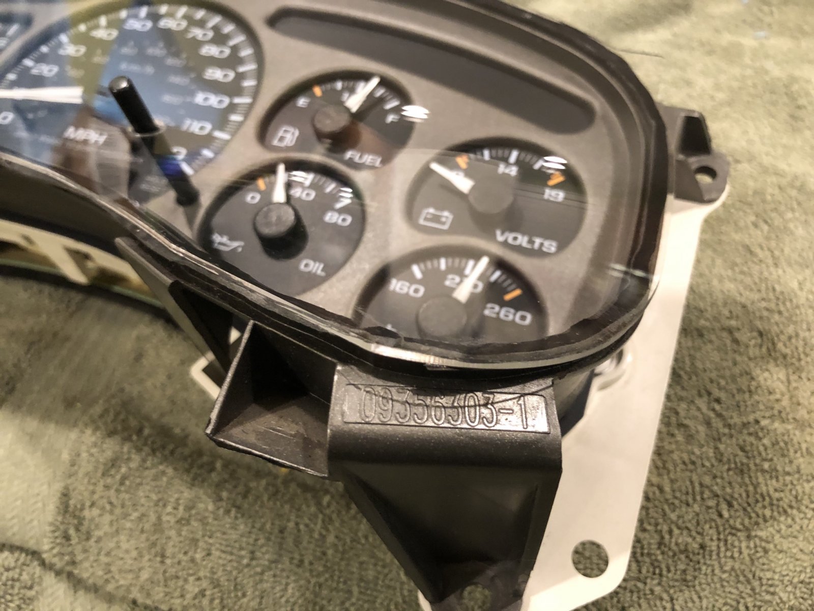

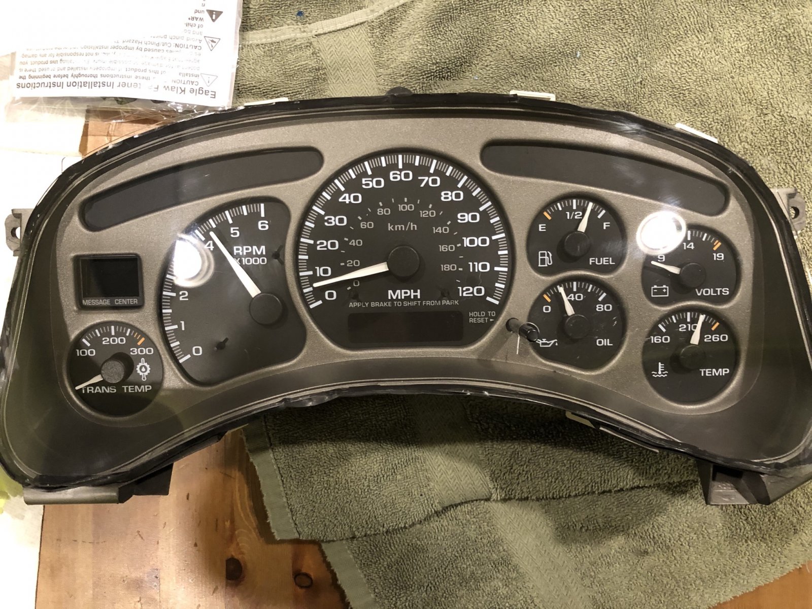

I thought about painting the interior shroud of the cluster but since I replaced the clear lens last year and it’s glued down with VHB tape, i decided to leave it alone. I would have to remove the lens to paint that part. I did pull the rear board off and add 2 layers of blue tint to the PRNDL display so it’s not so green. Thanks for the tint @iamdub. It took me awhile but I finally got it done.

Looks good. I need to have my gauges done some day

Looks great man. I still need to do mine.
