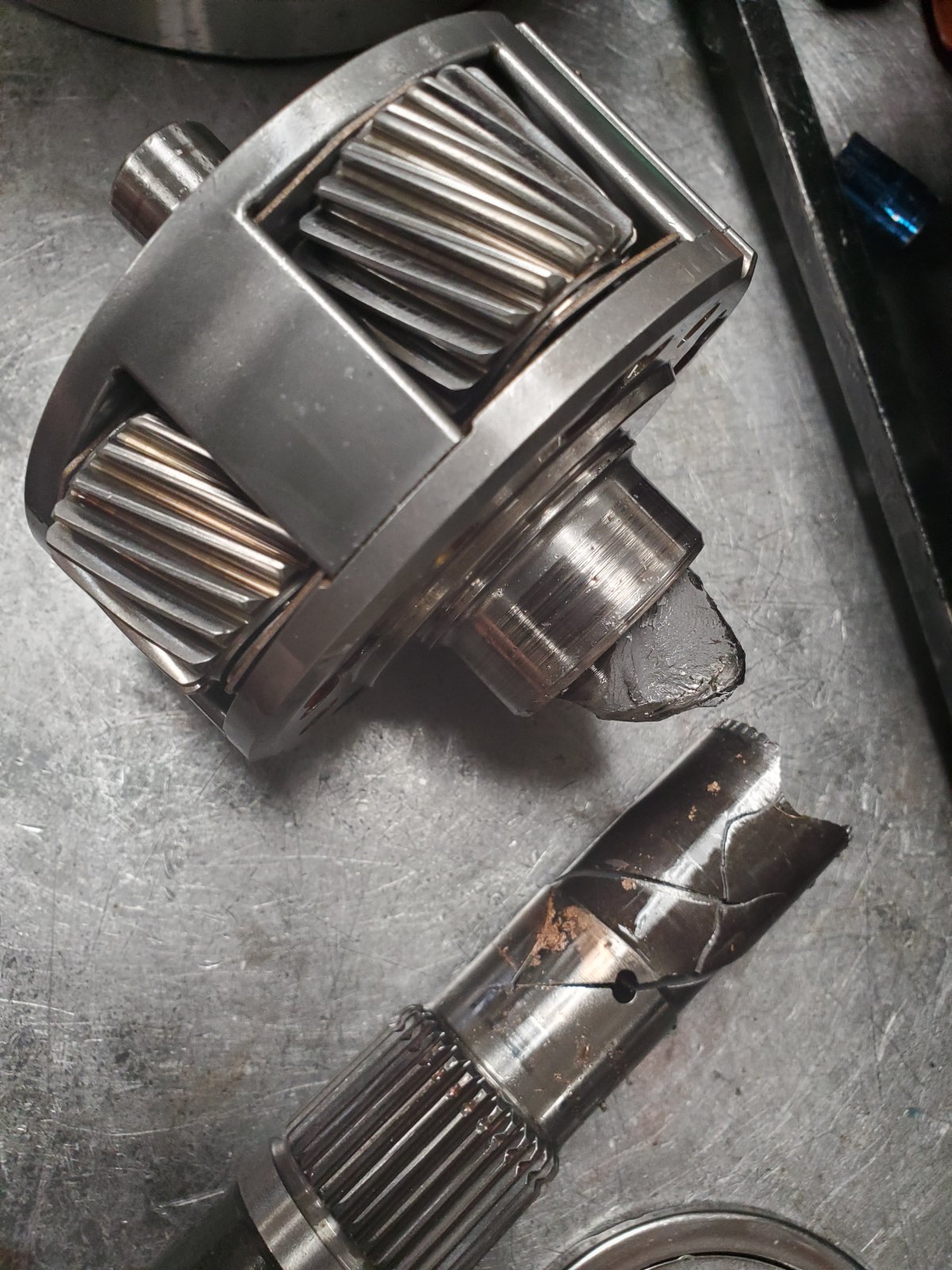

It looks like Ryan at Performabuilt has found the silver bullet. And it looks like it was my fault although I did not know this could be a problem. When I changed the filter at 2000 miles I used RTV on the pan gasket which NOW I find out is a definite no-no. He found silicone blocking the feed for the servo on the pan rail, causing it to not release. Shit. I'm pretty sure I used RTV the first time I installed the trans too, and changed the filter after break-in. That would explain why it didn't last long after I did that the first time. They should say something about that in the instructions.
Here is his email to me today:
Please call me or have your tuner call me and i will explain whats wrong. The servo isnt the problem, the silicone blocking the feed on the panrail is and that isnt letting the servo release properly and you will get hard shifts from that. ALSO line pressure in marks tune needs to be verified that its OEM STOCK PER THE STOCK BIN FILE. My number is *** *** **** with further questions. Please listen and follow my instructions. Had it not been for the silicone blocking the release for the servo you would still be on the road. The line pressure check in the pcm is a safeguard and is required for all of our transmissions.

I don’t know yet but after that discovery I would be real surprised if they do. And yeah I think I’m feeling better about the future with it. The first time this happened, it was at WOT on a hard launch racing a Subaru STi off the line and when it hit second (REAL hard) I heard a terrible noise and that time it grenaded the thing so bad that it killed the engine and I couldn’t even start it up, things were locked up. At that time they must not have discovered the blocked passage, probably because things were such a mess. Ryan said he’s sure I’d still be on the road if it wasn’t for the silicone causing the servo to not release and I have no reason not to believe him. I have done some reading on these passages for the servos on the pan rails and it’s a thing. Do NOT use RTV to install a pan gasket on an automatic trans or you could cause big problems. I did not know, who would have thought. BTW I beat the Subie until I hit second.

It might be ok to use just a tiny bit between the gasket and pan. Obviously I didn’t. I do not remember but he sent pics of it. I have no reason to doubt what he’s telling me, and from what I’ve read lately, it’s definitely something you don’t want to do with an automatic trans. Oil pan, yes at the places it’s supposed to go. Diff covers, it depends on the gasket. But if you read up on transmissions it’s definitely something you don’t want to do. There’s small passages where the fluid drains back into the pan from the servos and if they’re blocked the servos don’t release right. It can cause all sorts of problems.

Great news today. The trans is done and shipping today. But the best news is Performabuilt covered it under warranty even though it is way past the 2 years AND it was my fault. Ryan said since it was an honest mistake by me they covered it. And he said he thought the instructions warned about silicone on the pan gasket but he’s going to look at them and if it’s not there he is going to include it. He said if the line pressure is set to stock ( still waiting on @BlackBearPerf to verify this 100%) and there’s no blockage on the pan rail passages this trans will definitely do the job. He said he fished several pieces of silicone out of the servo release/ valve body which caused the band to fight the other components resulting in extreme stress on the other hard parts as evidenced by the output shaft. Once again I can’t say enough about Performabuilt, from the great communication to the speed of their warranty work to the great warranty,period. They really went above and beyond for me. I can see why they’re considered one of the best.
