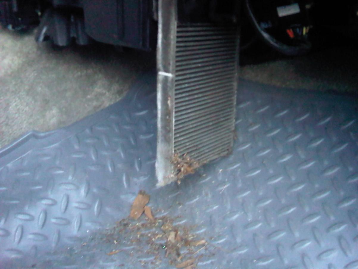

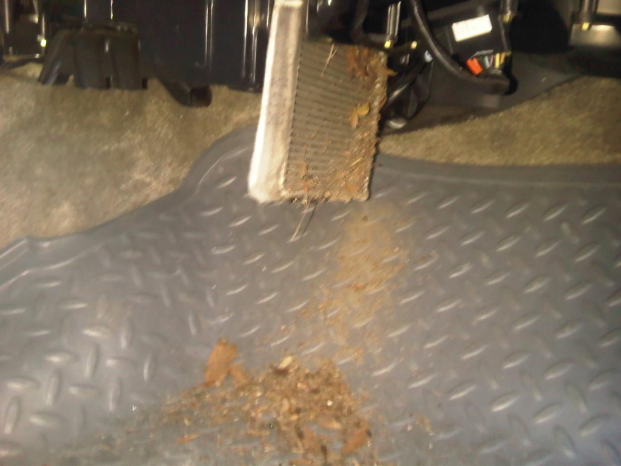

Kind of hard to see but there is one clip in front and one screw in the back that holds the cover on. Take the screw out and it will drop out. Remember, there are two filters in there. I ordered the FRAM Freshbreeze off of Amazon the other day, cheaper than auto parts stores. They come 2 in a box... Just did it last night!

Mine does not look like that unless its onder the black cover that goes almost down to the floor board. Got any pics looking up some under there? Pic of that are and the upper dash part? Did you take a black cover off to get to that section under the dash? What year is your vehicle?
Chucktown Mako
Feb 17, 2010
68
Yes, you have to take the black cover off. 3 screws, one under the center-dash area, which is a P.I.A. Sorry, don't have any more pictures of this area. Once you take the cover off, you will see it. It will be to the left of your blower motor resistor.
