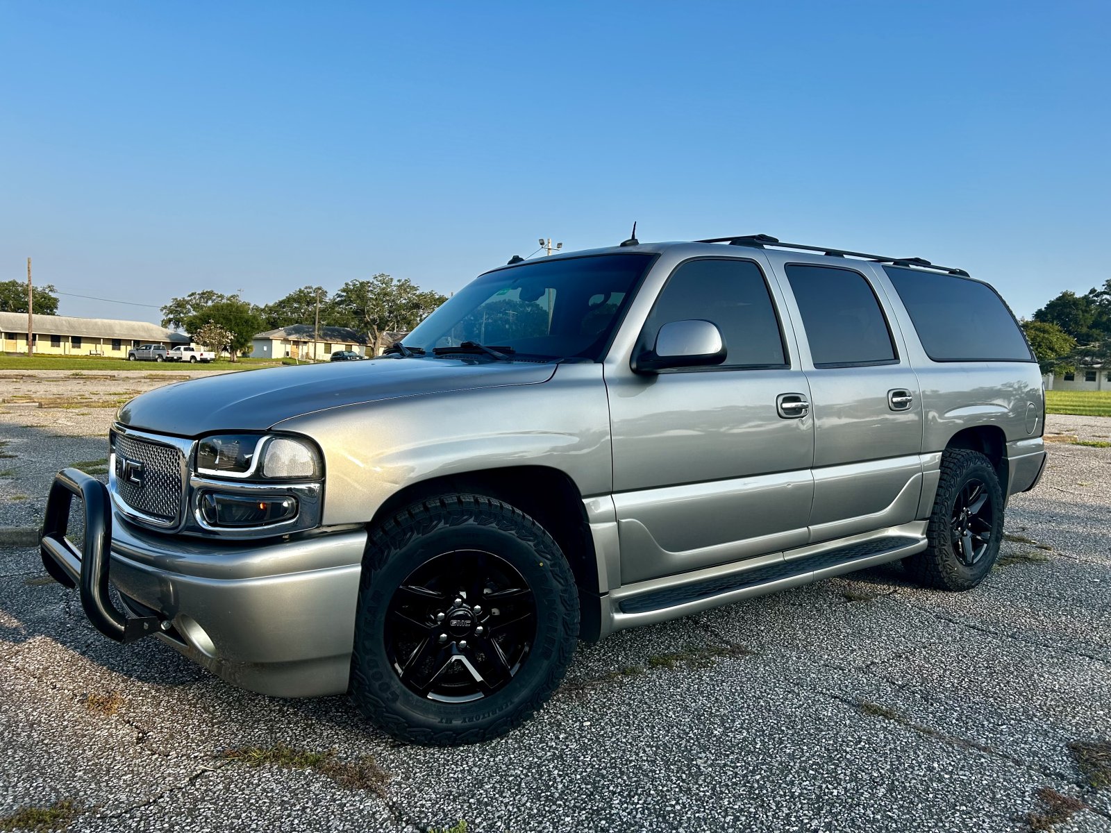

BLUF: seeking WWYD guidance on best areas to invest in preventative maintenance to minimize common issues for the next year.
2003 GMC Yukon XL Denali - LQ4/4L65
220K, original engine & trans
I am looking for opinions on where I should focus doing some preventative maintenance to try to mitigate as much risk possible over the next year. Obviously, with the current age and mileage anything can go wrong at any time. I would like to gauge the members here as there may be things I am not thinking about, and second opinions are often helpful.
Maintenance performed since I've owned it:
Tie Rods (ACDelco), FR Wheel Hubs (Timken), FR rotors/pads March 2022
Knock Sensors (ACDelco) August 2022
R rotors/pads October 2023
ACDelco spark plugs/Summit wires July 2024
x4 Goodyear Wrangler tires August 2025
Oil changes every 3-4K (Mobil 1 High Mileage/ACDelco filters)
What I know it needs, not necessarily mechanical-related:
Master window switch - functional other than FR passenger window, will try to clean it before replacing
PASS R window regulator - cable is frayed
Wiper fluid reservoir - leaks, but is a PITA to swap so low priority
What I am considering doing and why:
FR & R diff fluid - no issues, but I have no knowledge of whether this has been performed previously or not.
FR & R shocks - FR look to be original Delphi and R were replaced w/ Bilstein at an unknown point. Rear air compressor still works fine, no signs of leaking shocks.
Coolant drain & fill - I know there is a small coolant leak somewhere, I add about a half-gallon of DexCool maybe once a year, but no obvious major leaks and no overheating issues thus far.
Trans fluid drain/fill + filter - Trans fluid looks fine, does not leak fluid so I am on the fence about this one. I have never added fluid and have no knowledge of when/if the fluid/filter have been changed previously.
I am very much of the "if it ain't broke, don't fix it" mindset, so I am hesitant to do anything that may create more problems. Currently runs/drives/shifts great, and has been on many long-distance trips in the 4 years I've owned it. No plans to sell, probably ever.
Any insight, additional areas of emphasis, or experience is appreciated. Thanks
