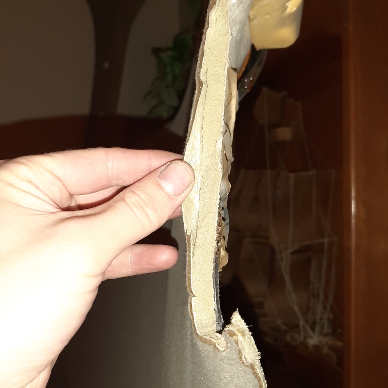

I got the headliner out. was pretty easy. I am curious the fabric is just the lower slice, do I need to replace this foam between the fabric and fiberglass?

I don’t think you need to replace the foam. Only if it were damaged.

The headliner material is foam backed--is that the foam you're talking about? If just the fabric material came off without that thin layer of foam still attached to it, you'll need to scrape all of it off. Whatever is left behind will show through your new headliner material once it's glued down.

This^^^^^

Not to mention, the foam is what breaks down and makes to original headline fall off and sag.
If you don't remove all of the old foam the new fabric will soon start sagging again.
I always got foam-backed fabric to do my headliners. If yours isn't, I imagine you're going to have to add that layer yourself.
