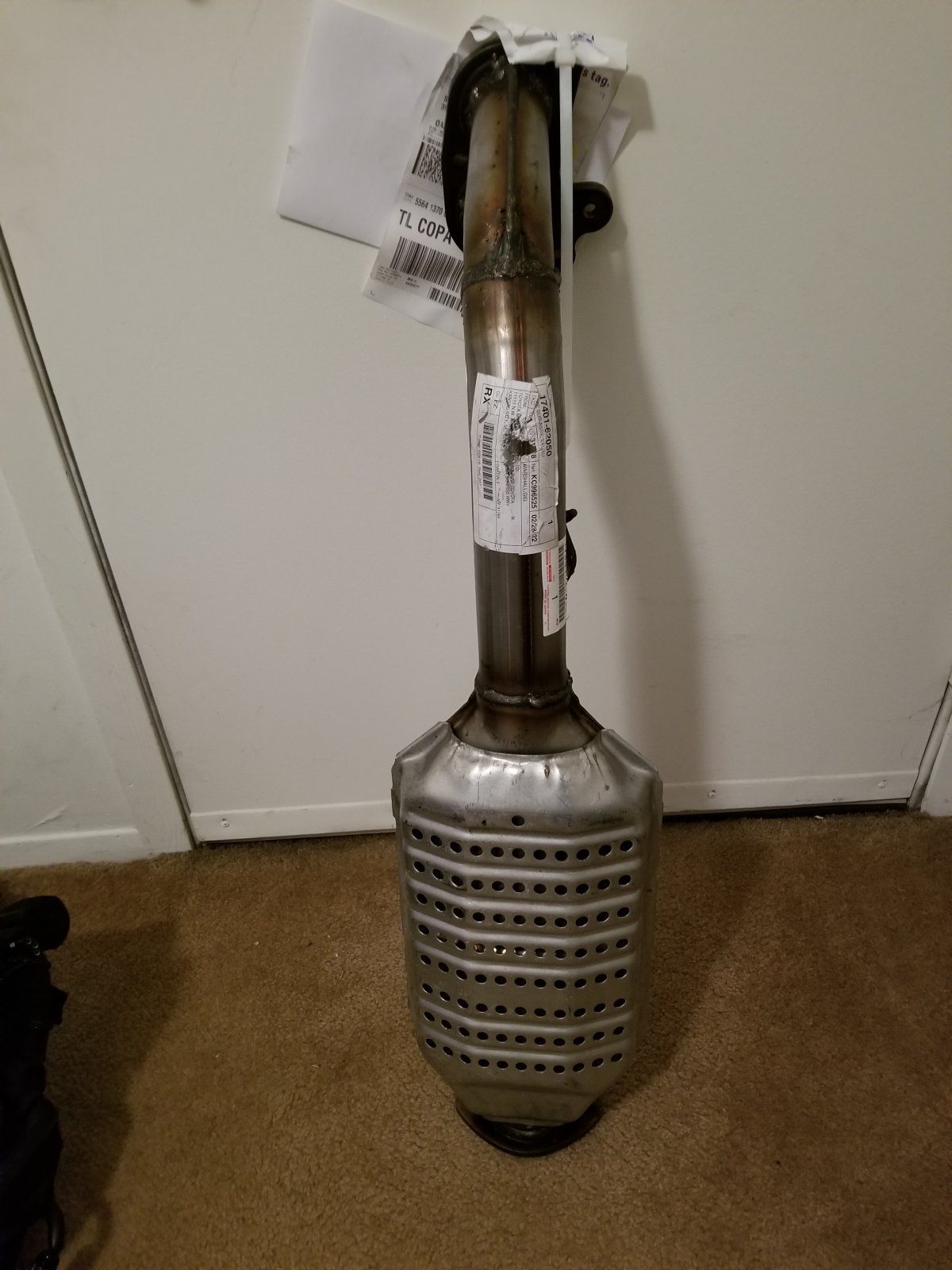

NY here same issue.
The online and other places i looked Magnaflow and all that... told me they would NOT ship to NY. I have a 97 4 runner which i love. The LAST CC in the country was found for me @ $2200. A dealer/warehouse had one and shipped it to my dealer here in NY. i'm told that part is not available through Toyota anymore... while at it i also did the entire exhaust system- THAT i was able to get through MF. A lot of money for an old truck but i really like the truck.
