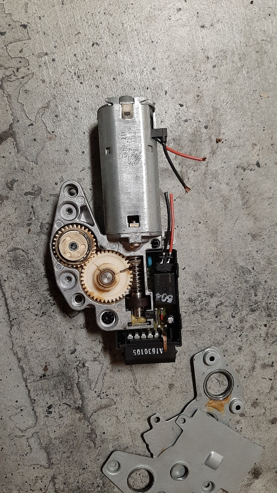

hit a new snag. i got a ndifferent sunroof assembly from salvage yard. its all cleaned up and in the truck. however the motor is toast. gears are cracked in it. i need to find new gears or a new motor. however gm discontinued the part number :(

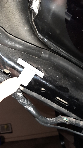

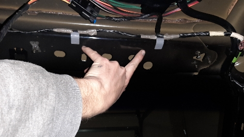

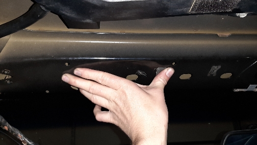

I ran into something new. I need to figure out where to order these clips. they are missing from my driver side and think maybe reason for intermittent rattle I have up there.

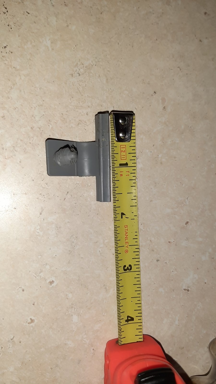

The Wiring Harness Clip
I ended up going to the auto parts store, ClipsAndFasteners.com (called as well), and surfed GmPartsDirect.com I also called a buddy who built these trucks at GM factory. It looks and seems as though the wiring harness is the part number and GM doesn't source those fasteners. I'm sure somebody sells them however, no idea how to search for it without a part number or name.

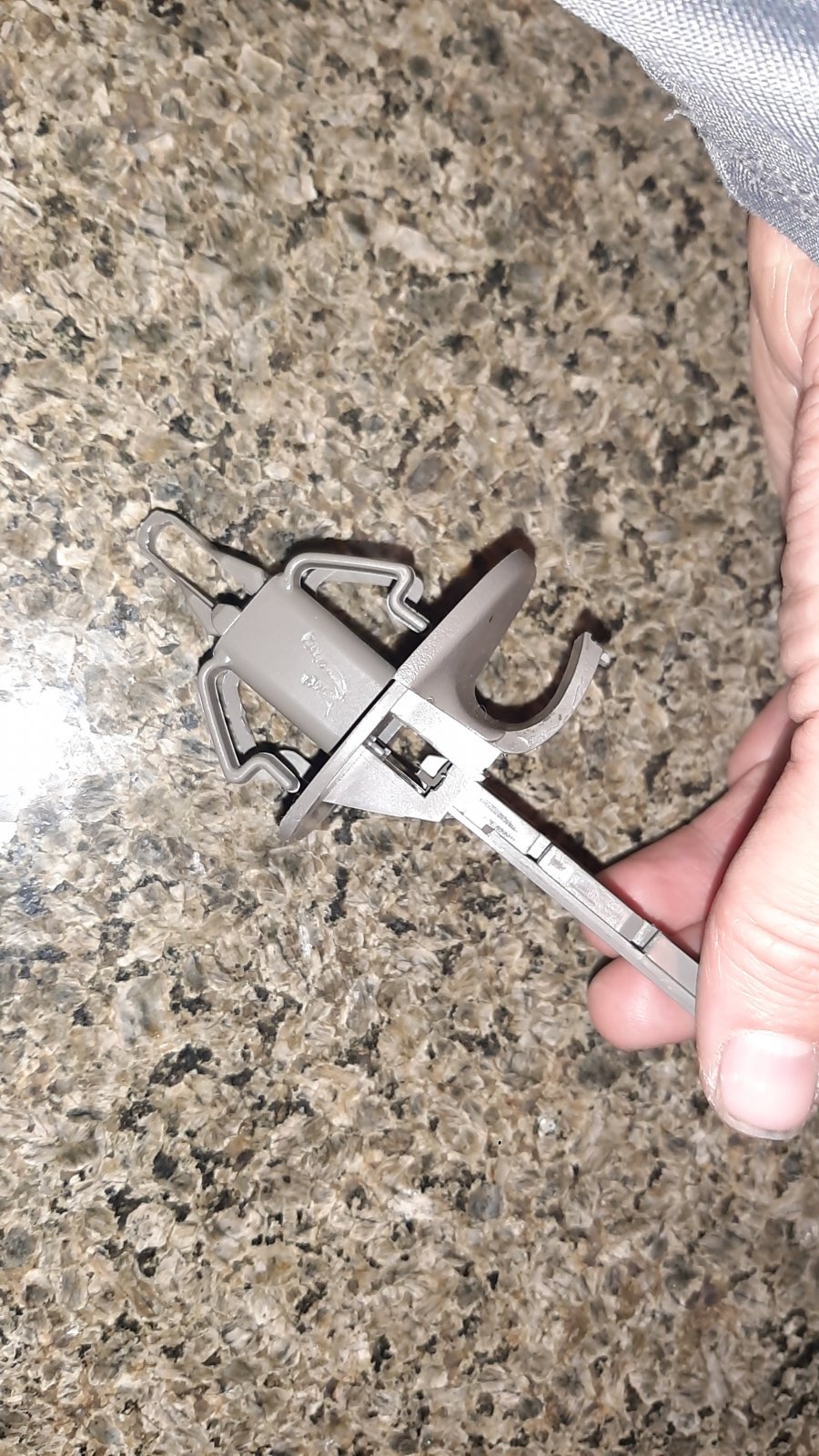

The coat hook
The coat hooks are rivet style. The hook has a pin that comes down and separates the retention clips. I'd think GM has some other coat hooks that work in the same fashion. Just not sure what year make or model they would be on.
The coat hook
View attachment 241374 View attachment 241375
If you go to an online GM parts dealer and look them up, the coat hangers for this are discontinued, pn 15760164. Looks like they’re a wrecking yard part. The ones for the newer models are completely different.
