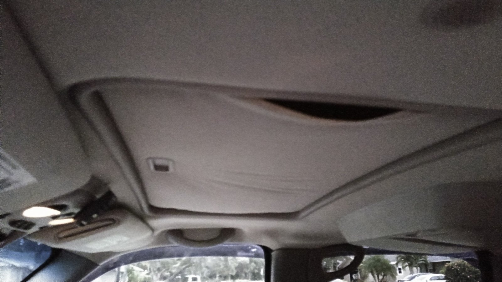

Okay so I've figured out that my truck headliner is M2140 Medium Dark Pewter as per "Surcolor Automotive Headlining" samples card.
However, this only comes in 60" width with the 1/4 foam backing. The headliner is exactly 60" wide. That doesn't figure in any of the contours :(

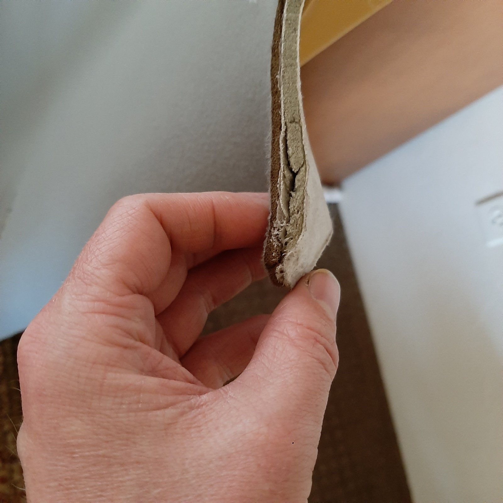

I also notice the foam structure of headliner in some areas is damaged. Mostly at corners where pillars are. Somebody manhandled this headliner before. It's not terrible but would like to repair with some foam glue of some kind? Any ideas?

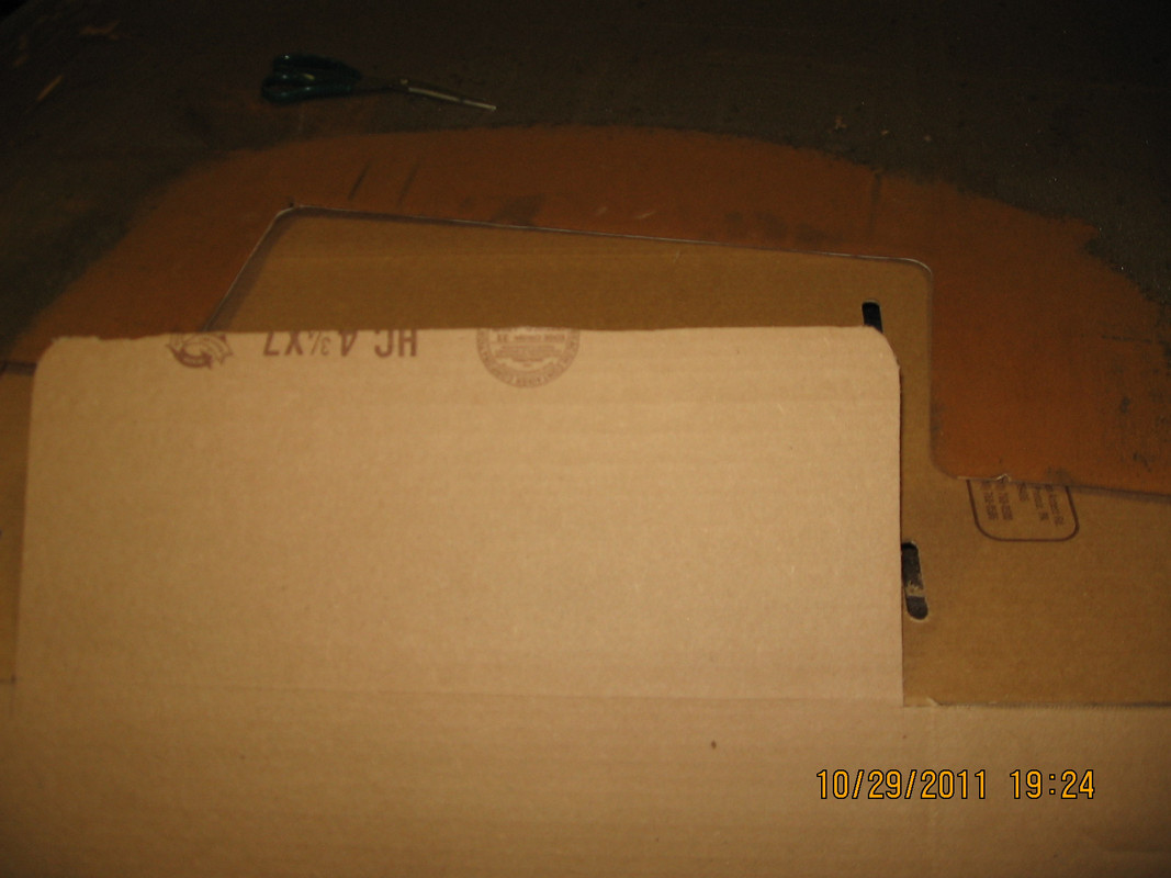

You can use cardboard to fix that but curved areas will be tough to form it without showng lines. Here is one I did on my old Suburban when I removed the rear AC off the roof. Used the carboard pieces like a patch and used a cardboard backing so it filled the hole flush and glued it all together with the spray adhesive them mounted the fabric.
