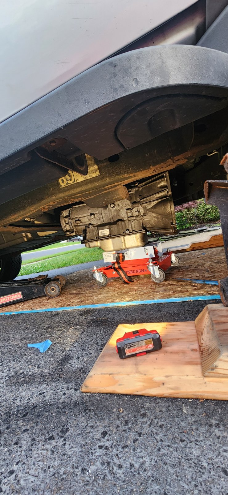

If you're doing it on the ground you need a lot more than I have to get it out. The tail is up against that permanent crossmember. Ill work around it but putting in the tourqe converter is going to be fun!
You definitely need a little more height. At this point you could get away by Jackie in the back of the vehicle up an extra 8 or 10 inches

My floor jack is maxed out at around 19" high. Are you using blocks on the jack pad to get extra height? My 6 ton jack stands will extend to just under 24" if I can safely get the truck up that high. I'm in the 50+ club so any extra height is welcomed to lessen the toll on my back. Pulling a transmission on the Audi A7 in February with the car sitting at 15-1/2" nearly broke me.

quick jacks go to 24in. plus you can add a suv kit to get a few more. they have gone up in price and you need a place to store them, but I couldn't work at home anymore without them. if you work on a few things, I think it's worth it but a place you can't get a lift
