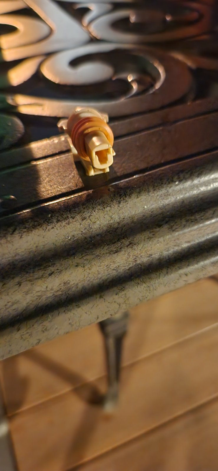

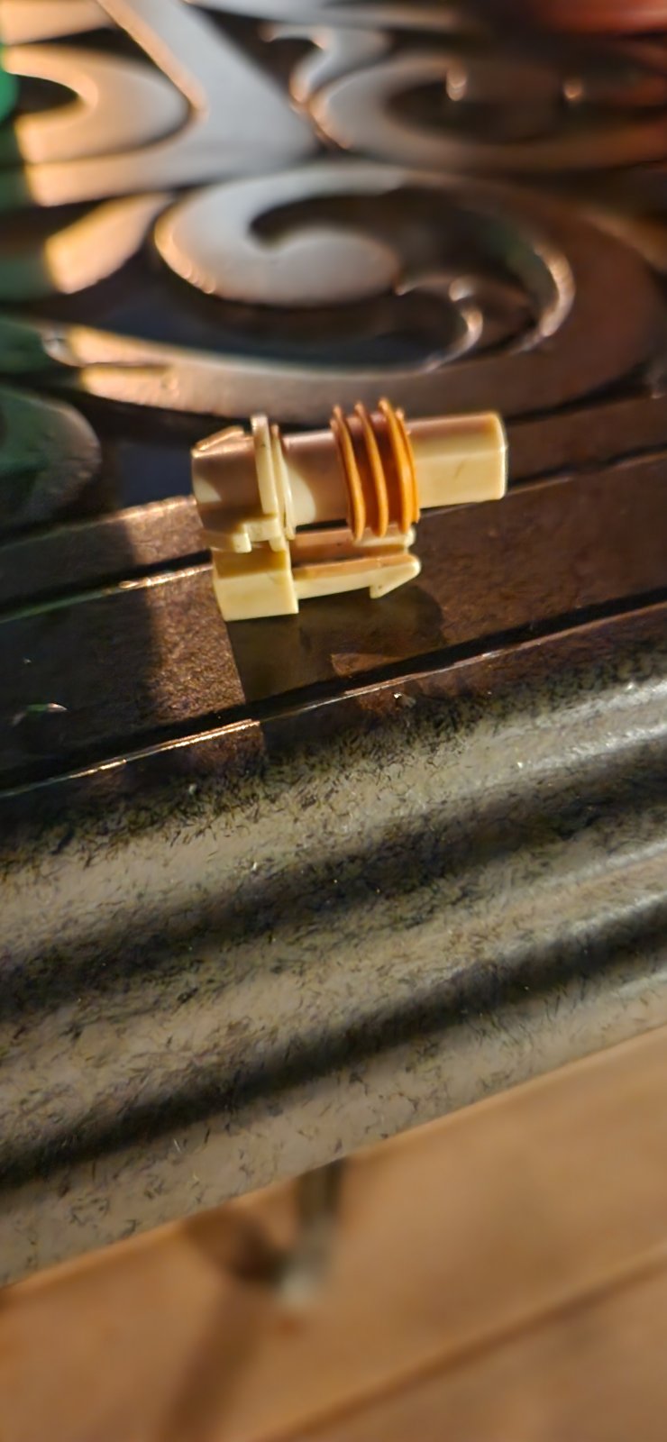

Anyone know the connector # for the ignition signal wire to the starter? Had some damage during re assembly. I ordered a PT1233 but Im not completely sure. I tried my first effort at de pinning but couldn't get it back together..

You can also simply search for "2010 Chevrolet suburban starter solenoid pigtail harness connector"
You might get lucky and find one in stock in a local auto parts store for around $40.... Or much cheaper on eBay.
