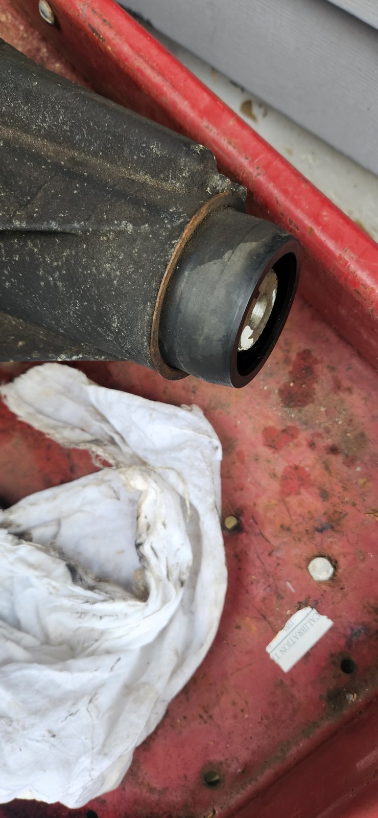

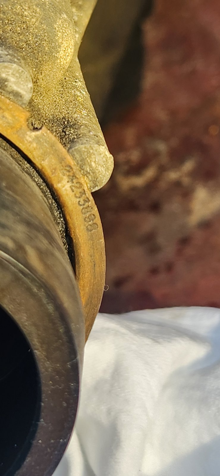

Anyone have the part # for the rear output transfer case seal? Having some trouble finding it and aftermarket is not working out.

Which transfer case do you have?
This tell you?

Looking on rockauto.com, there's like three or four possibilities. Borg Warner 4482 and the 4485 which is a one speed. You should be able to find that on the rear cover.
Then there's the M3023, two speed transfer case. One version is a manual shift, the other has a switch on the dash.
Take a photo of the RPO label, usually it is affixed in the glove box.

I tried to look it up just now but like you said, there's multiple choices...Its tough even with the rpo's!

Your transfer case RPO code is NP0
So it's a single speed....
Here it is on RockAuto. It's for both the two speed and single speed and the number matches

If you need it like today, you can take that part number into a Napa Auto parts and they can cross reference it to what they have in stock.

Here's another image of it. Note in the details it has your correct RPO code as well

I searched the part # I found on the seal in the case on Amazon and it stated I purchased it in 2021. Then I realized I replaced it when I did the u-joints back in 21! Lol. I'm gonna just keep it. I gotta do a better job of keeping track of what I've replaced on my trucks...Thank you both for the help!!
