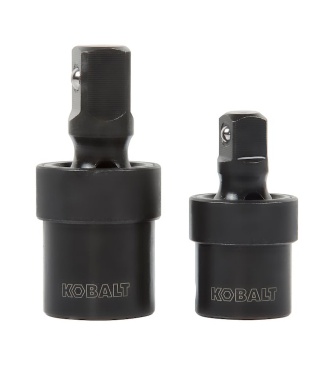

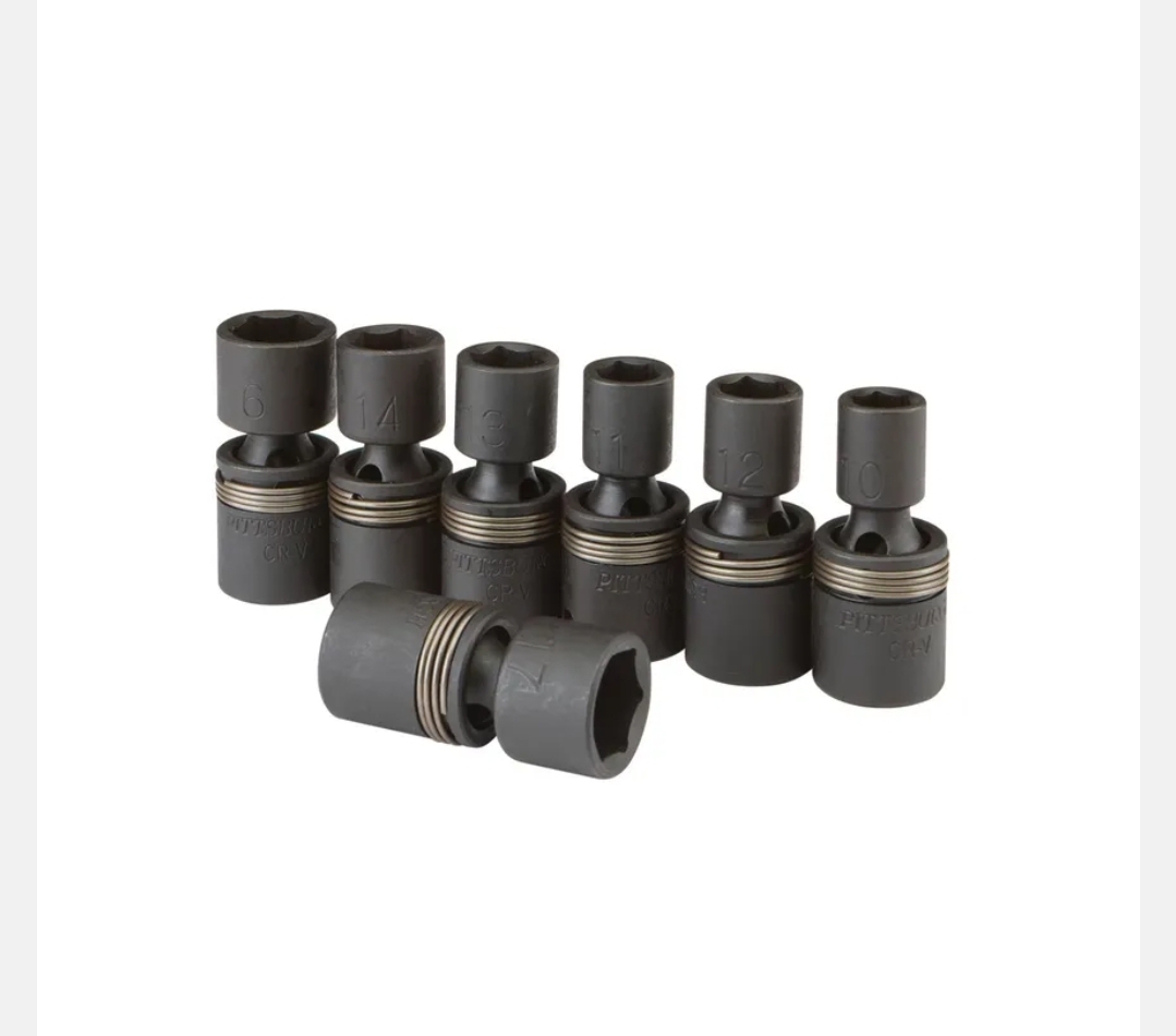

Currently stuck on removing the effing top bell housing bolt. I got the nut off that holds the wire loom on but the bolt is kicking my a**! I've tried swivels, extensions and tried to get a ratcheting wrench up on it. No luck. Any suggestions?

You can also lower the tail of the transmission a little, which gives you more working room.... But be careful about the intake hitting the firewall. I also use a long extension, I think it's a 24-inch, with the same style sockets as you pictured... Just deeper

those with these and good impact. the sell deep sockets like that too if needed

Yeah. I'm using these with a deep well socket, it's just a little too long and hitting a sheet metal seam. Trip to the tool store after work tomorrow.
