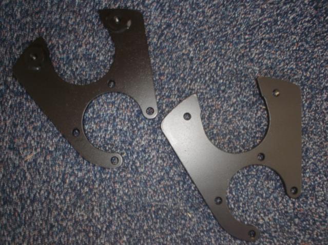

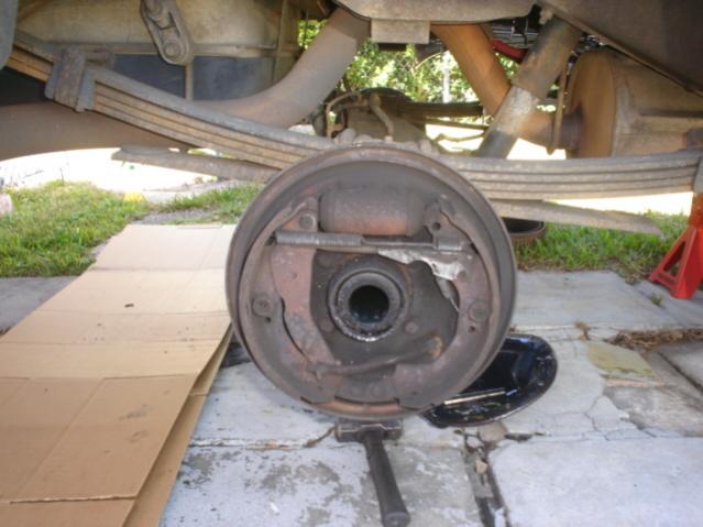

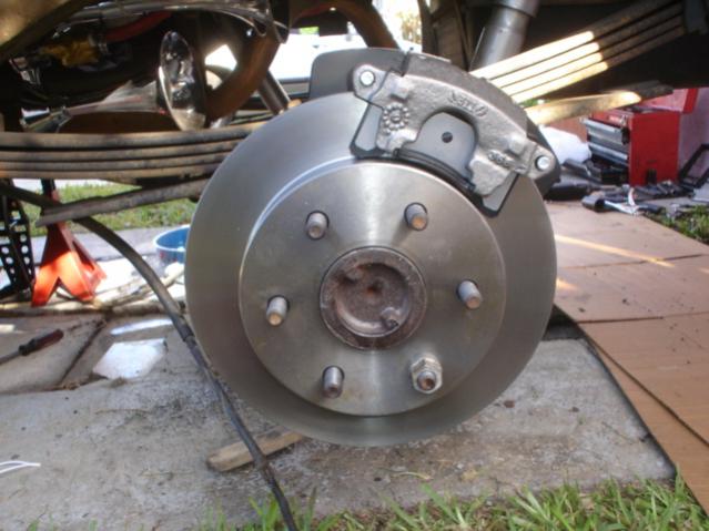

took me a hole day due to Other things I did to the truck..
Rear end Bearings
Seals
Shocks
Cleaned and Painted Complete Rear End
Chrome Diff Cover
Also being first time with the Swap had to Fab Up some Brake hoses for them.. Planning on ReDoing all the Lines in the Back with in the NExt few Weeks when I complete the front Big Brake Set up
Complete swap should not take no more than 2 hour at MAX.. Fairly SImple , not Major Mechanics skill needed(lol)..

I will have them up for sale shortly ... about $400 ....
details will be up shortly

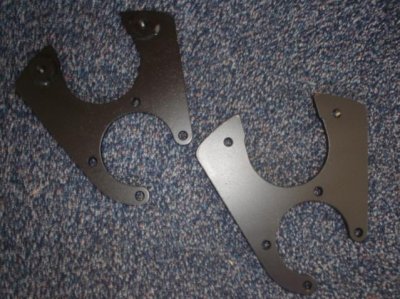

you're going to sell your kit already?
i see your horn in the second pic. lol.
305Tahoe
Jan 19, 2010
146
lol..not my kit..
Im gona have them for Sale...

NADA , NOTHING , ZIPPO>..
I tried using the El Do Crapo calipers, but I Rather not Have an E BRake thatn Have a set of Calipers that will LOCK UP at any time, or for that matter stop working..
TO me it wouldnt be an issue to swap them out , but to the Average persone It will be a Pain in the Rear , also I would loose my Rear Selling the Kits with those Calipers as the amount of WARRANTY Returns I would have to do ...

I took some pics , debating wether or not to do I write up on it , as I dont know if People would really put it to use...

LoL I don't bro, don't think I'd consider anybody who will do this swap an average person.
I wonder what effin calipers SSBC uses for their conversion kits.
Oh, what about the whole drum size issue? You did it on 11" drums, should work for 10" also?

Yeah , its NOT HARD at all .But I def see where you average joe would be intimidated by Removing axles and what not!~!!!!!!!
YEah dont see why it shouldnt work ...

hey guys quick update..
drove it approxx 200 miles today..Wow
good amount of diff.. I always had the issue that I had to brake(predict) a little earlier as my truck took some distance to stop...I can Honestly say that I no longer have need for this..
Sooo I got in my buddies 2 door 97 .. YUP deff a Diff , I would say an all around 60% diff.... I even had him drive it and he noticed......

Update.. HAD to slam on my Brakes twice this evening ... NO LOCK UP ...!!!YAY!!!!!
I was a bit concerned as how I did not change the prop valve.......
Abs WORKED perfect to the T//////

That was my concern, the proportioning valve. I have heard mixed emotions about this mod for that matter alone. I would love to do this although I dont need it for inspectons like fyremanpat says its nice to have. I happen to use mine whenever I park on an incline, dont like the truck to roll back on the tranny when putting in park or in drive.
