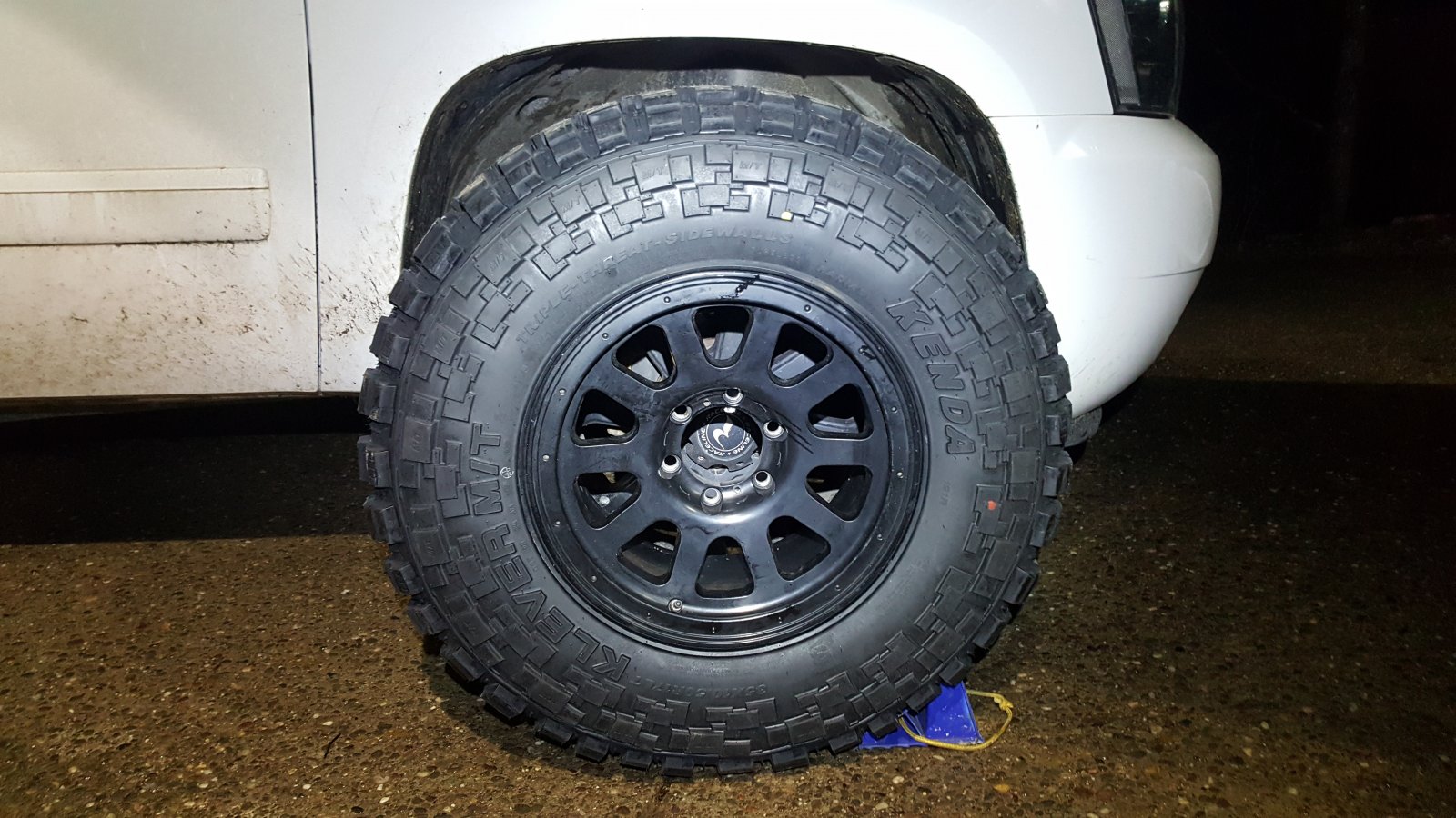

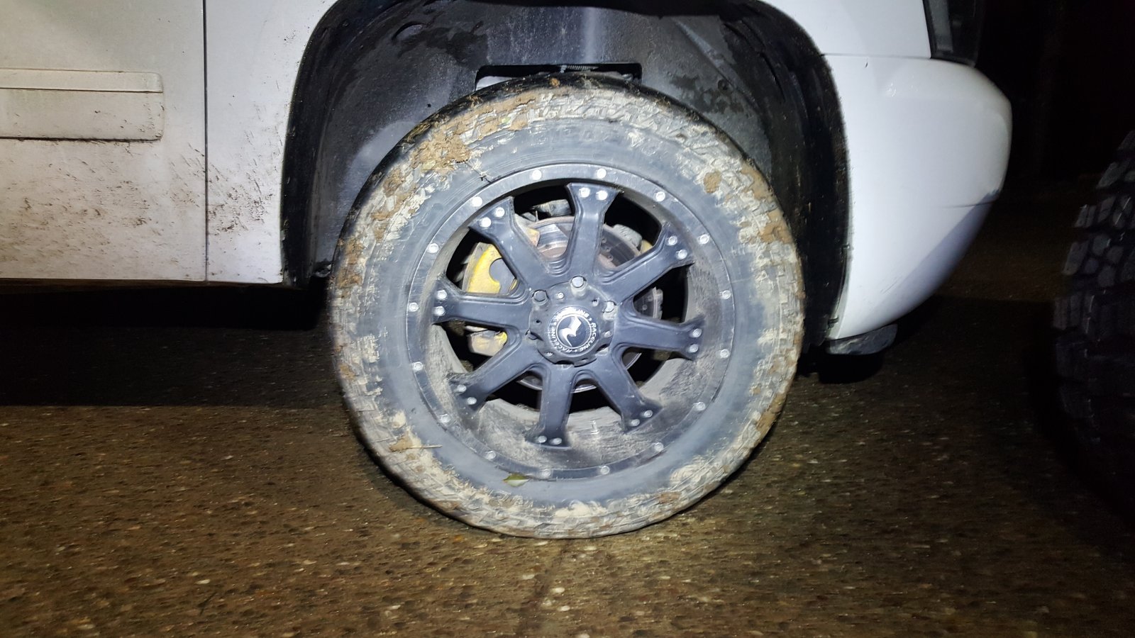

Thanks Pete, as this most definitely qualifies as bang for the buck! But I just went from a 20" +18, to a 17" +18 wheel for better Off-Road performance :-/
I will most definitely make certain there's no way to pull this off? But at a glance, it doesn't look do-able?
It's never easy to have your cake and eat it too lol
If this is not an option, is there another bolt on solution out there that you know of?
[I promise Im not being lazy, there are a few subjects on here that now have so much info that it becomes a matter of having the time to read through all the posts to be able to get the pertinent facts (which is not a bad thing, except for the amount of time it takes). Right now in my life Ive only got a few minutes a day free to do things like this and Im doing my best to spread them around the activities Im involved in lol]
And if that solution is ordering 4 or 6 piston calipers and fabricating my own brackets?? Then thats what it is.... My goal here, as with all my modifications, is to increase the performance, but do so on a moderate budget. Similar to the long travel control arms, I don't believe in paying someone for something I can do myself....

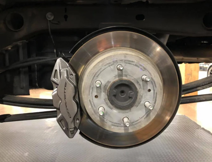

Do the GMT900 1500 SUVs not come with rear 2 piston calipers? I assumed they did?
I did the 2019+ 4 piston calipers on my 99 Silverado recently. I'm running some 2014-ish Tahoe 18" wheels. I had to do some grinding on the calipers because they were hitting the inside of the rim. I've put about 1,000 miles and it's working fine. The upgrade is pretty worth it. 6 piston calipers was another option but kinda spendy.
My buddy told me you can put some stock Corvette rear (4 piston?) calipers/rotors on our 10 bolts, with some custom brackets they make. Our 99-04 Silverados come with rear disc, single piston calipers, so I imagine it will be a huge improvement. I assume the Corvette upgrade likely also works on the GMT900 SUVs?
A rear axle swap from the k2xx is yet another option. I have one of those axles I want to swap in my truck. The brakes are single piston calipers, but larger rotors. Bonus is larger axle. Or larger brakes, however you look at it.
I really like how GM has designed these brake systems where there's so many options for interchangeability. It's kinda crazy. High performance brake upgrades using factory parts. I'll take it! :)
My 2011 GMT-900 (Avalanche LTZ) came *single piston rears...
That is exactl what i was wanting to do, but when I got involved with this non-profit and the extreme off-road capability needed to help how I wanted to be abe to help, I took off my 20" Raceline's and put on some 17" Methods.... From what I've been able to discern to this point, there are no cost effecive upgrades that will work with 17's??
Do you know if the Vette upgrade is possible with 17's??
