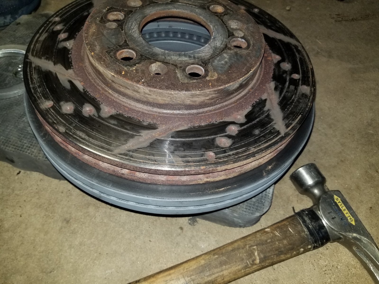

Recently came across a pair of 4 piston caliper + pads + rotors + dust shields off a 2026 Escalade for $225. Was told they were driven during test drives and from dealership to afermarket shop, which was pretty obvi in photos. I double checked for fitment? Consensus was they fit with an approx 0.125" hardened spacer between caliper and bracket (moving caliper 0.125" outward).
They were a couple hours away but in a town where a longtime friend lives, and he comes here to work 1-3x every week. Called him up and he was coming next day. Had them in my hands in less than 24hrs lol.
Didn't attempt to install them until this morning...
I'll post pics immediately after posting this... Theyre on my phone and I dont have cord to move them over here w/me...

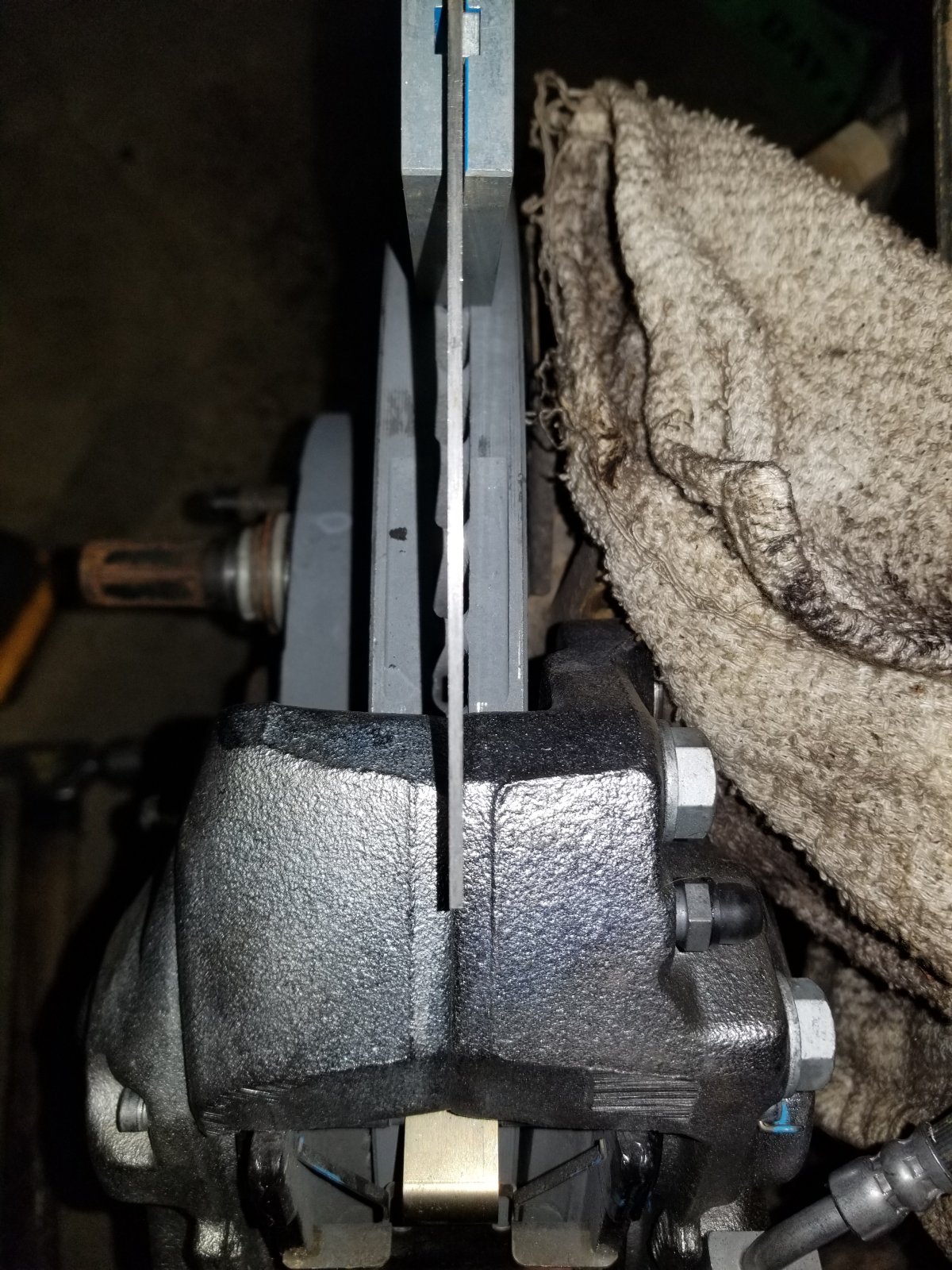

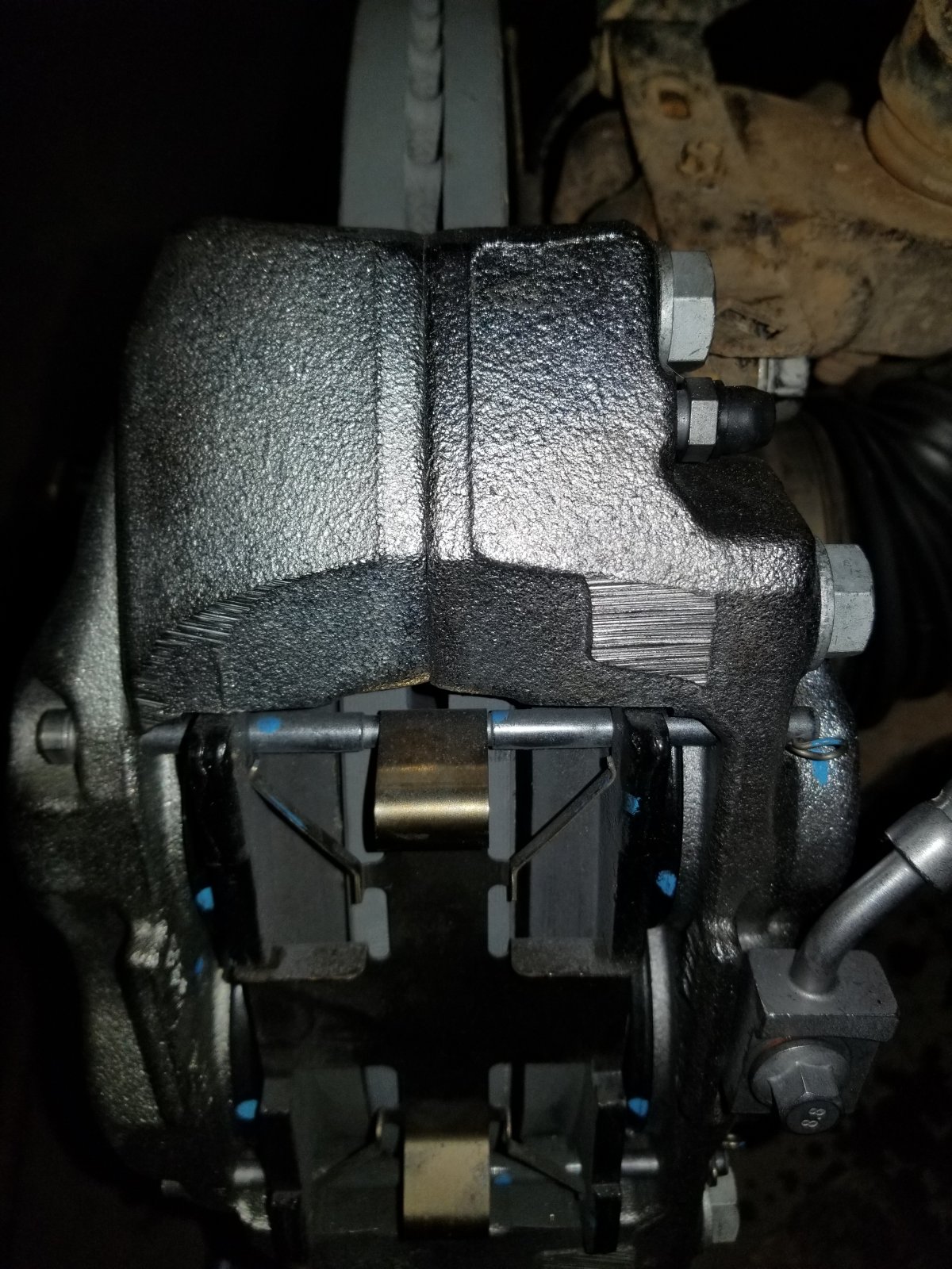

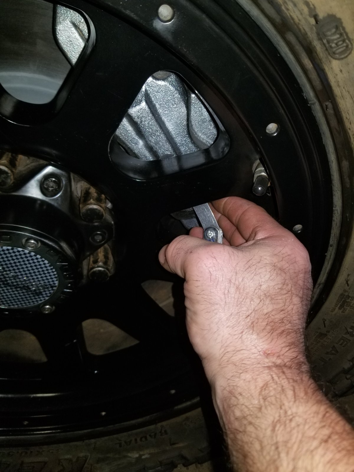

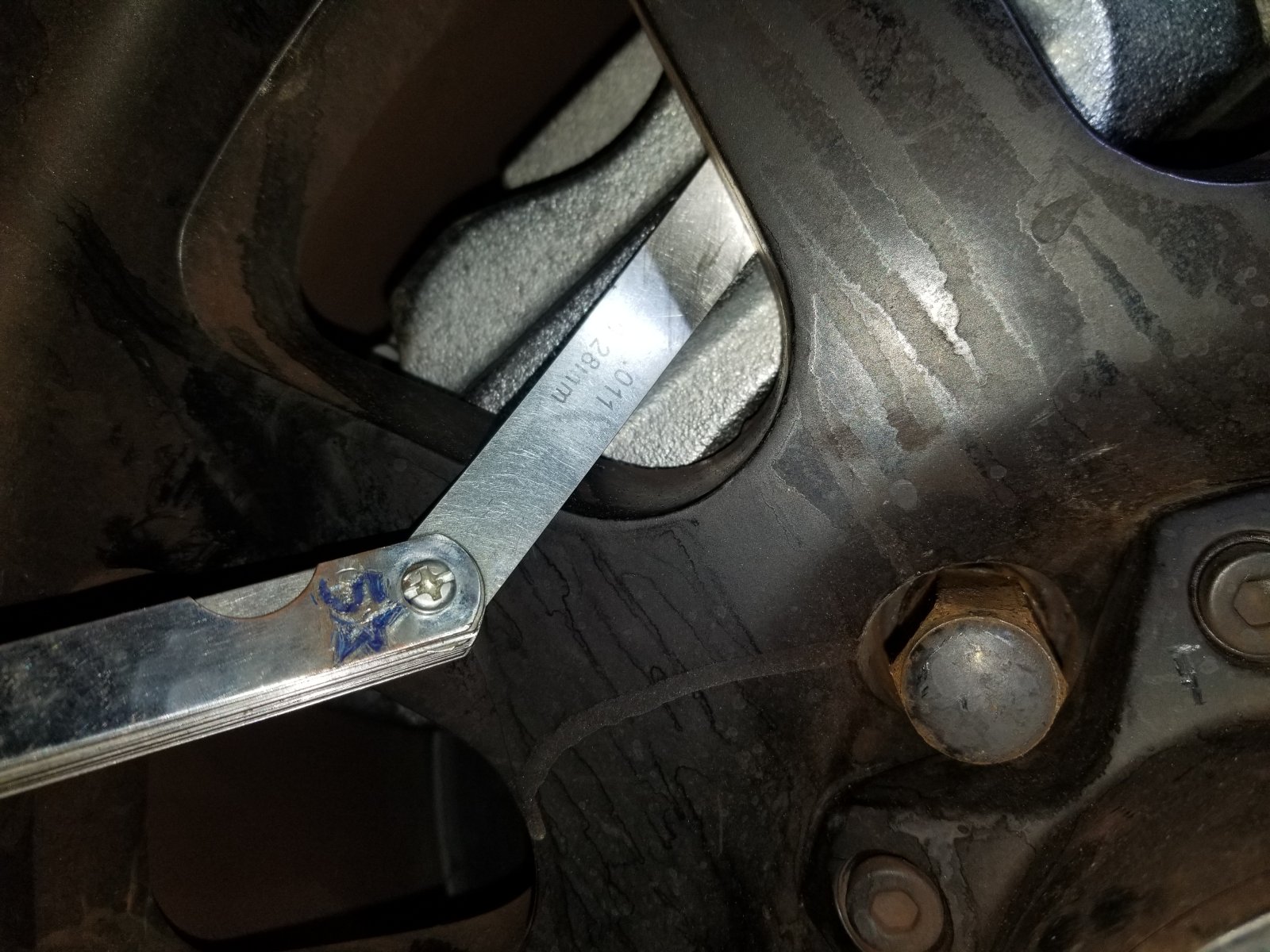

As you'll see in pics: They fit! Barely! ...and I mean BARELY!
0.105" clearance from back spokes lol... I'm running a 17 x 9 +18 with a very mild curve or dish shape in the spokes. ZERO chance they fit w/o that subtle curvature to the spokes. 0.105" is 1/4th of 1mm

>>(Technical) Functional Fitment for the newer GM 4 piston brake upgrade onto a GMT900 is a combination of three distances and one wheel design feature....and it's not very easy to explain.....and even harder to comprehend if you dont have some decent knowledge/experience with these systems...
Those are: wheel offset, caliper spacer size, wheel width, and spoke shape. Rotor hat height is another distance that plays a role, but its role is only in the measurng of your current setup, just to see if your wheels are compatible.....but this post is long enough already so:
In short: the most common point of contact is casued by the 4" x 0.5" raised rectangular bump out on the outside face of the calipers. It makes contact with the backside of the wheel spokes.
If you're considering this brake upgrade? Before you do anything, put a tape measure through your spokes onto the face of the rotor and see if you have 2.5" or more available from the face of your rotor to the back of your spokes? Make sure to take note if you have a different measurement closer to center than out towards the tire? because that plays a role too...

Driver side was 0.16"... Which looks like a canyon after ripping business cards (before getting out gauge) in the 0.105 gap... (and no make fun of my brake dust covered wheel or failing rust protection on frame, I'm already self conscious enough about them lol)

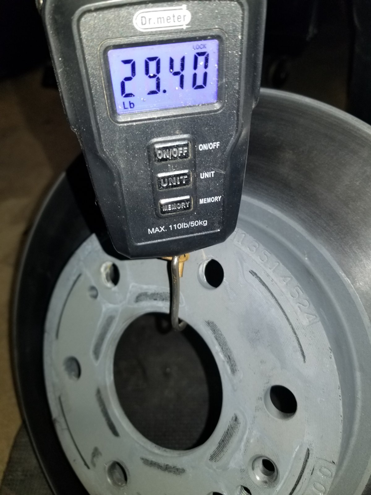

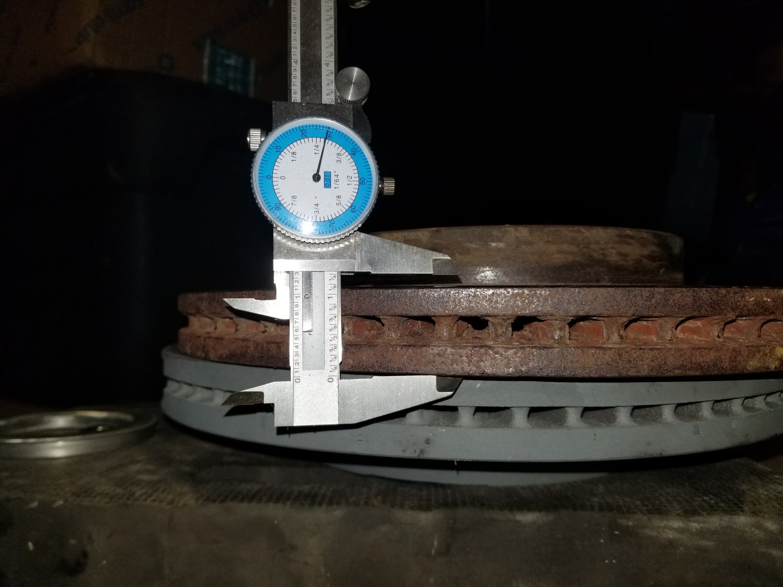

Comparison of the OE sized PowerStop rotors (once turned) vs 2026 rotors
Approx:
0.08" thicker (2.03mm)
6lbs heavier
16mm larger diameter
Hard to show they're centered on rotor w/pics

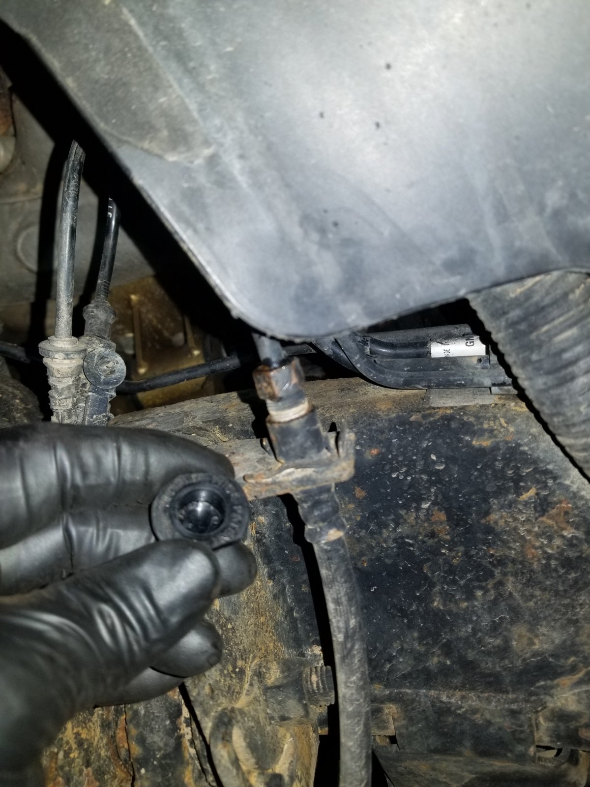

Was concerned about fluid loss. It was extremely minimal and mitigated on driver side with this little cap...
Very simple install...
Notes: When pressing new line up through bracket to attach to hard line you must clock it correctly. Rotate until little flanges align with grooves in bracket. You'll feel/see it seat, upwards, into the correct position. Must do this so retainer clip can do its job...
Used 12mm, 10.9 hardness rated washers by Everbilt as the spacers. They were approx .011". Interweb said spacer should be 0.125" but mine was immeasurably close to dead center w/0.11".
Bought at Home Depot out of the specialty drawer in hardware isle. Pack of 5 was _____(not much? less than $5? maybe? honestly didnt look at receipt)
I had to bore/rheem out center hole about a 1/16th for the 2026 bolts, which I forgot to mention came with the other parts...
Even w/ drill press this took longer than the install per side! (10.9's are harder steel)
***AVOID this by using 14mm 10.9's or 5/8" grade 8

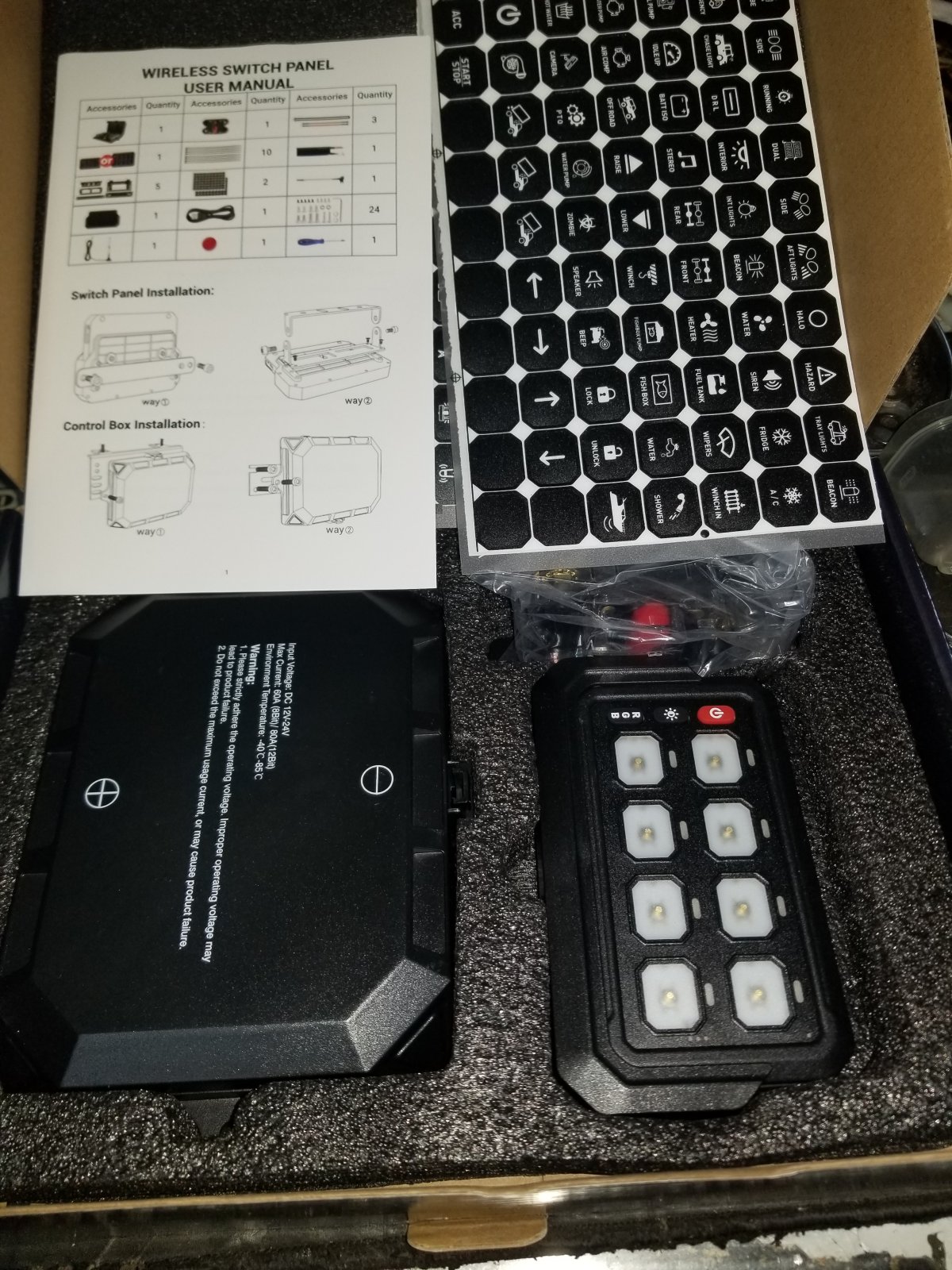

Will update performance after I get this wireless switch panel installed..
