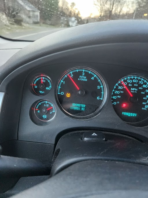

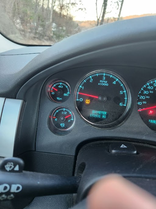

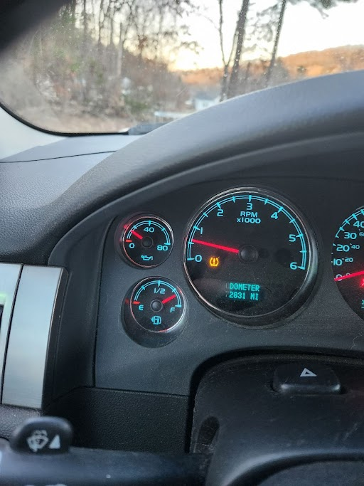

Thanks guys. I feel better. My eninge is a 5.3 non vvt. Cam was a non dod/afm cam that can be used eith both vvt and non vvt. I'll send it I guess. Worst case scenario, I get a new short block lol. I have 172,*** miles.

no reason why pressure shouldve gone down.
i would start with the sensor, maybe throw the old one back in or mech gauge and see.
i wouldve plugged the towers, 10 bux worth of plugs for the piece of mind.
did you pull the oil pump to change the timing chain or anything?
the cam being for vvt or not i've never heard of unless you just mean youd need to install the lock out block in the actuator, did you use a single bolt cam gear? 3 bolt? actuator with the block? im wondering if it has the oil passage for the vvt actuator that would need to be "plugged" if not used? the path for oil to the actuator is a groove in the forward most race of the cam iirc
the pressure relief in the pan, unless engine was very sludged up i wouldnt worry about it being stuck open

The cam I got said it could be used with or without vvt. I do not have vvt in my truck. I did change the timing gear and tensioner. It was a single bolt cam. I will still probably plug the holes in the near future. It's not too hard to get to.

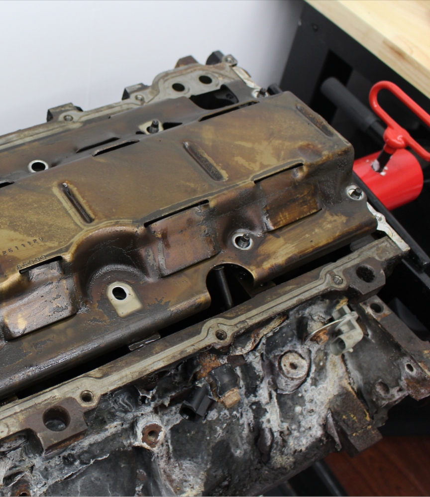

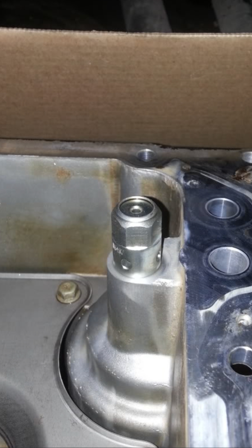

the windage tray has a nice cut out right at the bypass valve.
to be fair, I alway thought the bypass valve sprayed oil straight up out of the hole on the top on the back cyl wall. but this Pic it looks like there's some holes around the bottom. so I don't know for sure. so eh? my truck has a crazy high oil pressure variable displacement pump. like 60 plus almost all the time. so I have a feeling it's bypassing constantly, especially with afm turned off. no sign of choked up rings or low compression to me.
