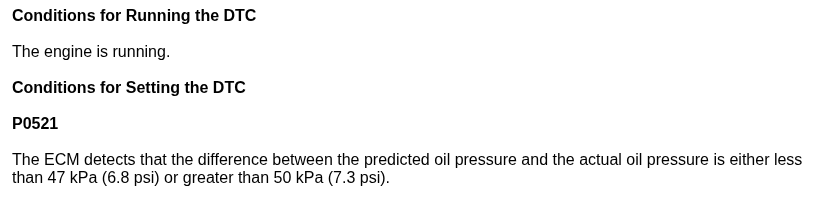

Since that code is described as a situation of being either above or below a predicted oil psi, and your pump change has resulted in significantly higher oil psi; it sounds like the system is working as designed
The PCM doesn't know you changed the pump and/or blocked the bypass (common in deletes to prevent spraying oil under the pistons) so it's seeing the higher oil psi as a potential problem
I don't change the pump or modify the bypass when I delete AFM so I haven't run into this but if the table can't be modified to match your new oil pressure range then you can just mark that code as "unavailable" or "do not report" in the softwsre
I don't think you have a problem with any components, just a software parameter that doesn't match your hardware change quite right
