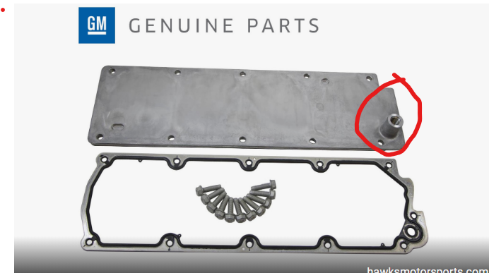

What pump did you put in it? The stock pump for the AFM engines is a high volume pump. I used a Melling M295HV for mine. Since I capped off everything AFM-related, essentially making it like a Gen3 engine, a standard volume/standard pressure pump would've been fine. But I wanted more volume since it had 200K and I was gonna run it hard. Still, I don't see a standard volume pump causing that much of a loss in oil pressure. You might wanna try a non-AFM valley cover, GM #12598832.
I reused the factory oil pump. I have the non afm valley cover. It came with my AMS racing kit.
I assumed you reused the VLOM cuz you said you replaced the screen when you replaced the sensor. I never knew you could use the screen in the non-AFM valley cover. It wouldn't go in on mine and I used a stock valley cover just like what looks to be in that AMS kit. My thoughts are that either the sensor isn't accurately reading the pressure or the gauge isn't responding accurately or you have an internal leak. Did you replace the pickup tube O-ring?
I put the oil pressure sensor with the screen in the back of the non DoD valley cover. It's a new sensor and a new screen. I was told I'd hear lifter tick if it was actually low but I do not hear that. Also, I know I am burning 0 oil because there is no smoke, and yes, I replaced the 0 ring with the orange one. I'll also add, that it's only when it's at operating Temps. It's fine until it warms up.

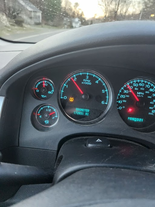

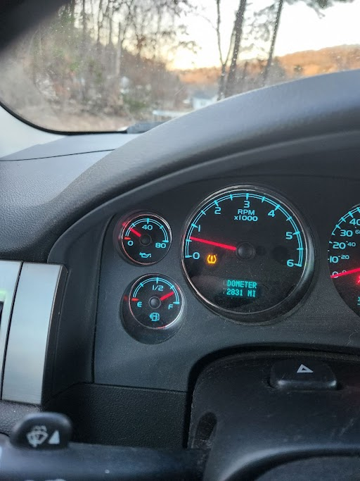

In the oil pan I believe. And that isn't worrisome? Because it sure worries the hell out of me
Doesn't look worrisome to me.
The oil pressures in the pics are exactly what the my 07 6.2 has for pressures. I changed the oil pump pickup tube o-ring 5+ yrs and 63k miles ago at 130k.
