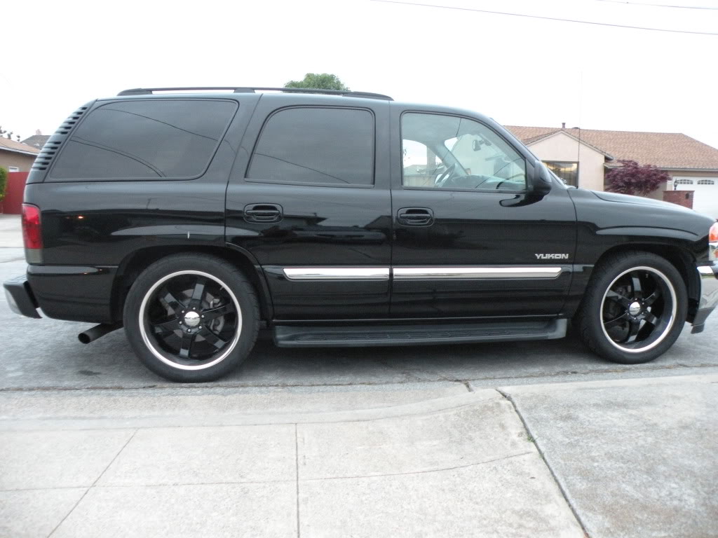

here is a customers 3/5 with 305 40 22 I set up. He had the mcgaughy springs in before and then switched to my tb coils and ride is better and sat lower.

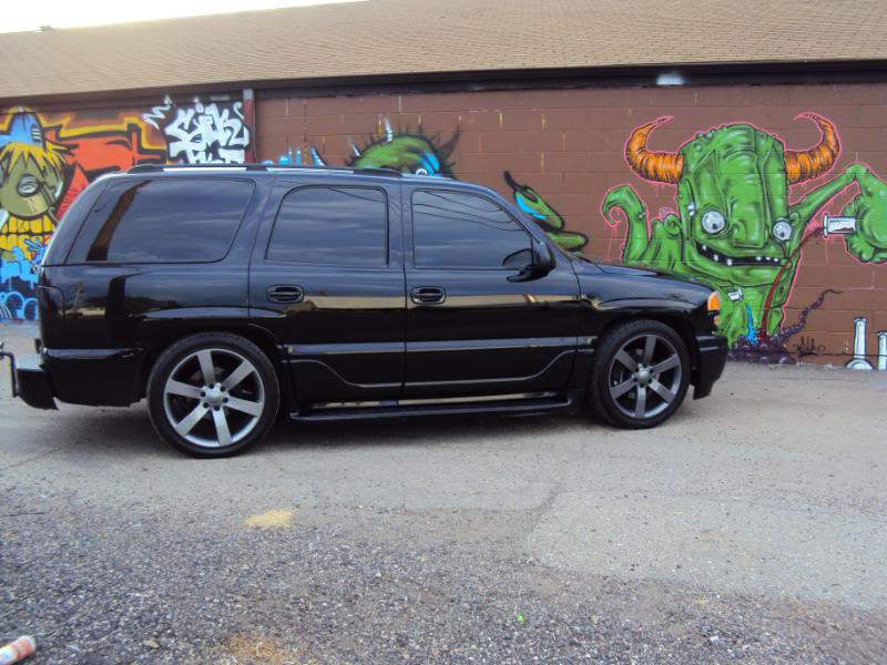

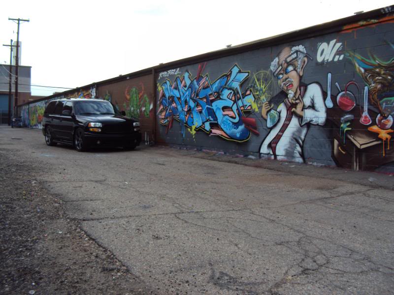

4/6 on tbss 2s with 285/40/22 nittos:
Rides nice and I can adjust the rear up an inch with the helper bags, critical if you plan to tow anything. I'll probably be swapping my drop keys out for djm upper and lower arms and some QA1 or Fox shocks, otherwise the truck is a hood and esky rack away from being done far as the exterior is concerned. Hope that helps :cheers:

Sexy as hell man, I love your Denali :Handshake: Makes me want to do a 4-6" drop, but I think a 3-5" will be more user friendly. And I plan to tow eventually unless I get rid of a couple vehicles and get a 2500. Helper bags are in my future :)
Norcal SS do you have a setup for a 5.5" rear drop? I would hate to get your setup and cut the springs but it seems like the 5" drop springs sit a touch high for my liking. A half inch more I think would be perfect, but I understand every vehicle is different.
