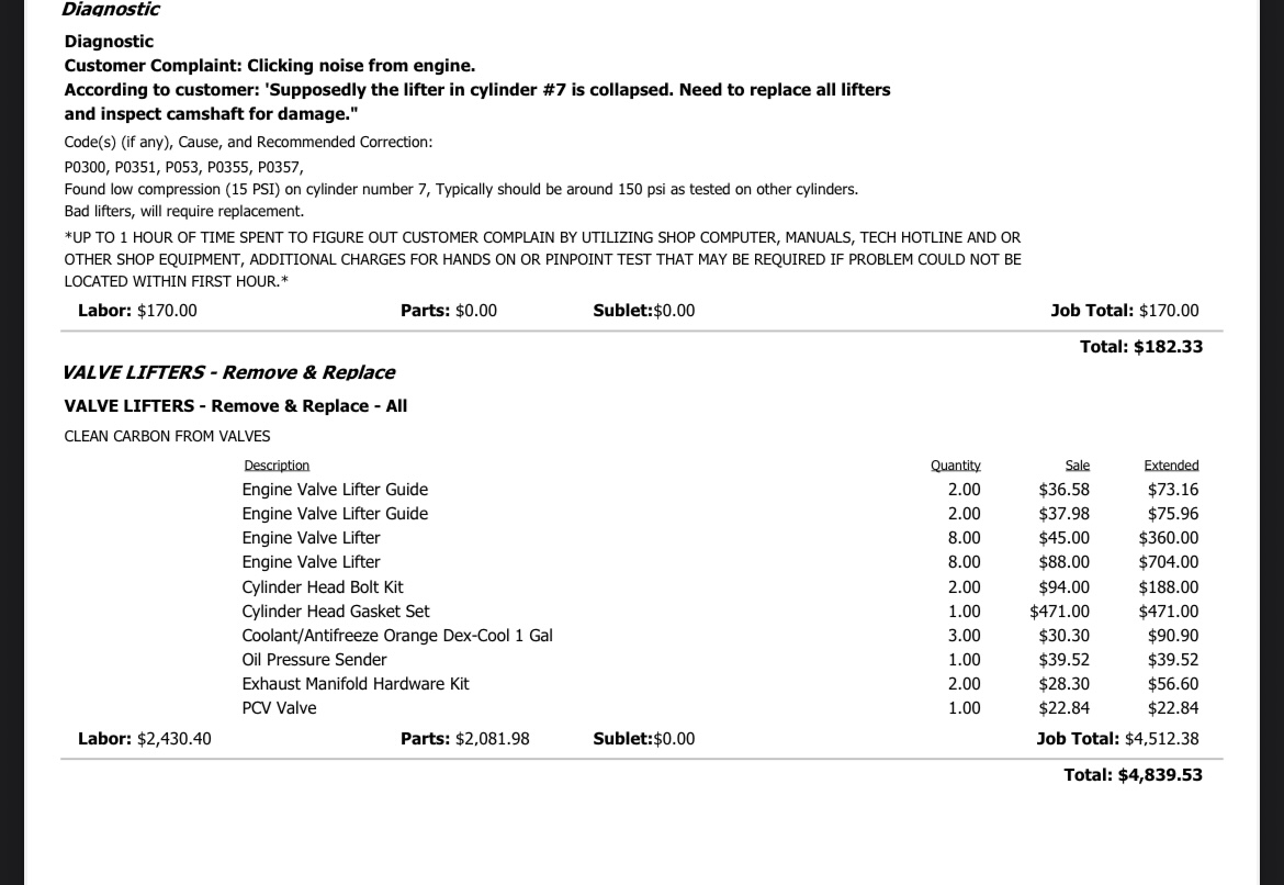

I wish you'd have seen this sooner as well . Great info and I really appreciate the responses from everyone. Got the Tahoe back from the engine shop with a ~$5k OTD bill.
Wifey is angling for a new ride after the rentals during this fiasco spoiled her, but we'll probably hang onto the Tahoe for a while.
Thanks everyone!
