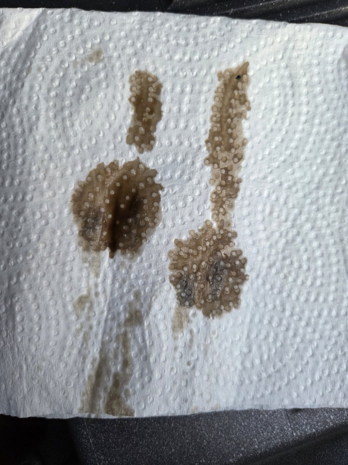

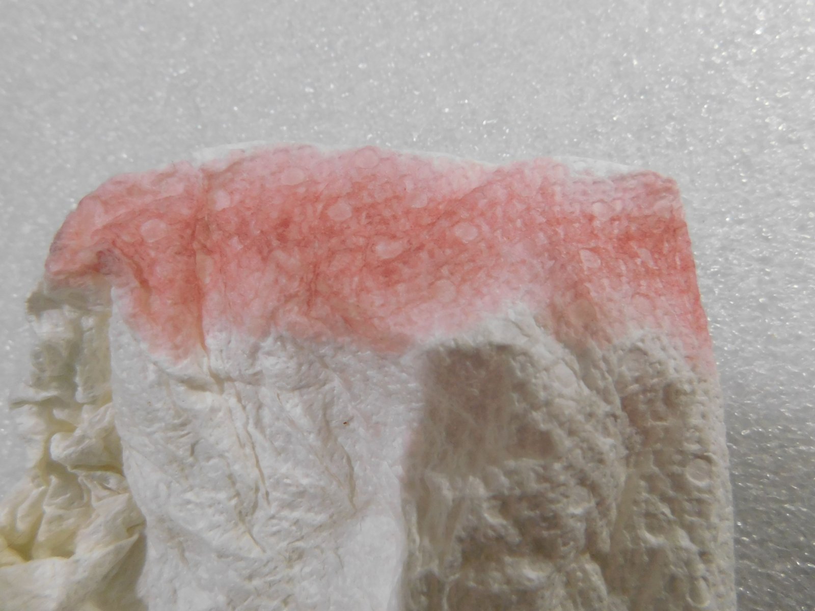

get a clean white paper towel, pull the transmission dipstick out and wipe some of the fluid on the white towel and post a picture of it on here.
Doing that will provide a little more insight into the condition of your transmission.
for reference this is fresh fluid from a healthy transmission
