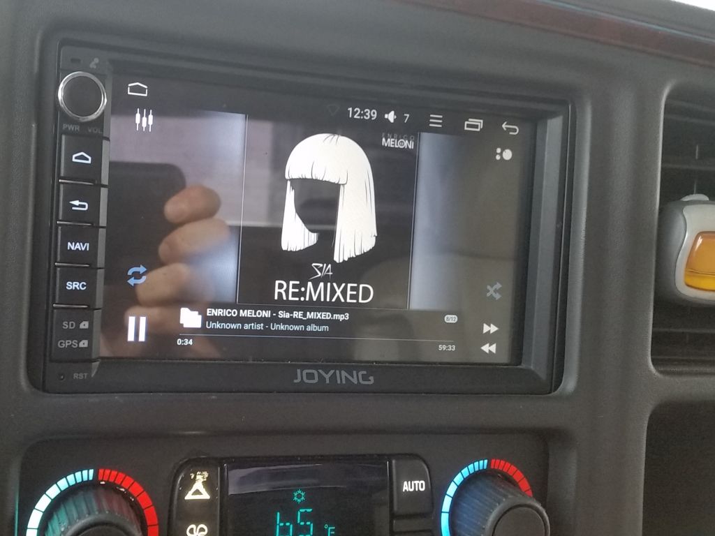

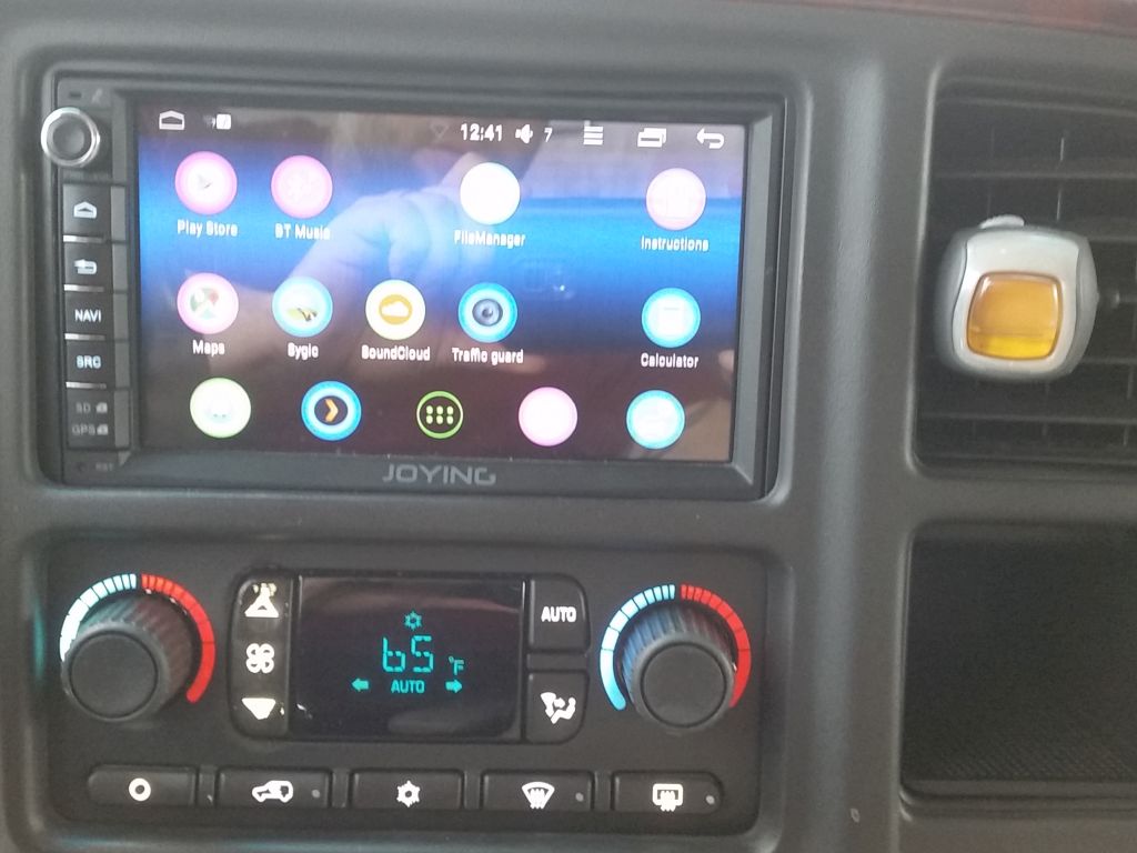

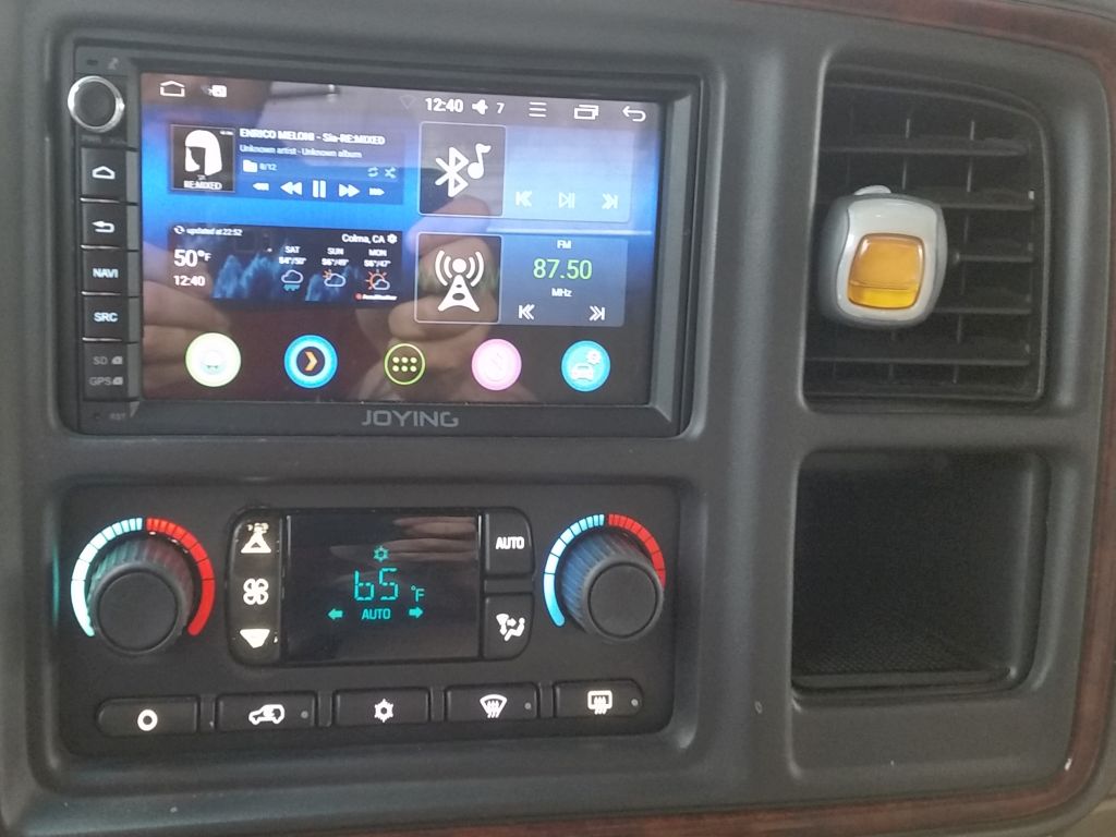

Head unit: Joying JY-UM135N2, later upgraded (manufacturer offered upgrade in a form of a new core board, I didn't have to replace the whole unit). Specs: Android 8.0 Oreo, 4GB RAM+32GB ROM, 128Gb SD card (bought separately for music and maps), Bluetooth, rear view camera. It a royal PITA to install a camera in the tailgate of EXT, since it's made of fiberglass and glued together with a double sided scotch tape. But I did it, and also when I was there, I installed a lock actuator, so now the tailgate closes with the remote like all other doors.

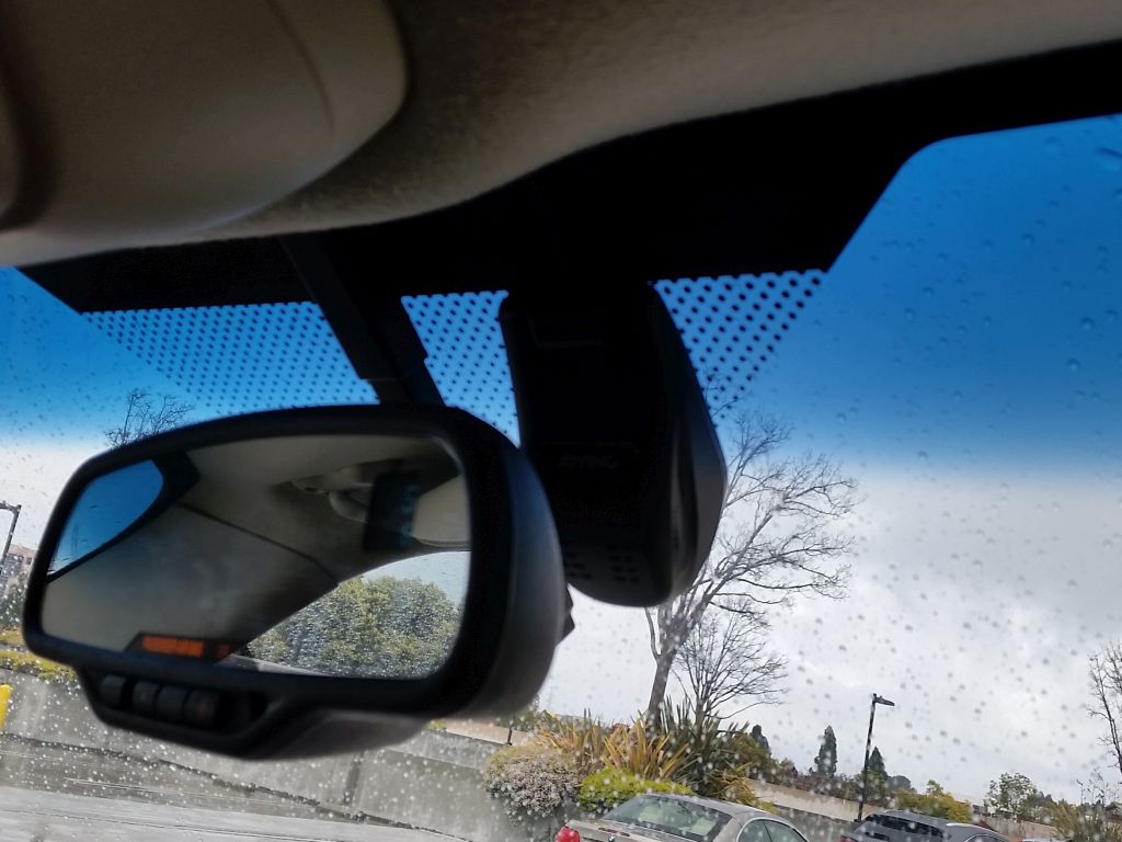

It runs Android, so basically the entire Google Play is available. I installed Waze, Torque Pro, Maps, Poweramp and a bunch of other useful apps. I also bought a Dash cam, so now I record everything. It looks neat and factory.
Amplifier: https://www.clarion.com/us/en/products-personal/marine/XC2510/index.html
All speakers are factory so far, I am waiting for them to die, so I would have a justification for a set of a new speakers.
A sub is factory as well.
View attachment 218086 View attachment 218087 View attachment 218088 View attachment 218089 View attachment 218091

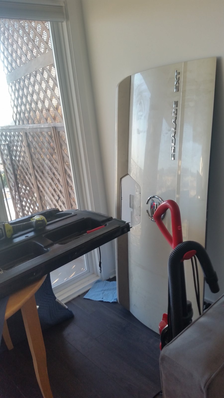

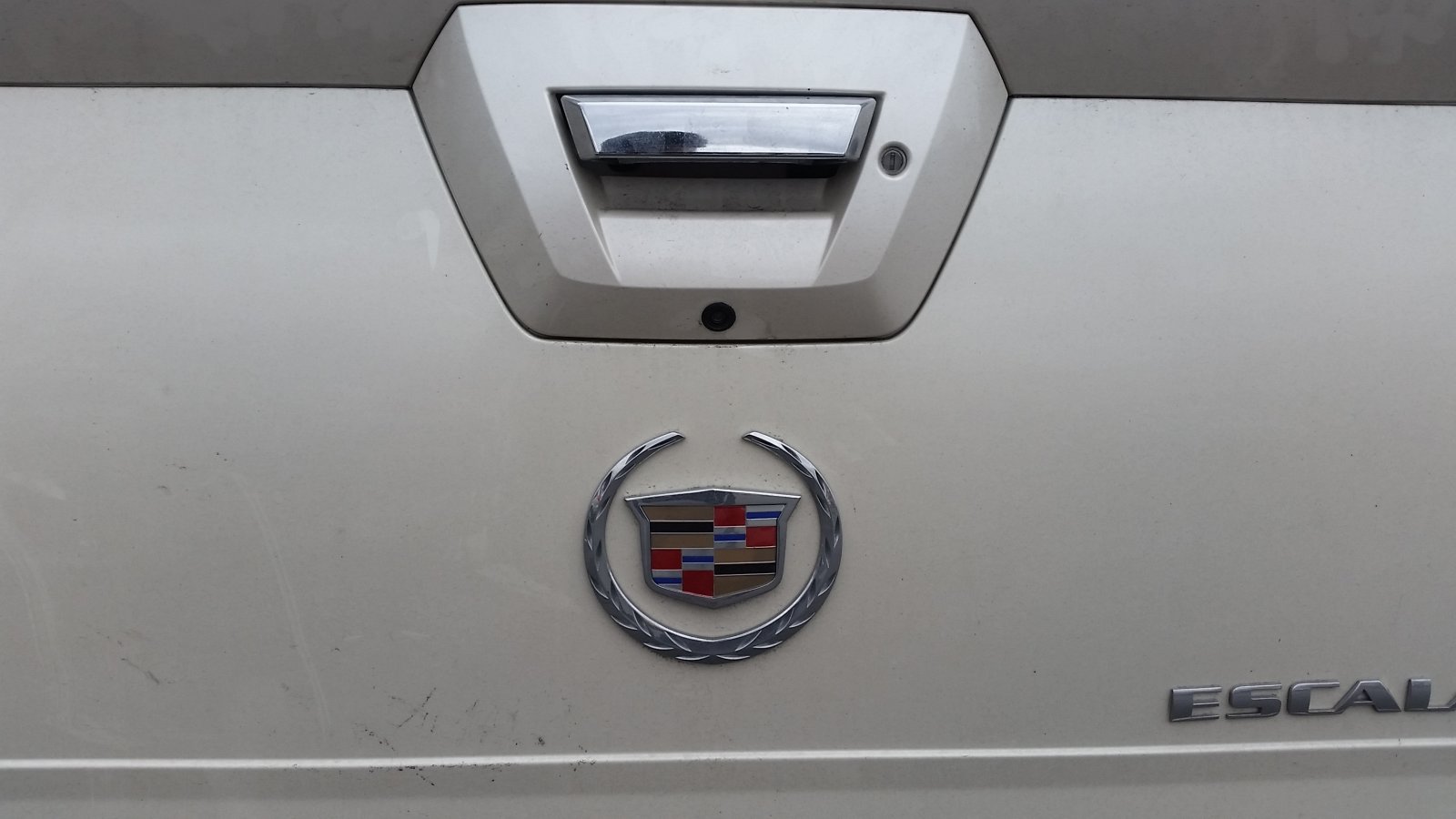

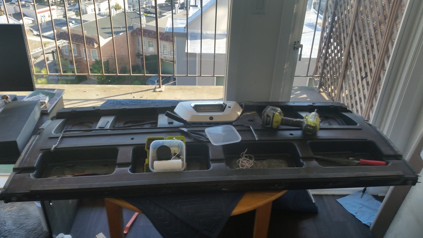

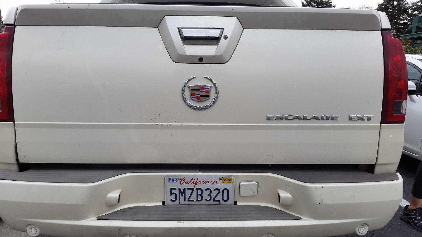

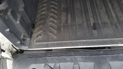

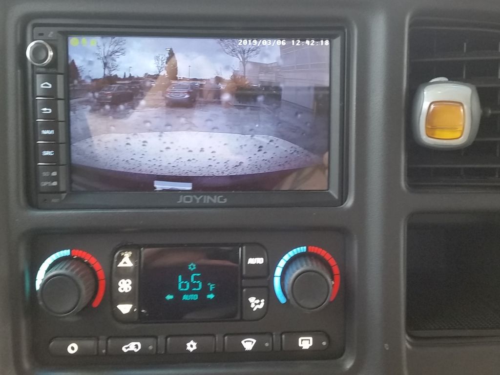

I installed a rear view camera in the tailgate. That was a PITA!!!
Some engineer (if that's the right word) at GM decided to make tailgate out of fiberglass. To put the parts of the tailgate together they used double sided sticky tape. To add insult to injury, GM didn't put a lock actuator inside, so the tailgate can only be opened and closed with a key. And it's very heavy, but no torsion installed.
To be fare, in 2007 GM did their homework and the new Avalanche/Escalade EXT had a regular metal tailgate with a power lock, torsion bar and a rear view camera. But for 2002-2006 the owners have to do it themselves.
To take tailgate apart, you need to cut the above mentioned sticky tape. I used just a regular kitchen knife. All the rest is very easy.
So, I installed the camera, a tailgate lock actuator and a torsion bar.
Pix speak louder then words:
20180205_081705.jpg 20180205_081713.jpg 20190307_145430.jpg 20190307_145435.jpg 20190307_145443.jpg

Did you have to run a wire from the tailgate somewhere up in to the truck to get it connected to the headunit?! I’ve always been curious about that.

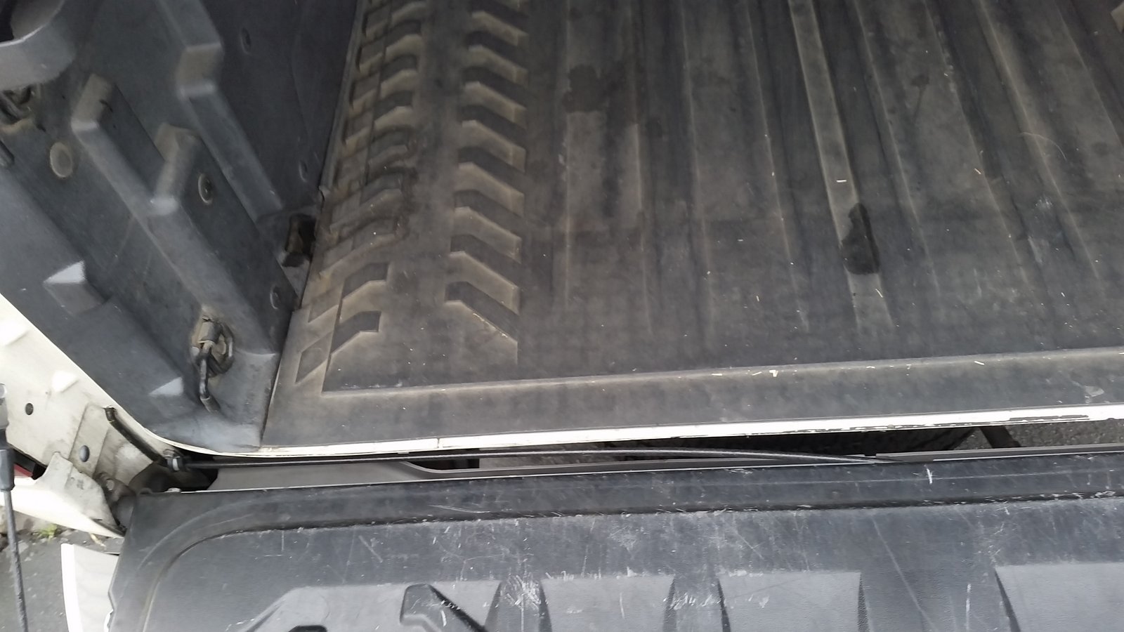

I took out a right bed panel (a major PITA!!!) and ran the wires their, then connected power lock wires to door lock wires, so it opens and closes with the other doors. And the camera cable runs all the way to the dashboard.
I didn't want to run wires on the outside, as it would be subjected to elements and I am not sure that a video cable is rated for that.
