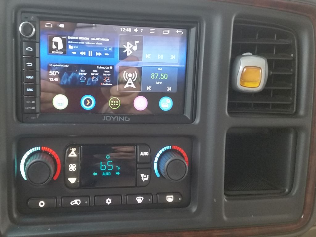

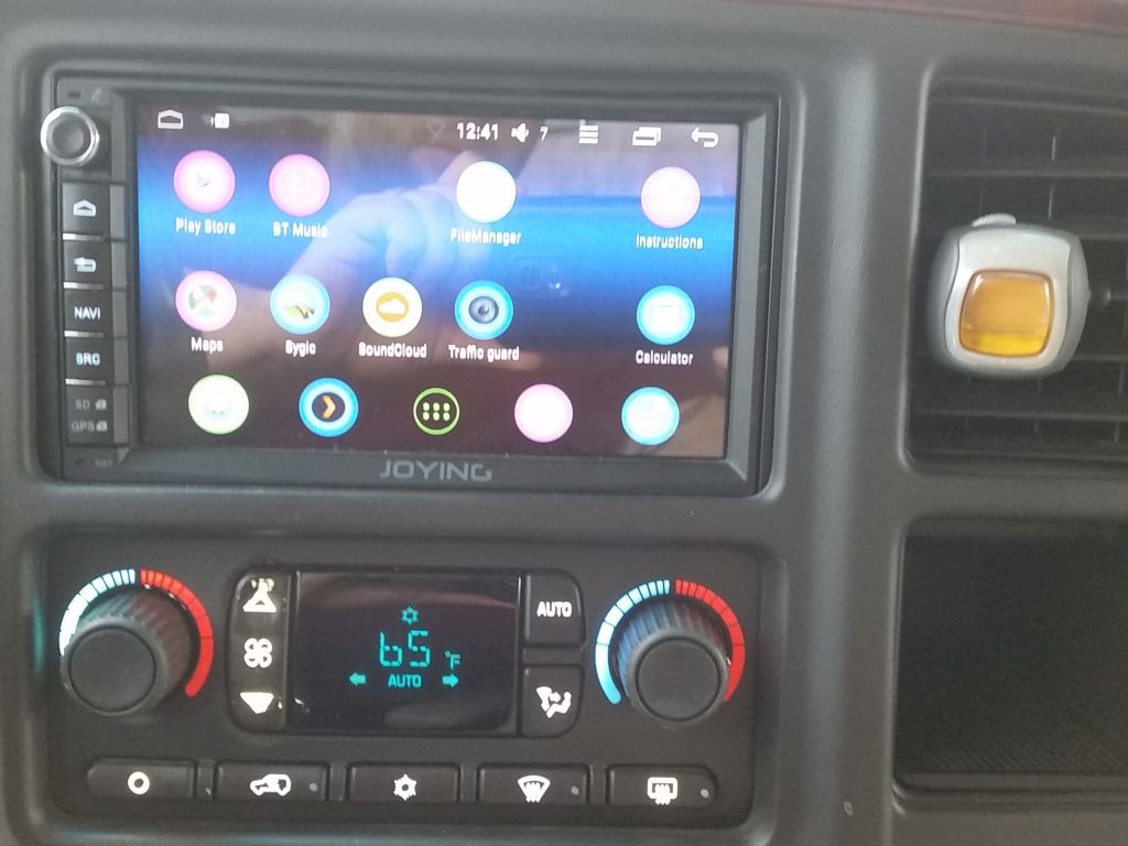

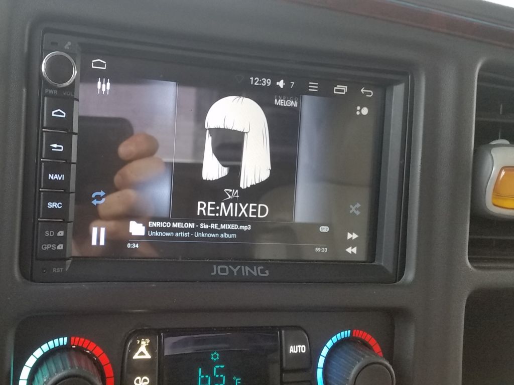

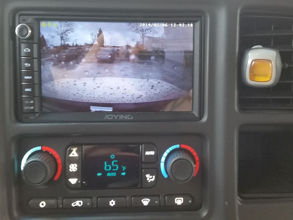

Audio
Head unit: Joying JY-UM135N2, later upgraded (manufacturer offered upgrade in a form of a new core board, I didn't have to replace the whole unit). Specs: Android 8.0 Oreo, 4GB RAM+32GB ROM, 128Gb SD card (bought separately for music and maps), Bluetooth, rear view camera. It a royal PITA to install a camera in the tailgate of EXT, since it's made of fiberglass and glued together with a double sided scotch tape. But I did it, and also when I was there, I installed a lock actuator, so now the tailgate closes with the remote like all other doors.

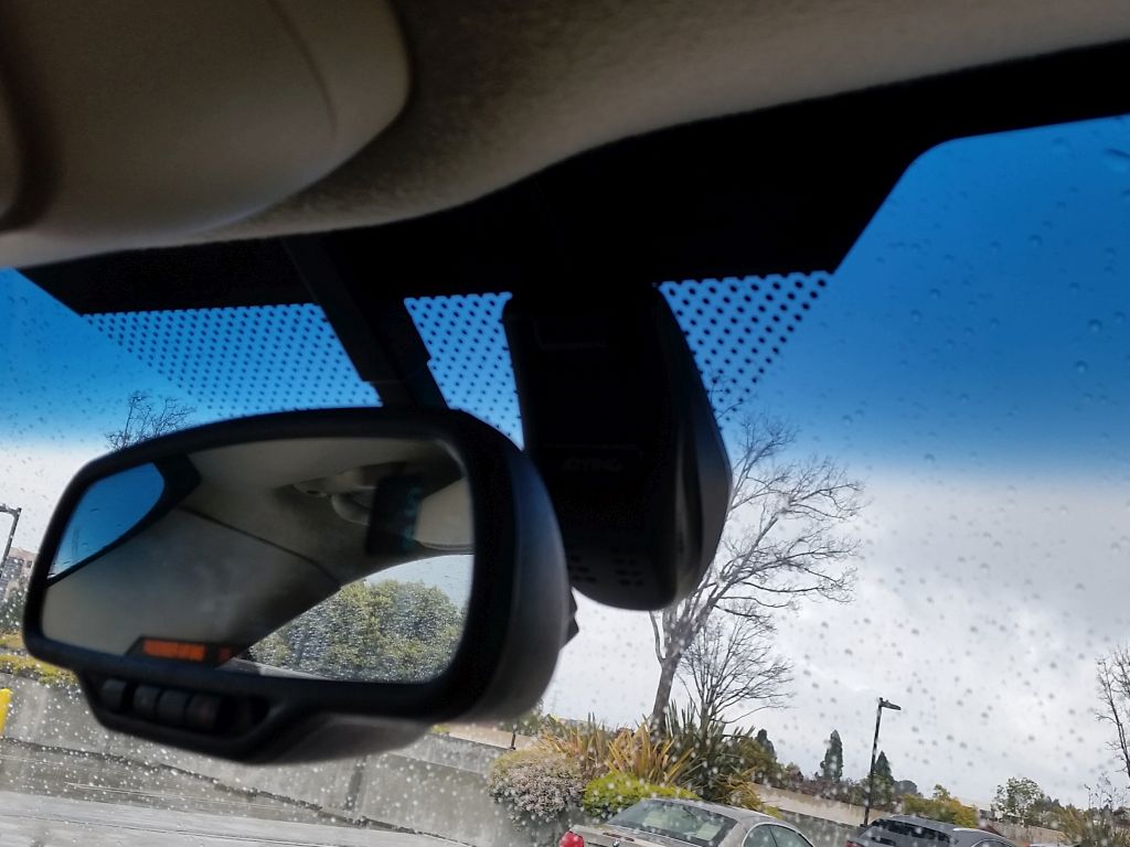

It runs Android, so basically the entire Google Play is available. I installed Waze, Torque Pro, Maps, Poweramp and a bunch of other useful apps. I also bought a Dash cam, so now I record everything. It looks neat and factory.
