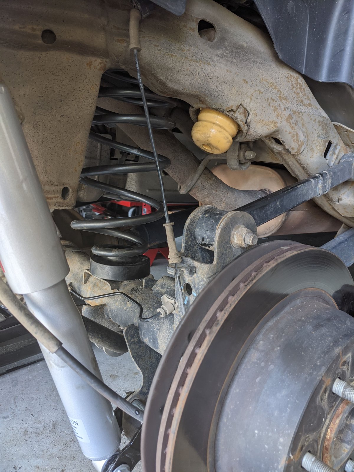

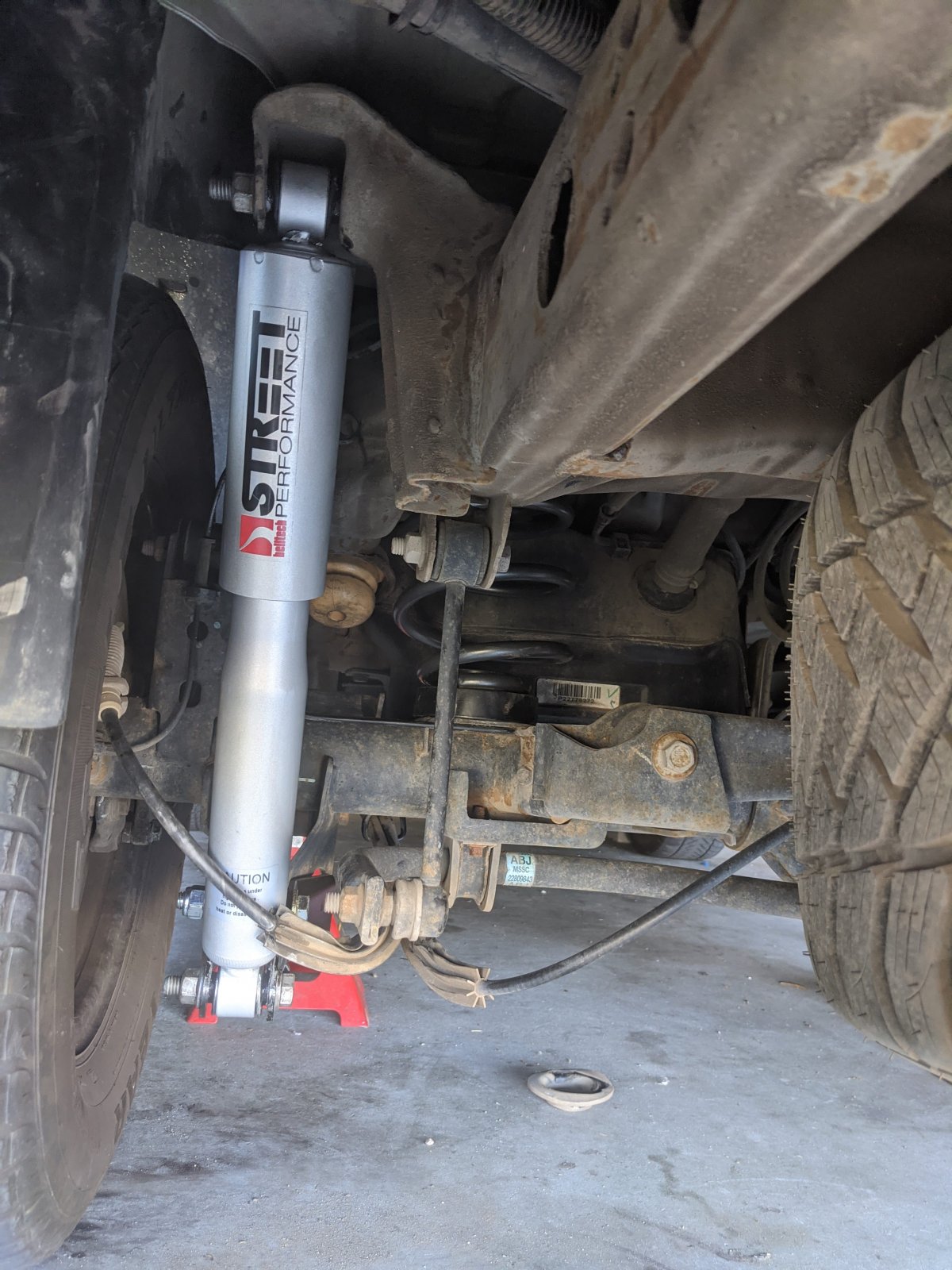

Then I went with the 1" spacer, glad I did, those top strut bolts were a pain to torque

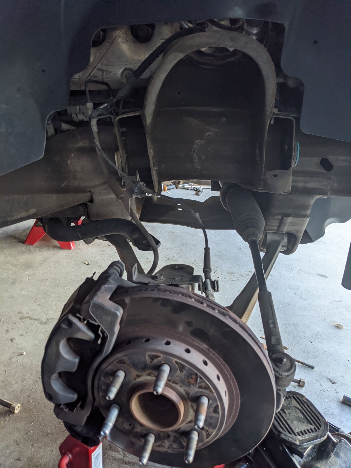

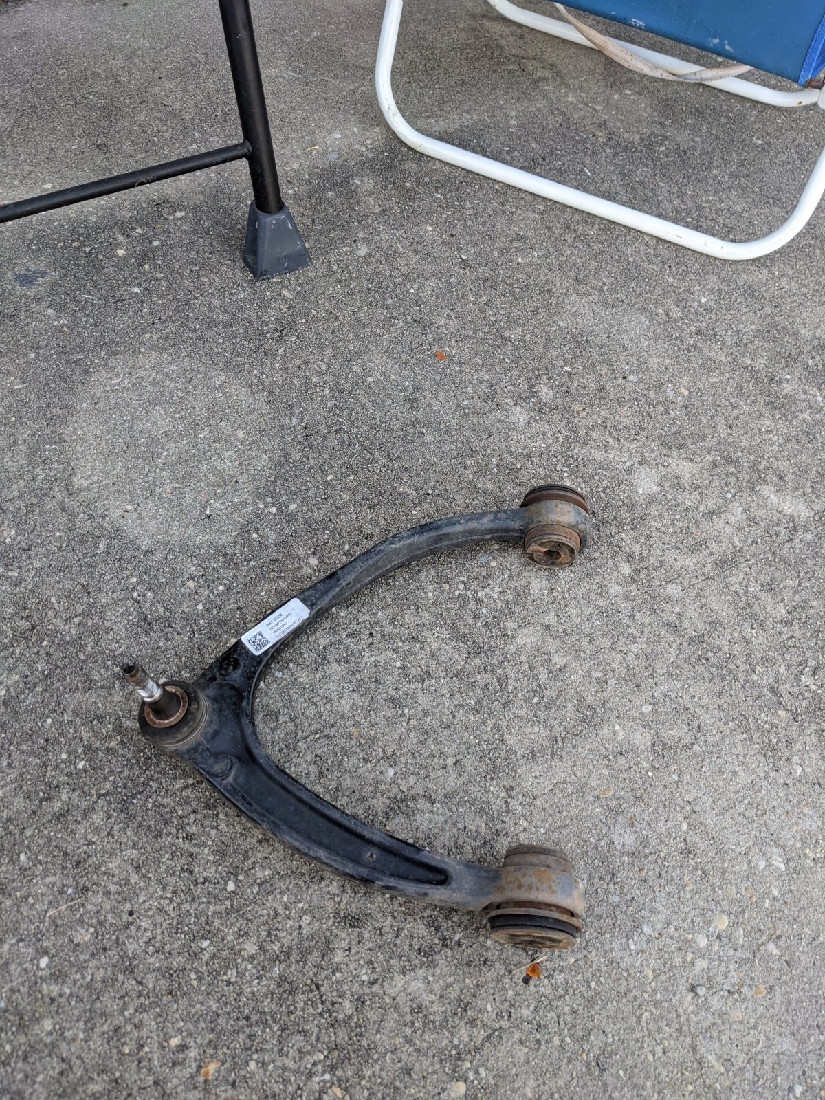

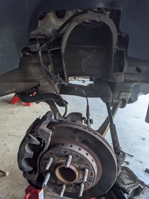

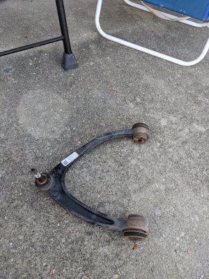

Lol yeah i need to get a vice, also do you guys know if I can pop out these ball joints and replace or do I need to replace the whole control arm?
33,326
51,788
Should be able to take them out. Instead of doing bushings and ball joint replacements, it's just easier to buy a new control arm. That's what I did for my NBS. Soooooo much easier.

Now thats a good idea

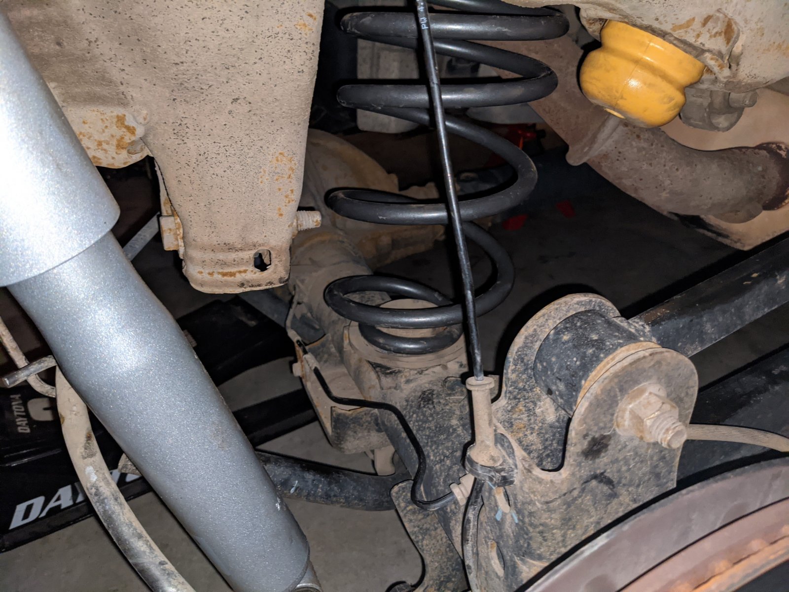

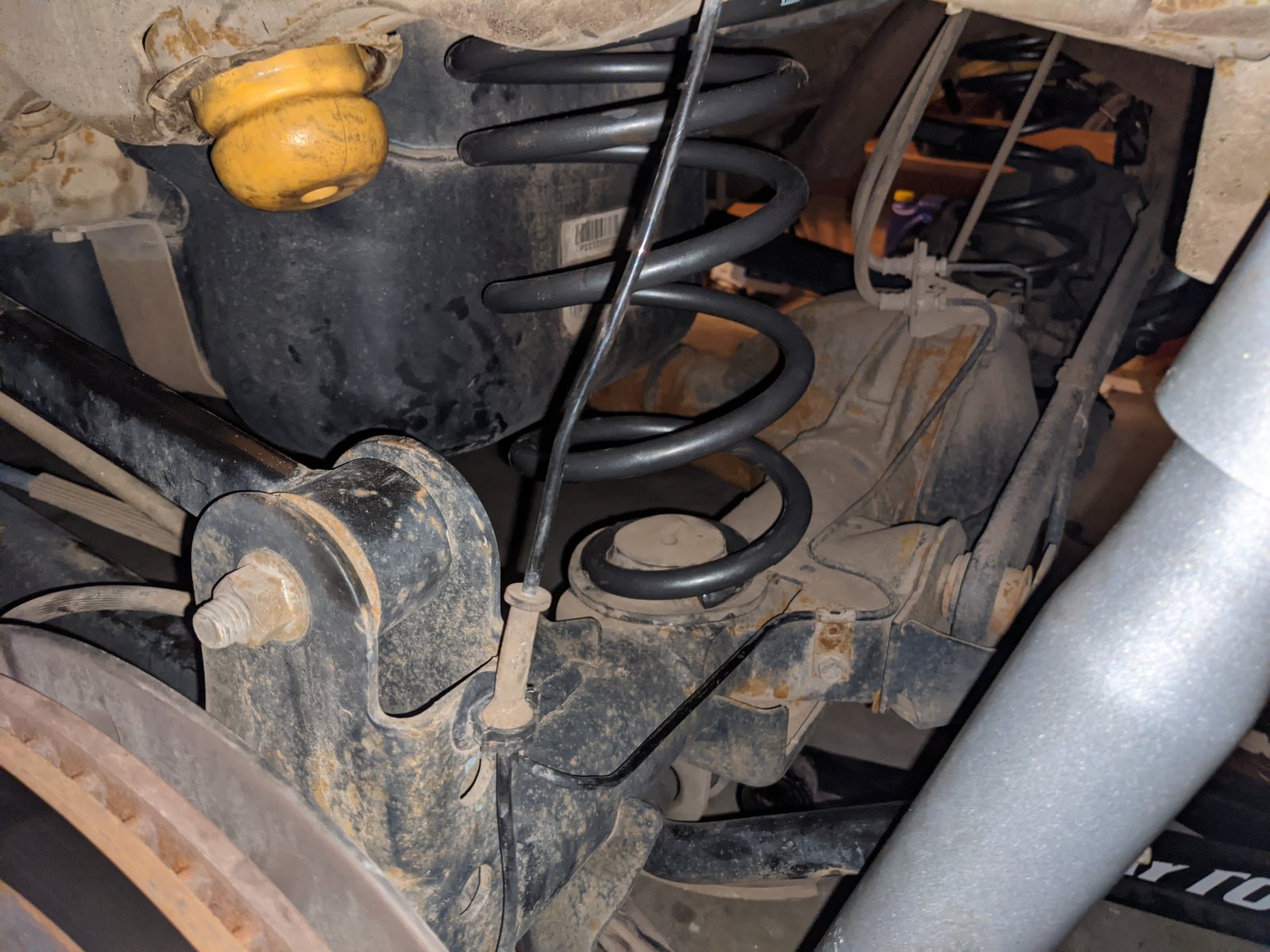

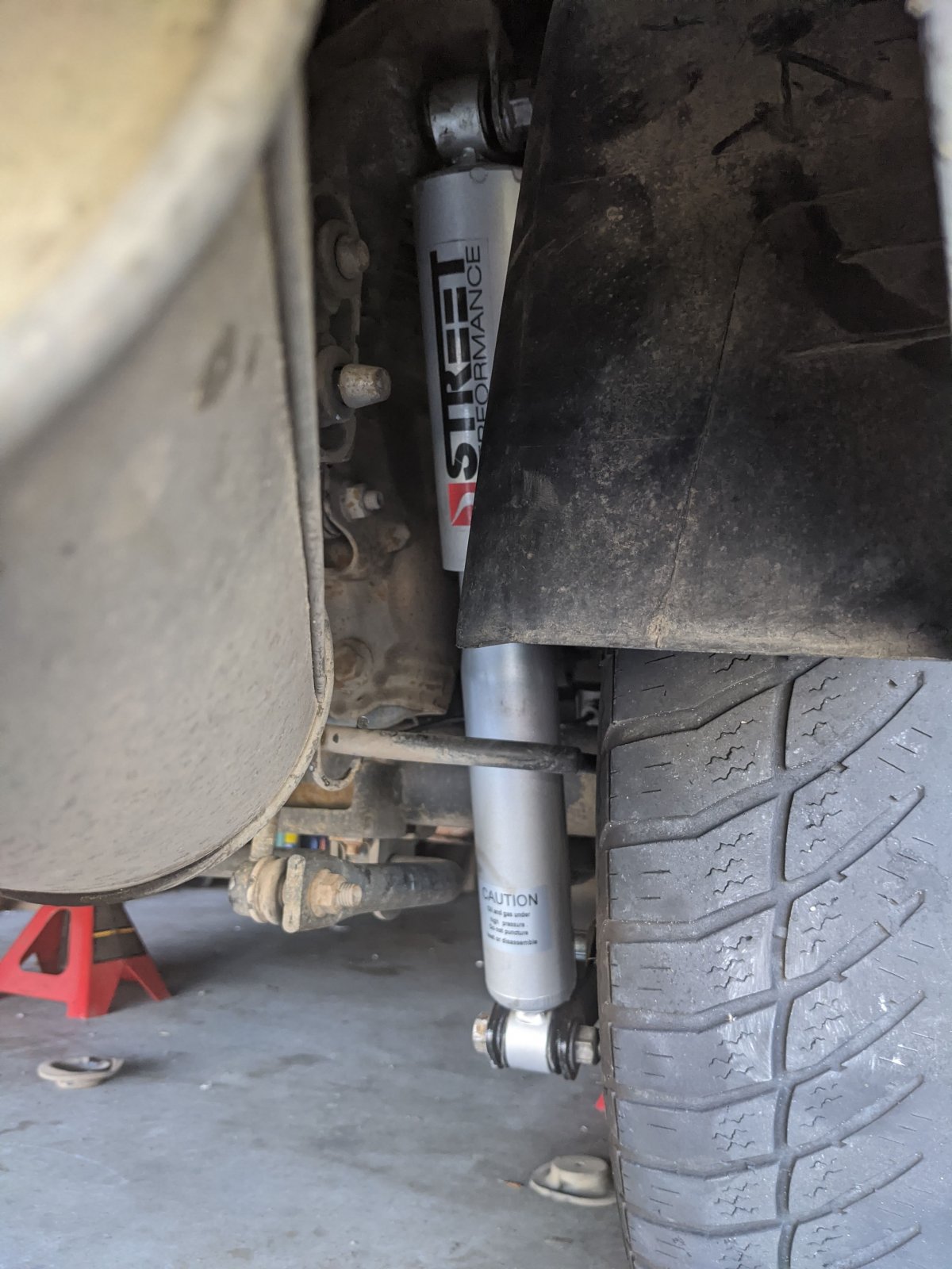

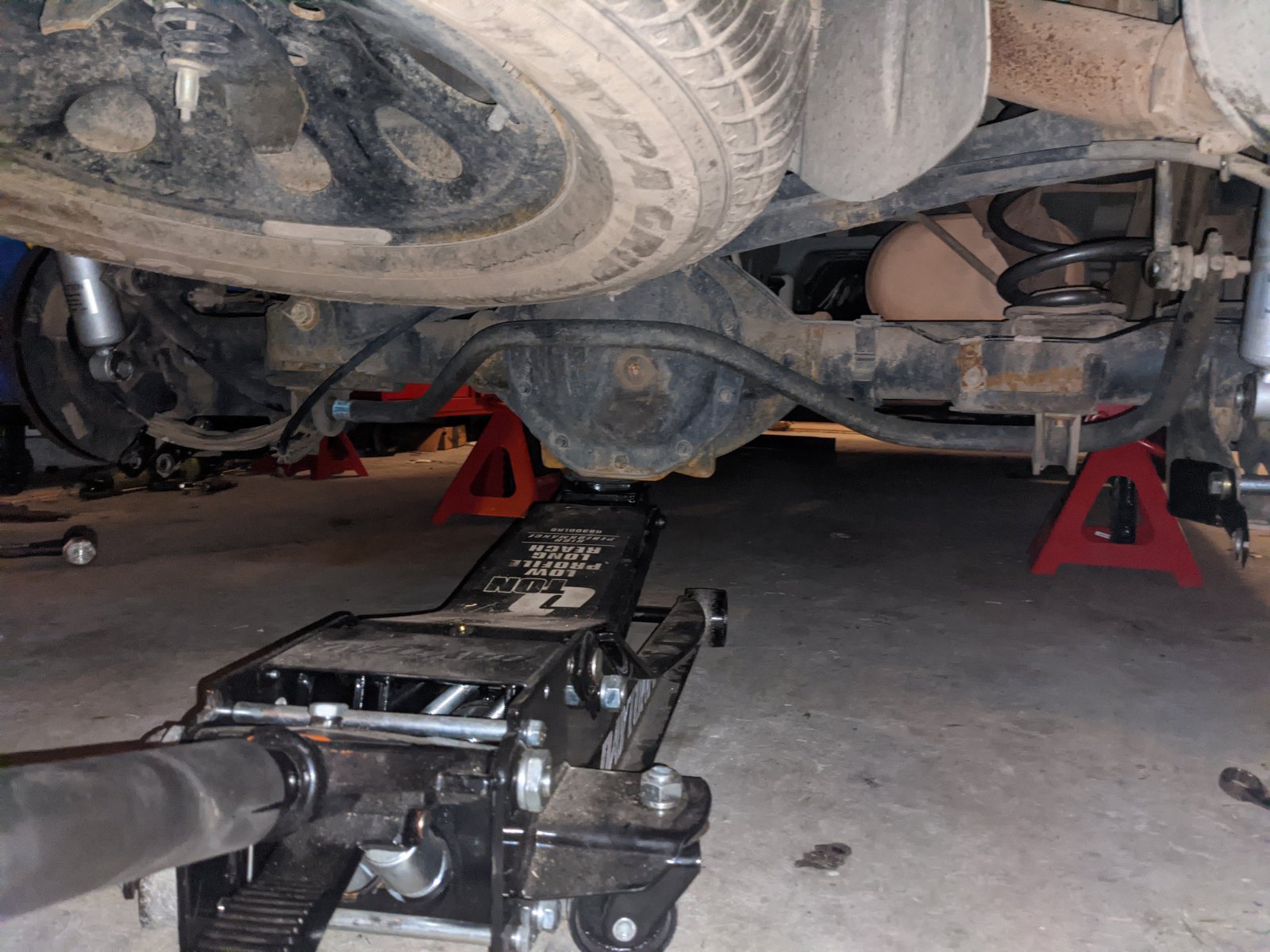

I decided to drop the rear another inch and take out the spacer :)

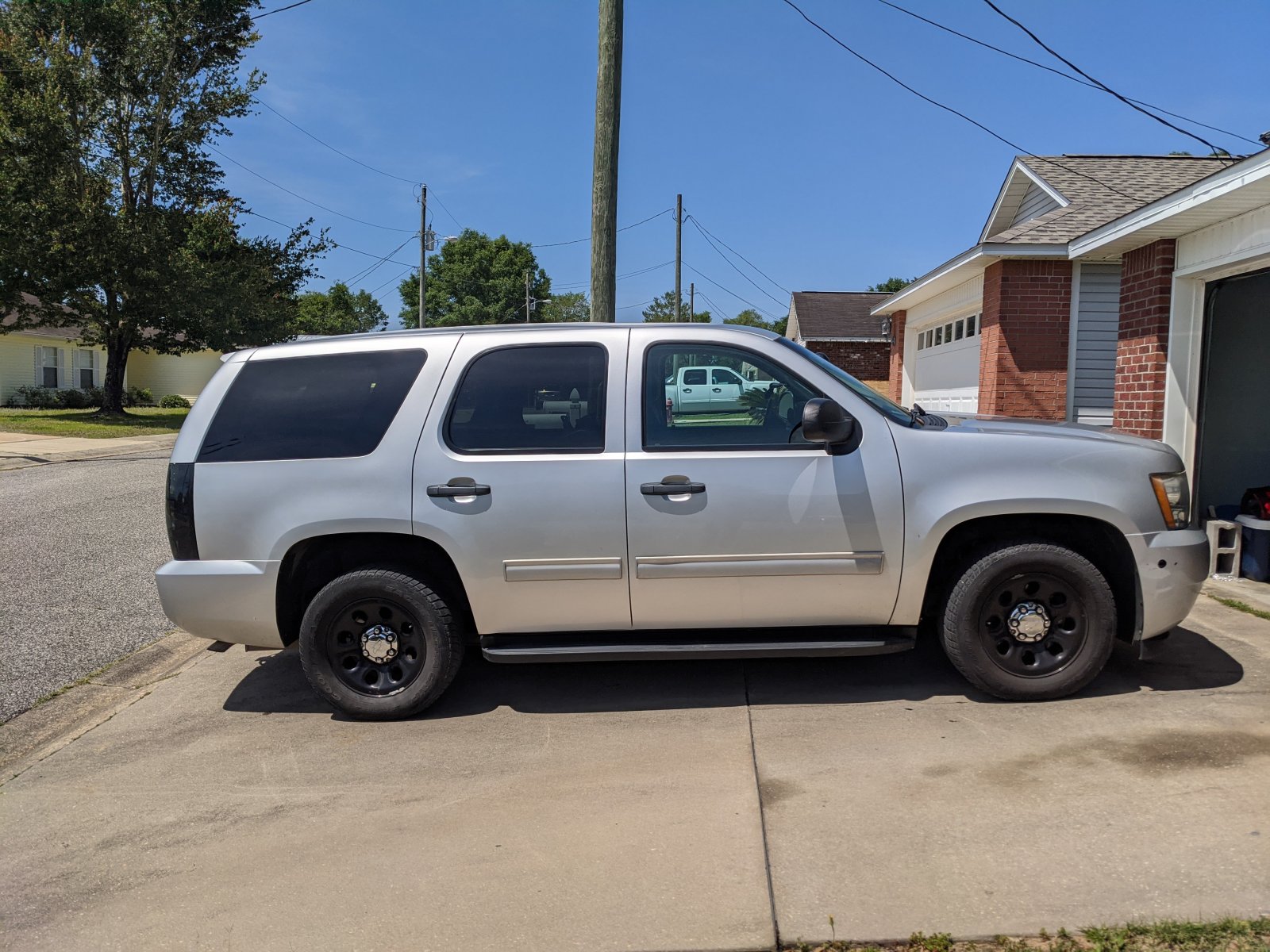

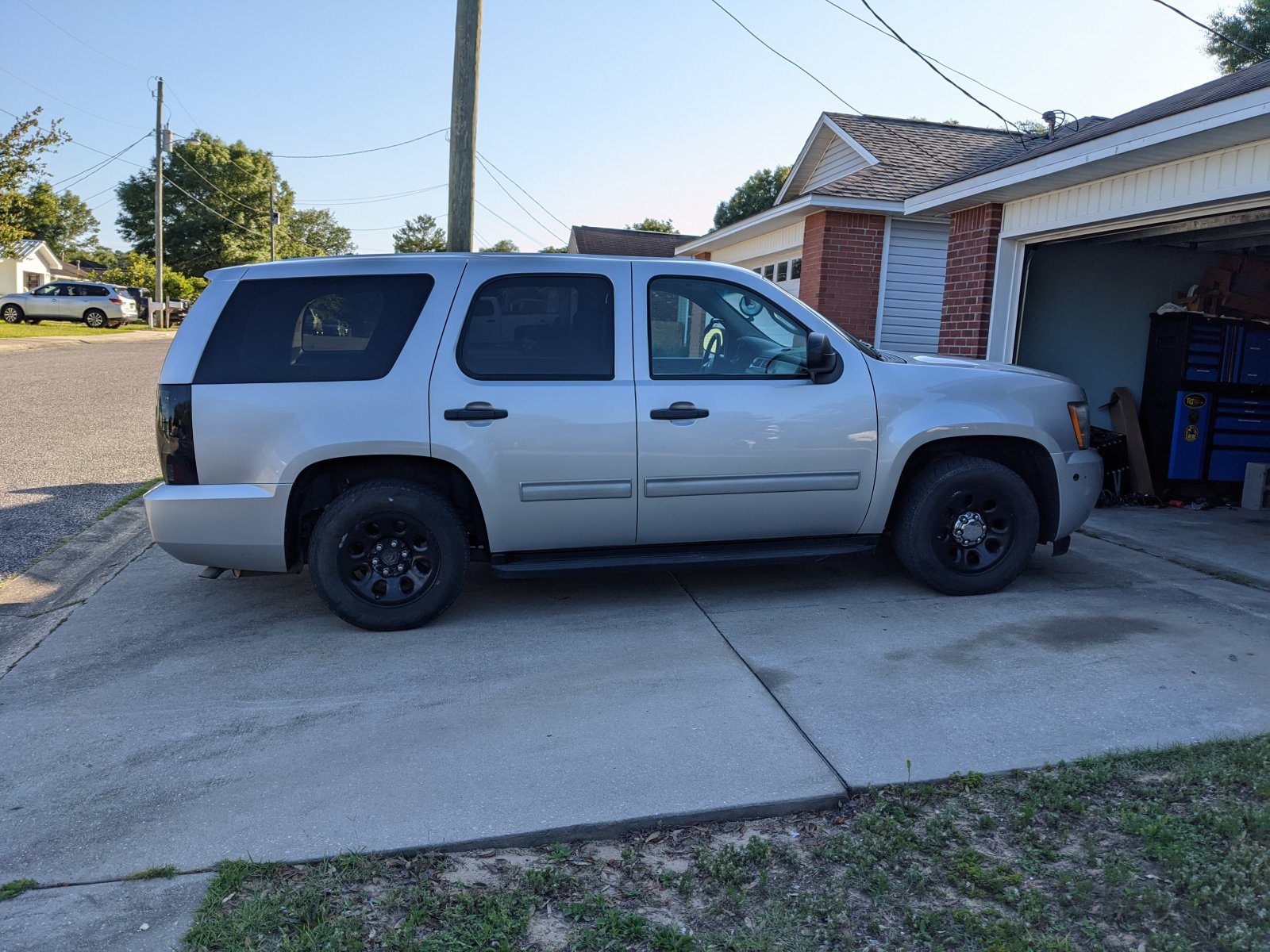

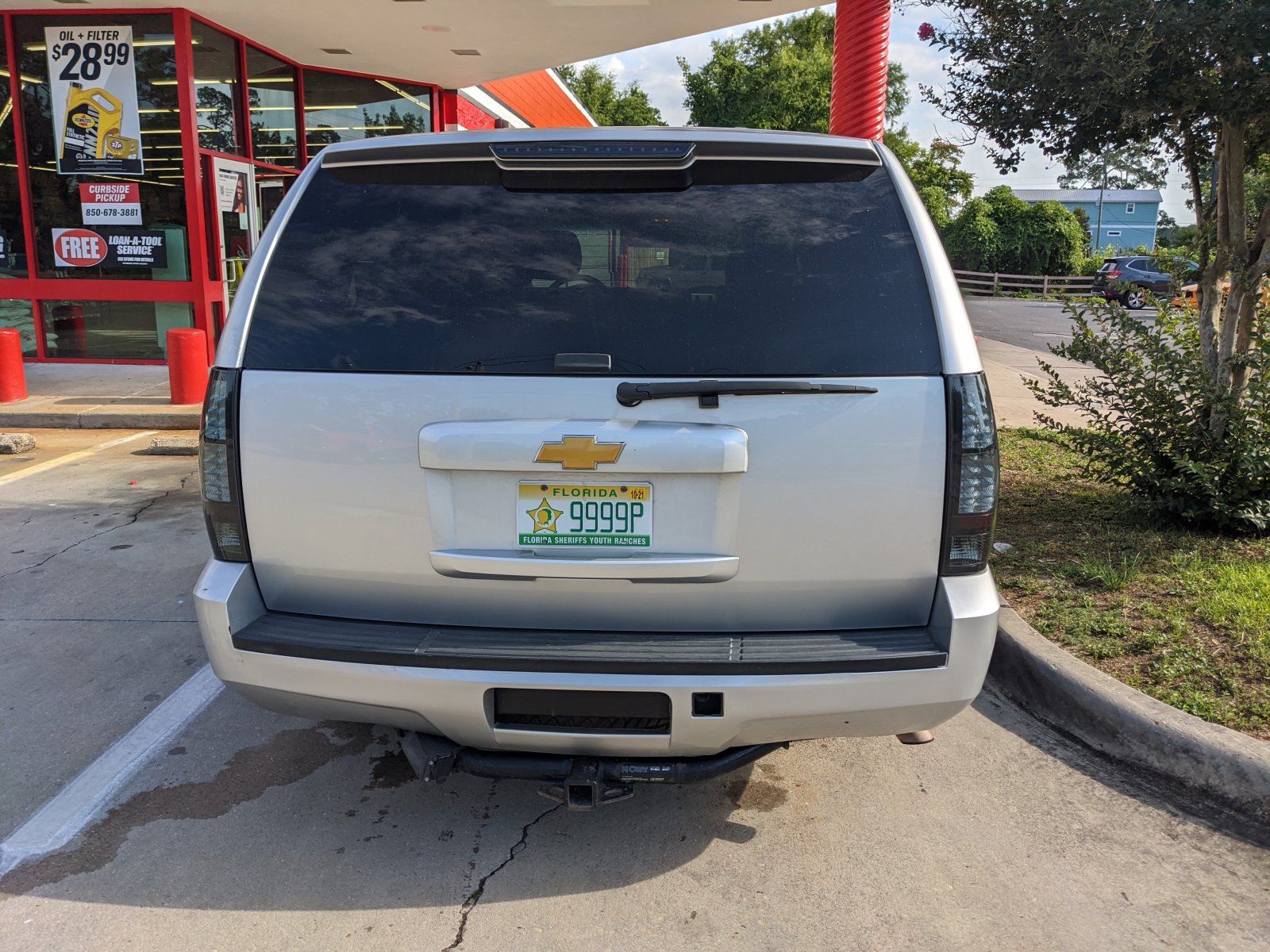

Here it is with the full drop in the rear and the front, got it aligned and I'm really loving the ride of the Belltech 752SP. It is a little low though with the cop wheels and tires, I did order some new wheels/tires which are 2" taller, so that should help. I'll keep you guys posted.
33,326
51,788
I think it looks good as is.

Yeah I like the look as well, but the bottom of the bumper now scrapes alot of stuff. Which I am not too into that, lol I just came from a lifted Landcruiser to this ;)

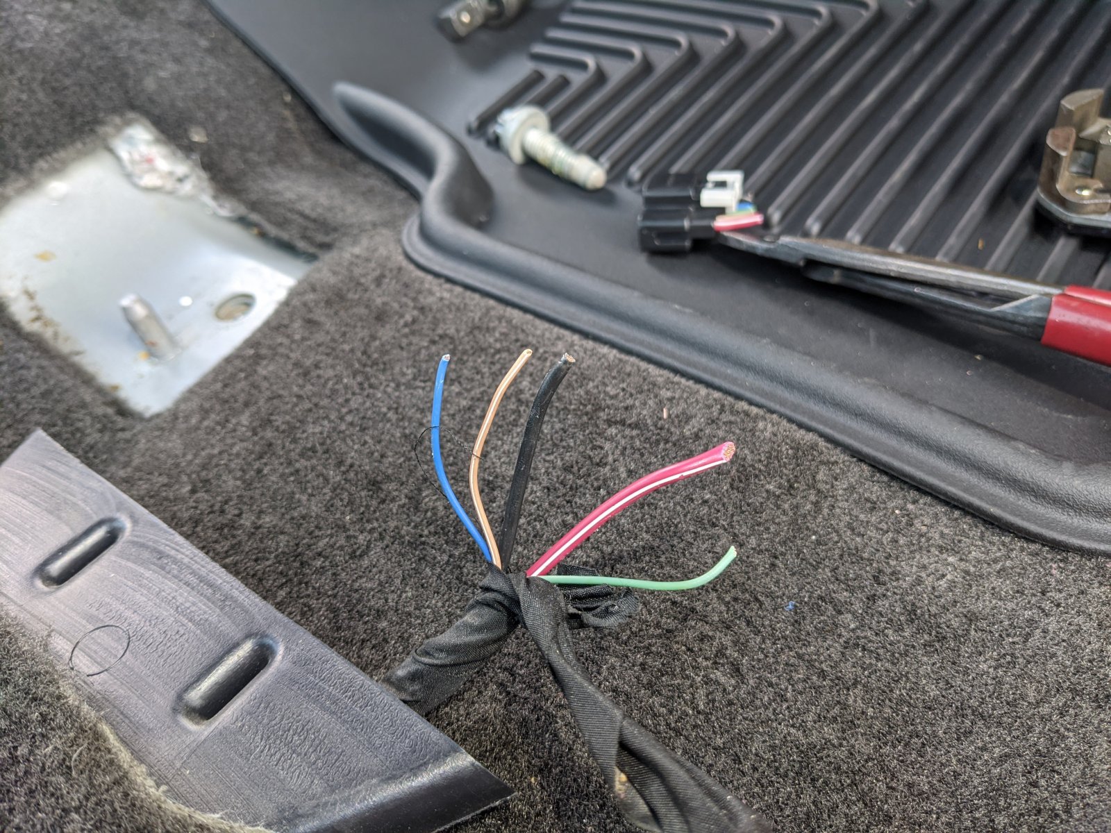

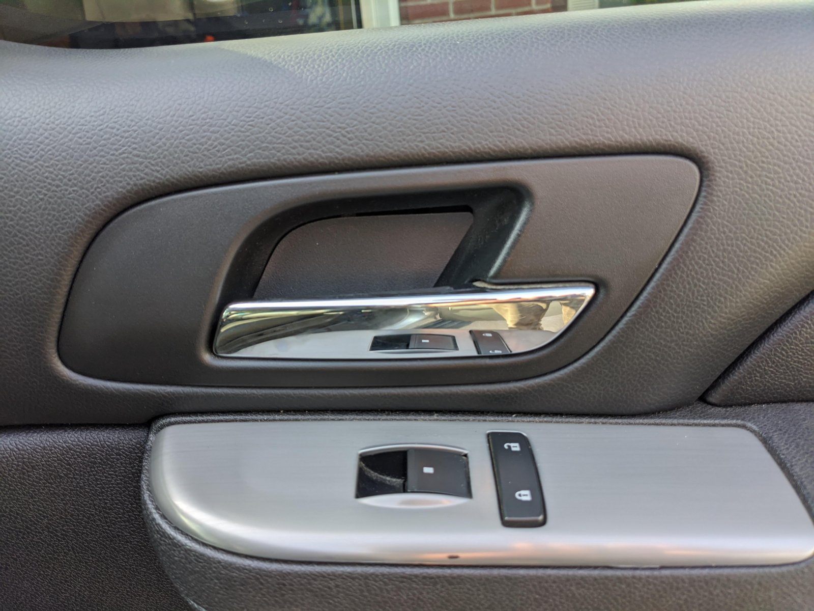

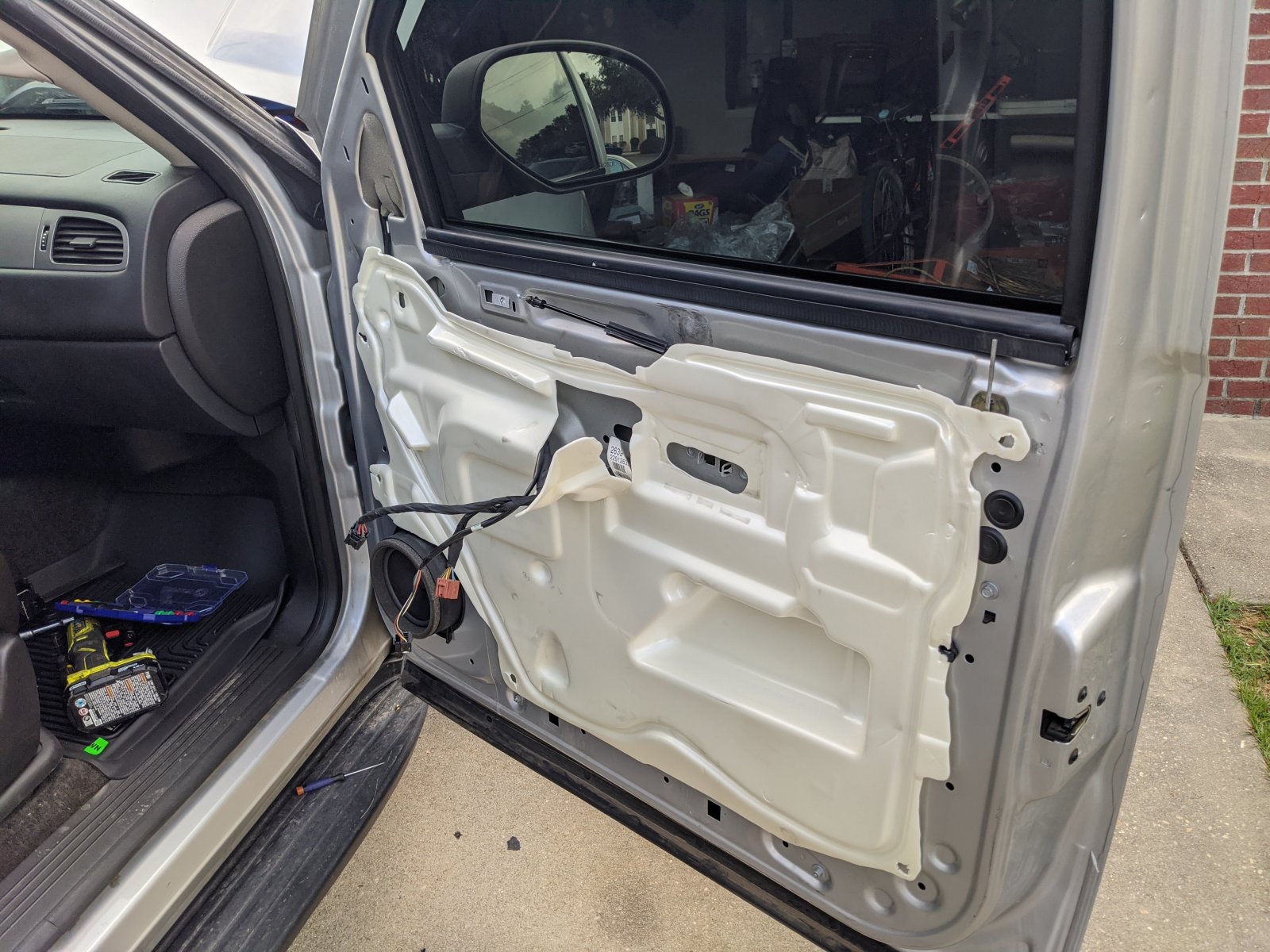

Working on getting this wired up, I have to swap out the door handles to make it work, where do they plug in?

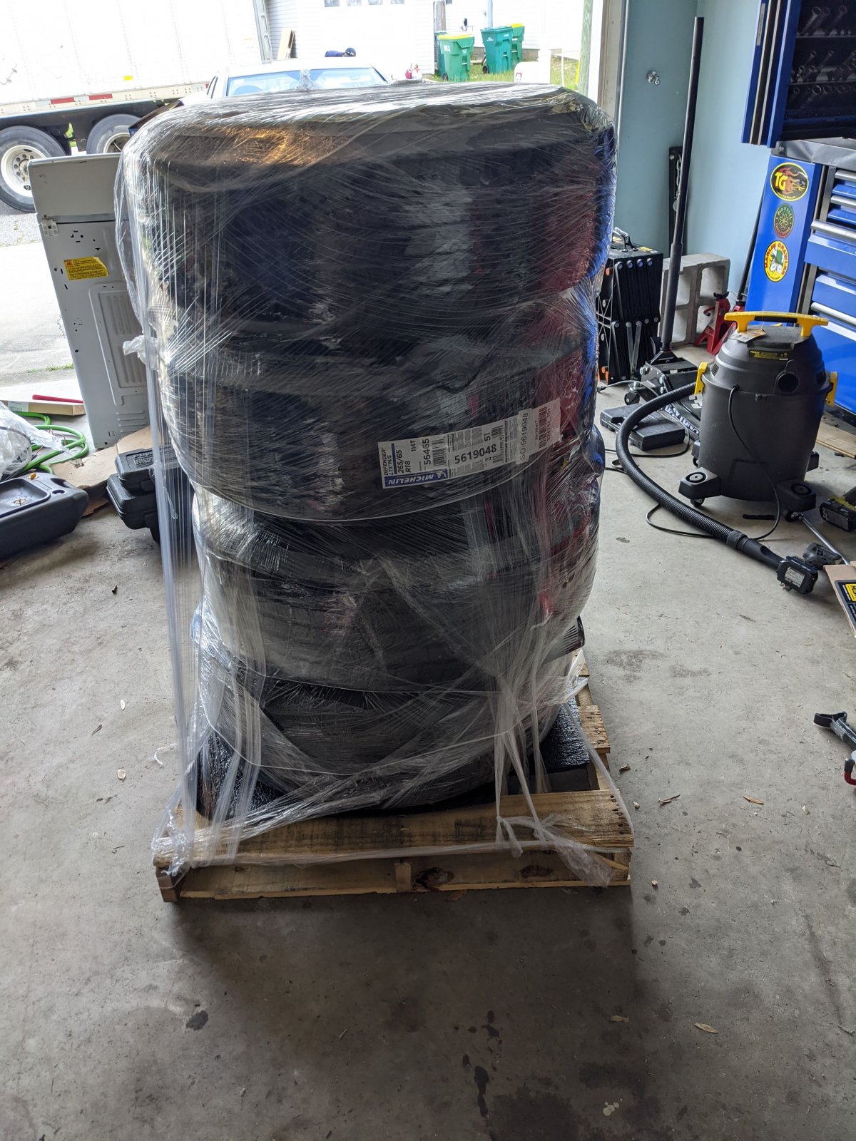

I got a set of wheels and tires from custom offsets 265 65 18, on vrock extractors, it didn't work out, they sent the wrong bolt pattern oooof!

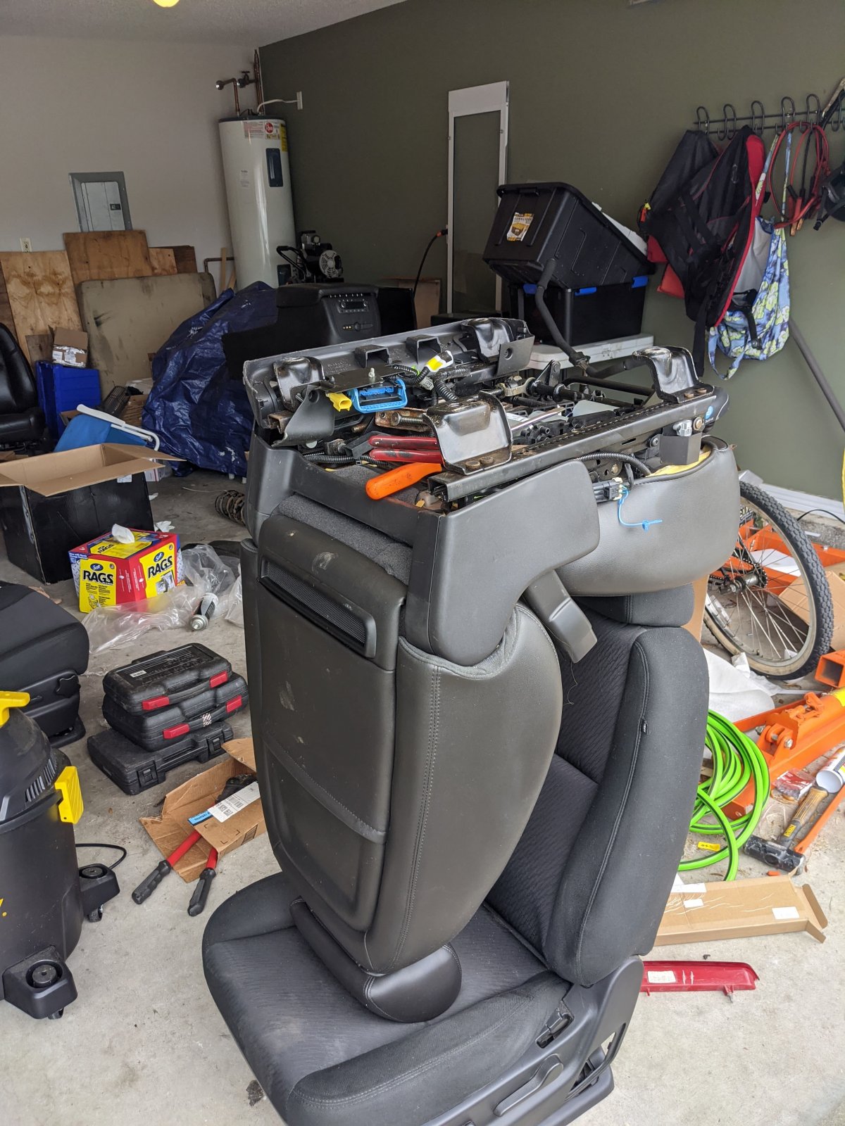

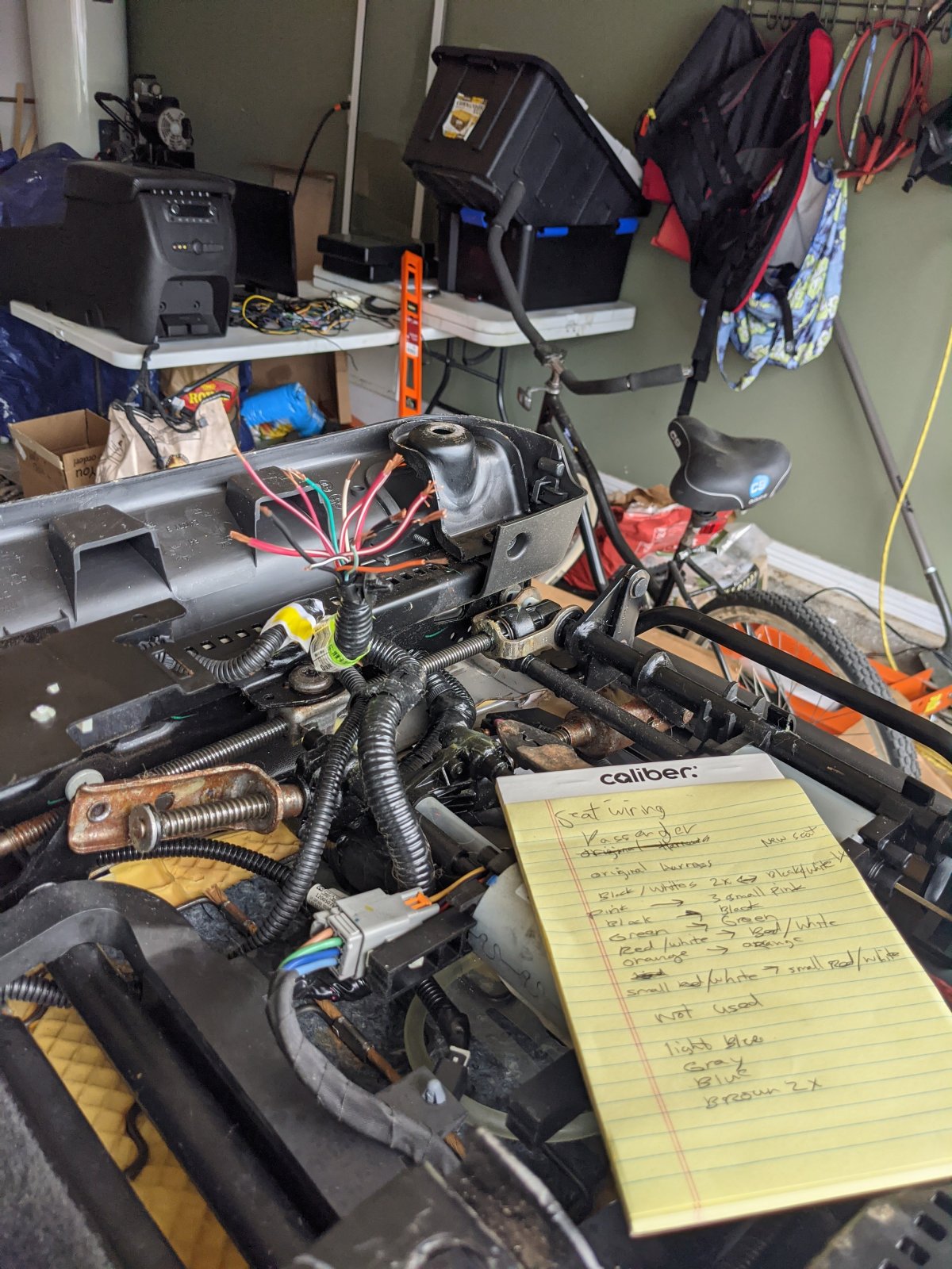

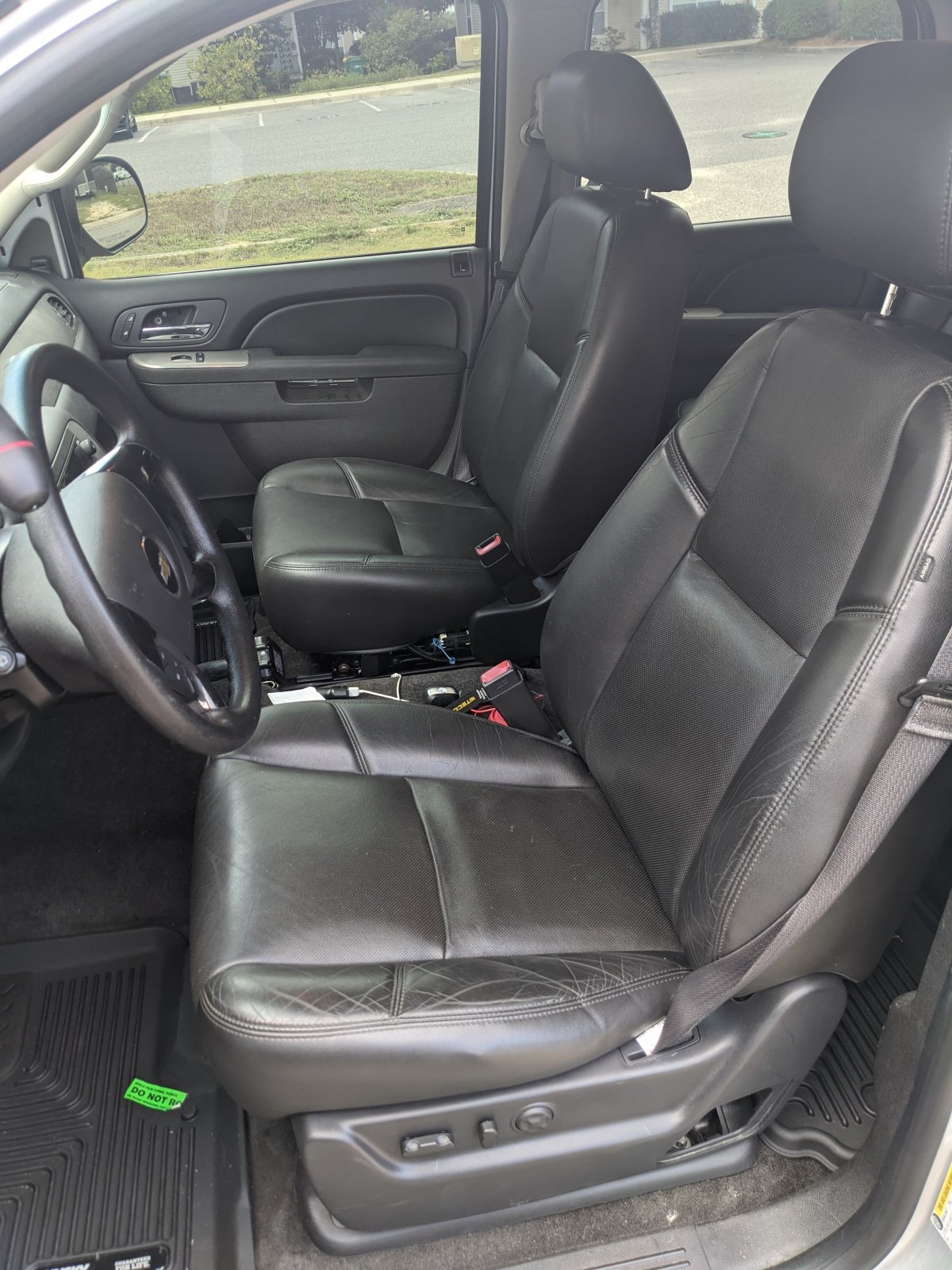

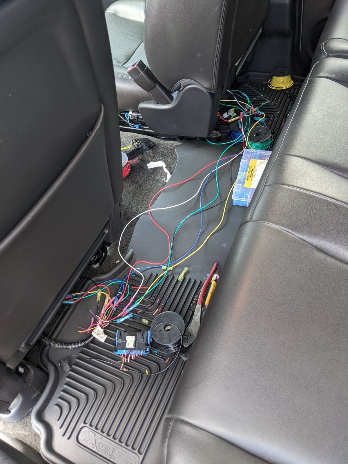

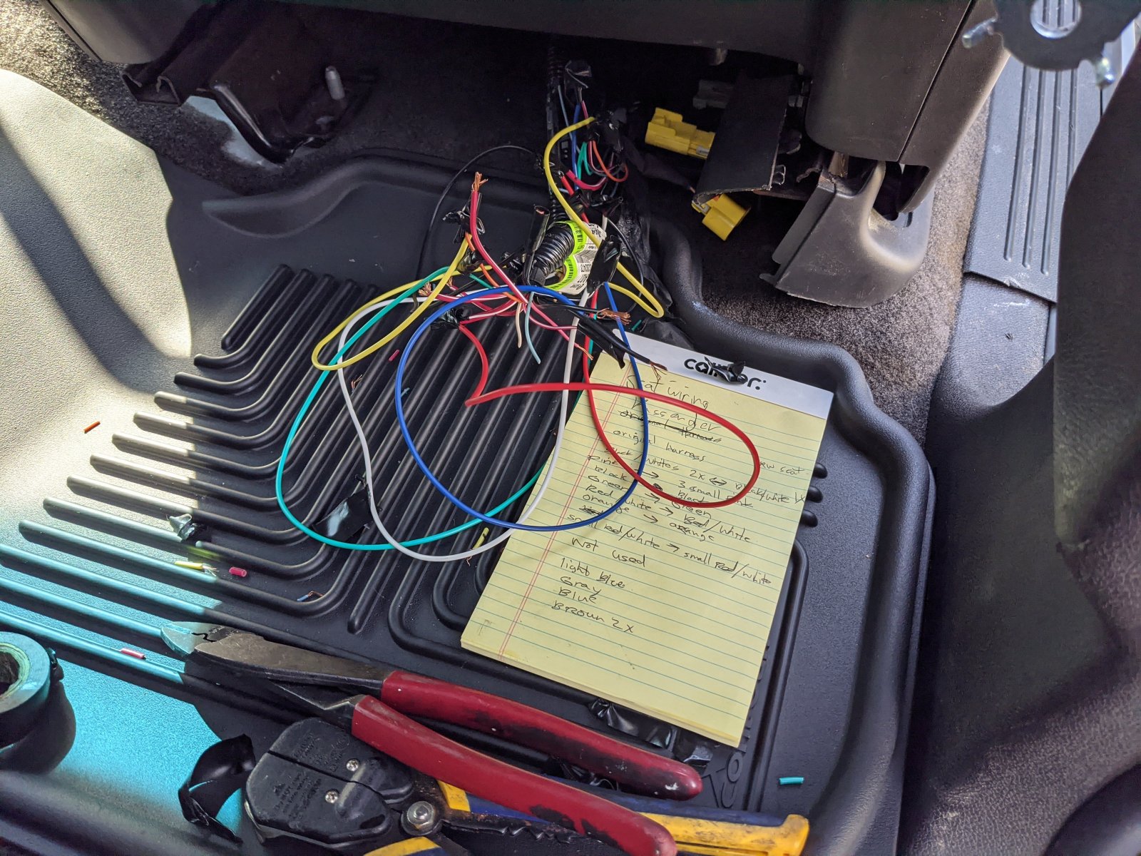

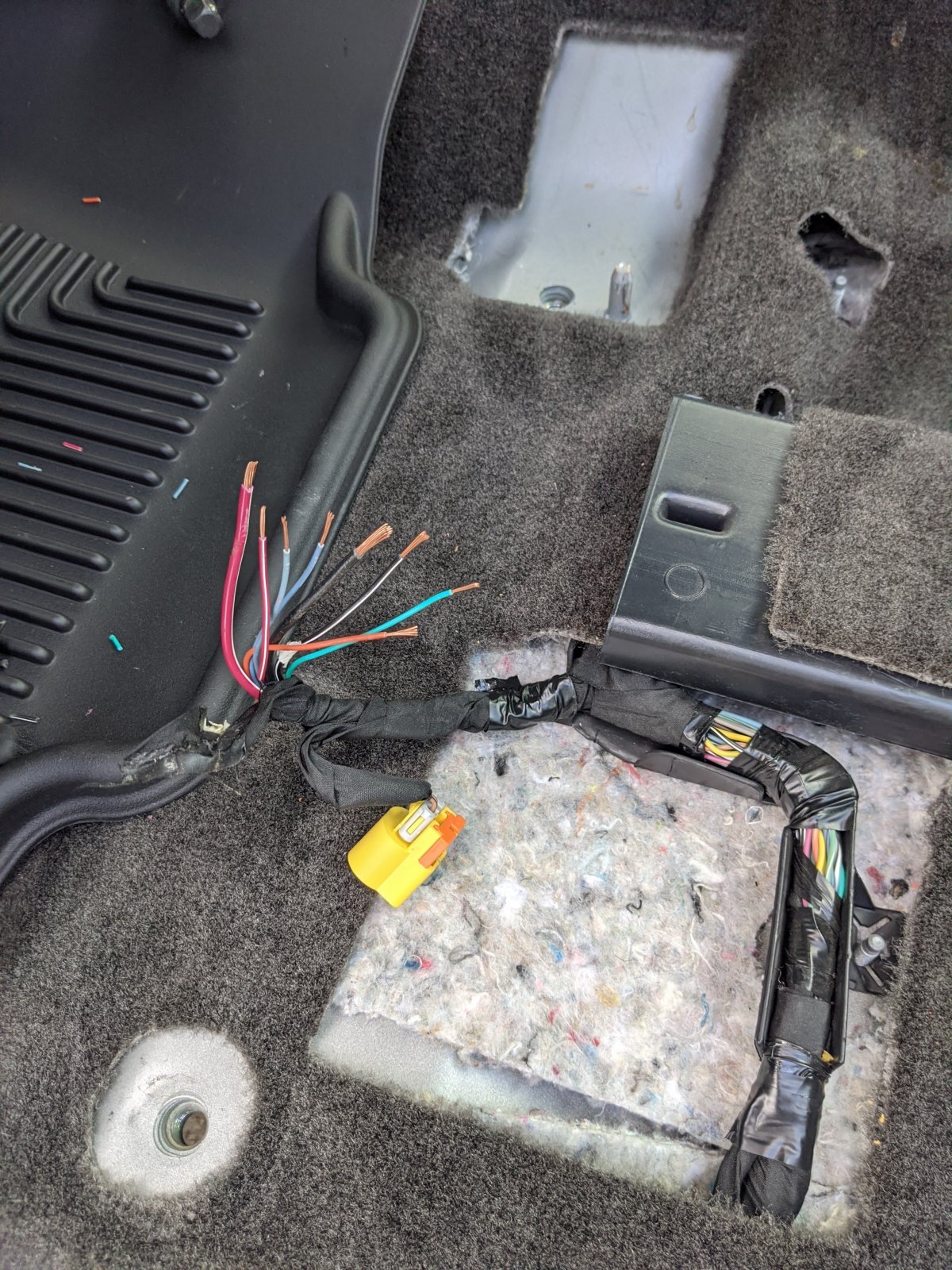

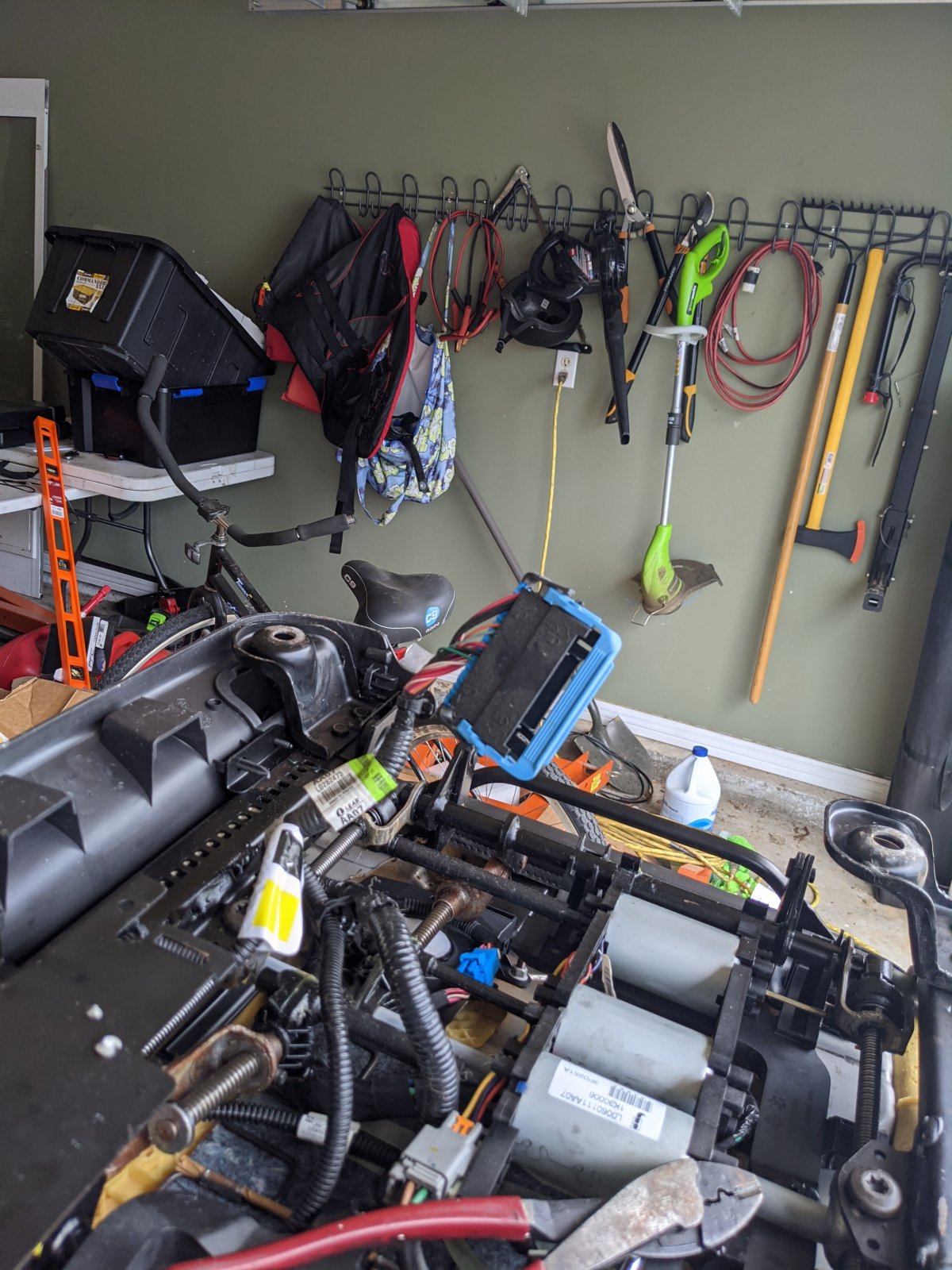

Also I worked on the front seat swap and wiring etc, I followed that previous video @balln2k11 mentioned to get power to the seat motors. It didn't match up exactly like the video the wiring colors on my seats were different, from an escalade. But I ended up finding a wiring diagram and made a harness in hopes of getting the heated and cooled seats working. Here are some pics

More seat swap pics, with test wiring setup, I know its messy, will have pics of the custom harness soon :)

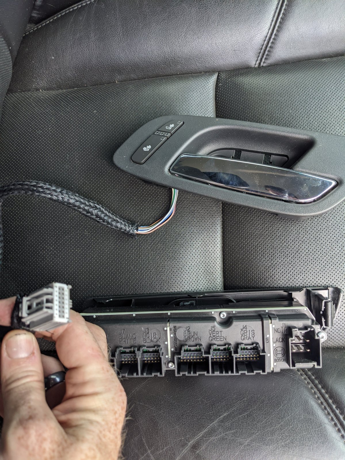

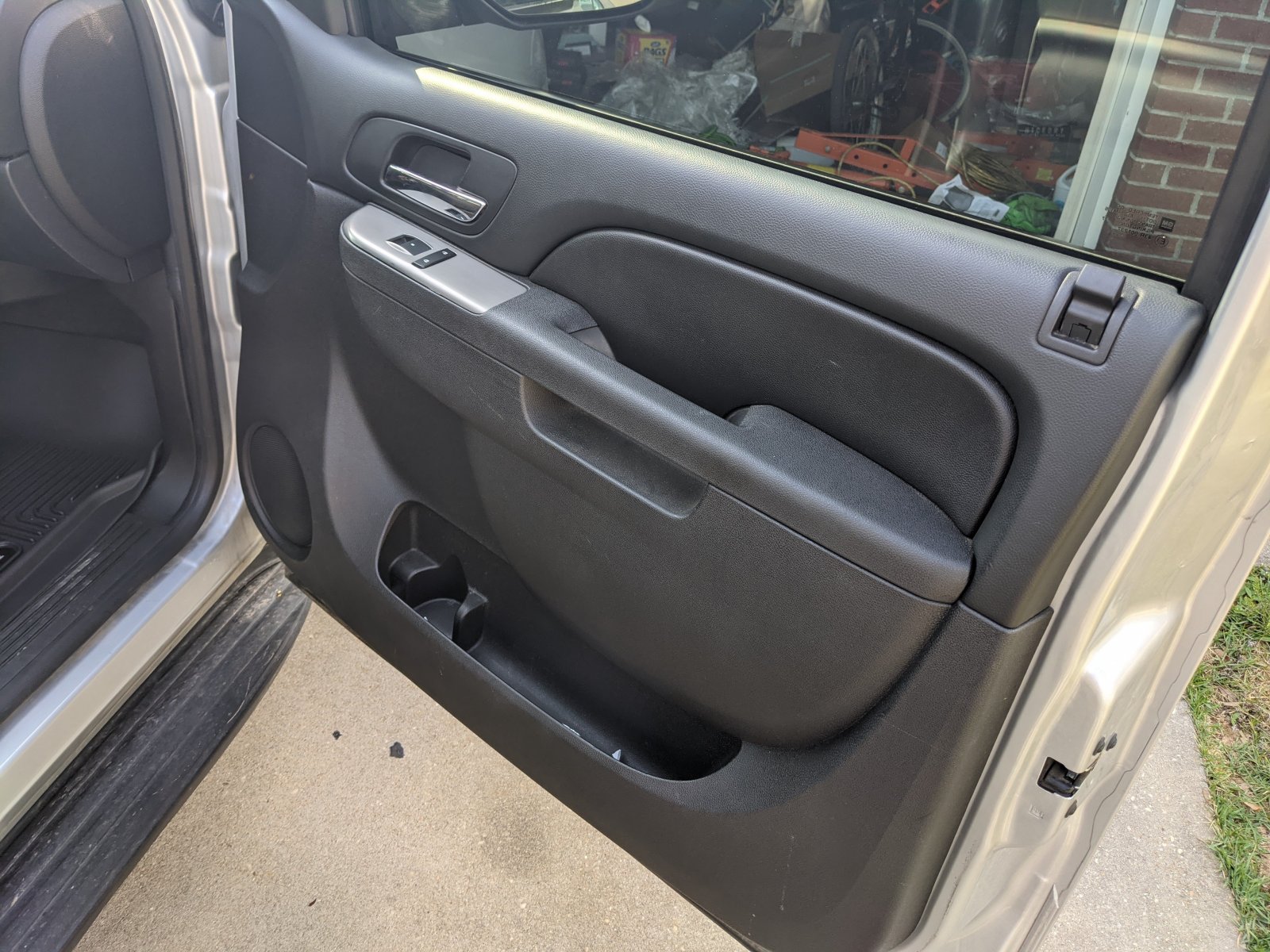

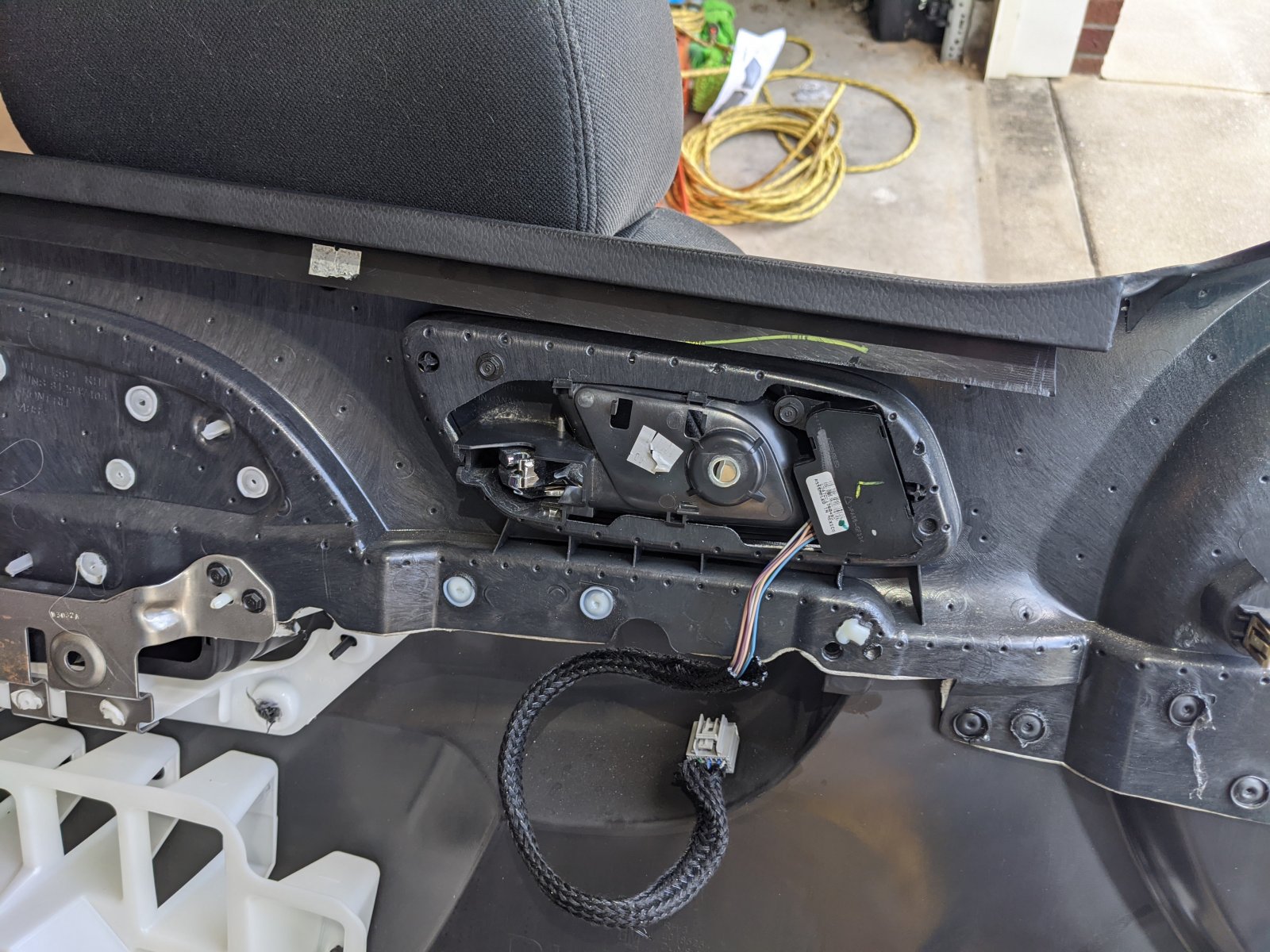

Adding in the heating and cooling controls to the doors, I am hopeful I can get it to work!!! ;)
