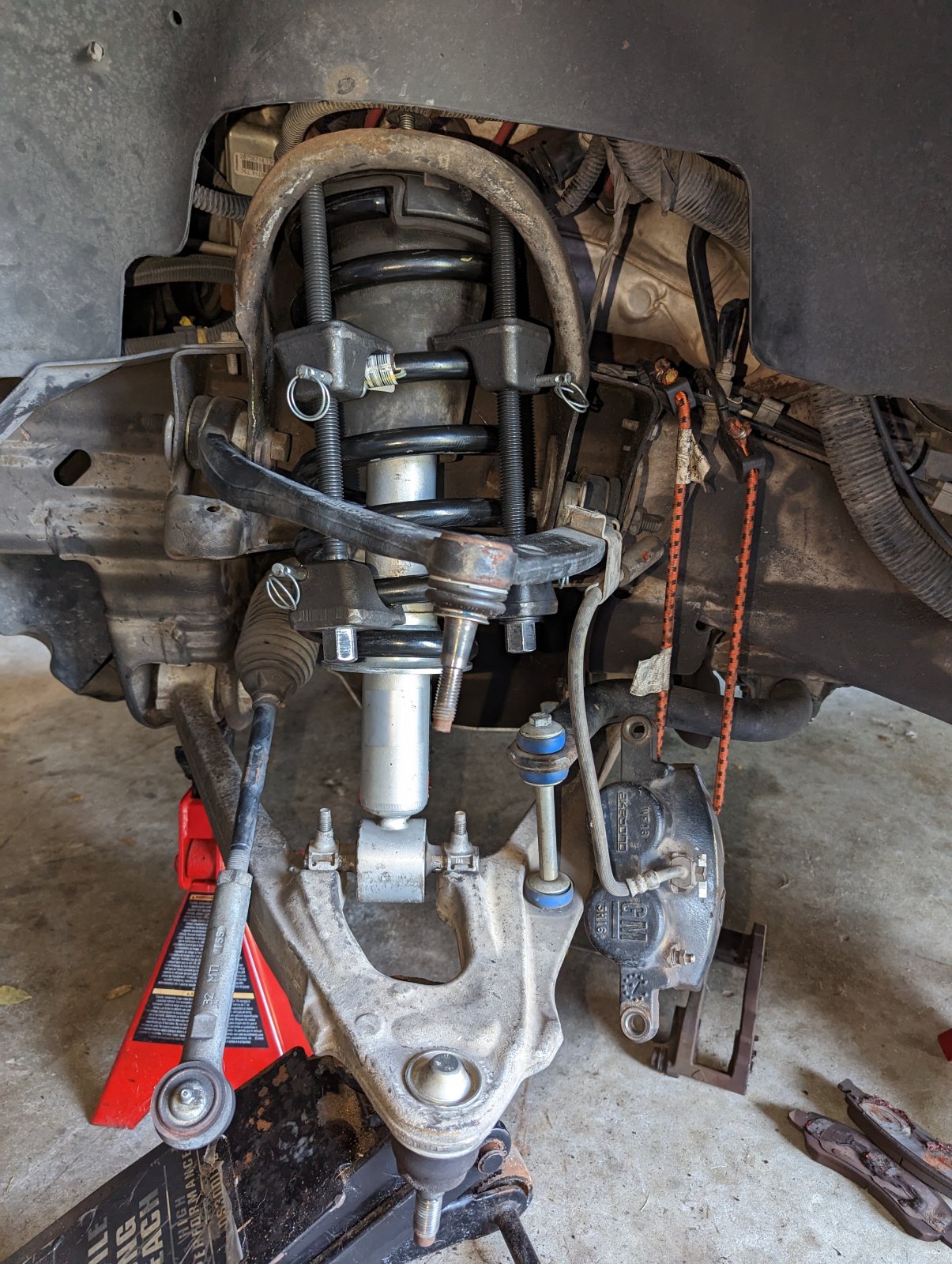

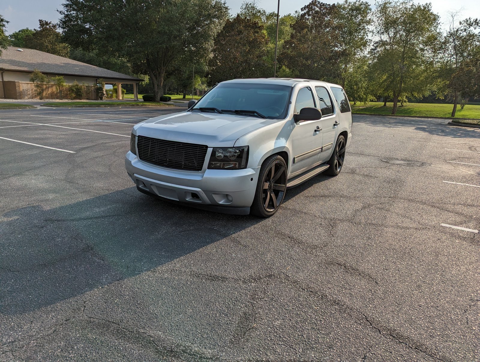

Hey guys, the ride quality has been driving me nuts and I did some digging and tried to find a way to get a better ride on the the Tahoe, looks like PPVs have 2 inch lower springs than the normal Tahoe, I like the low look and so I found a way to improve the ride and keep it low. It was a bit tricky because replacement springs are for either left or right fitment, I found out through a little trial and error that, the PPV uses two front right springs. To replace them I used two of part number 25876851. After that I installed a pair of Belltech 2509 drop spindles and man oh man, did it make a big difference, things are still getting settled but even with the 24s it's so much more cushy.

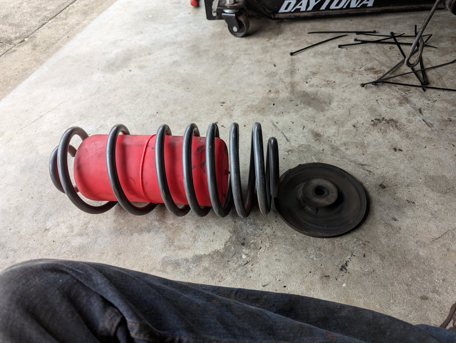

I also decided to work on the rear and add some airbags and replace the shocks for some that were softer
