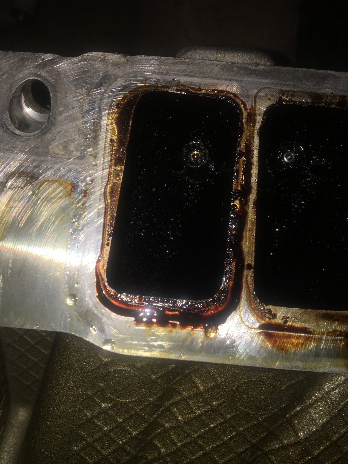

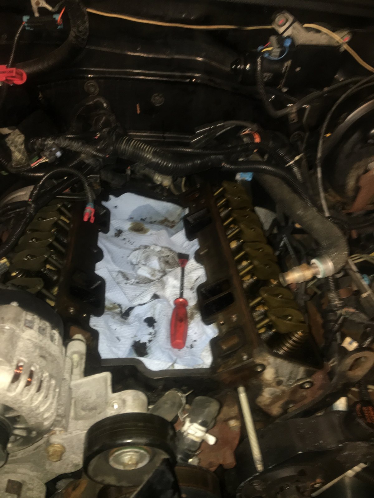

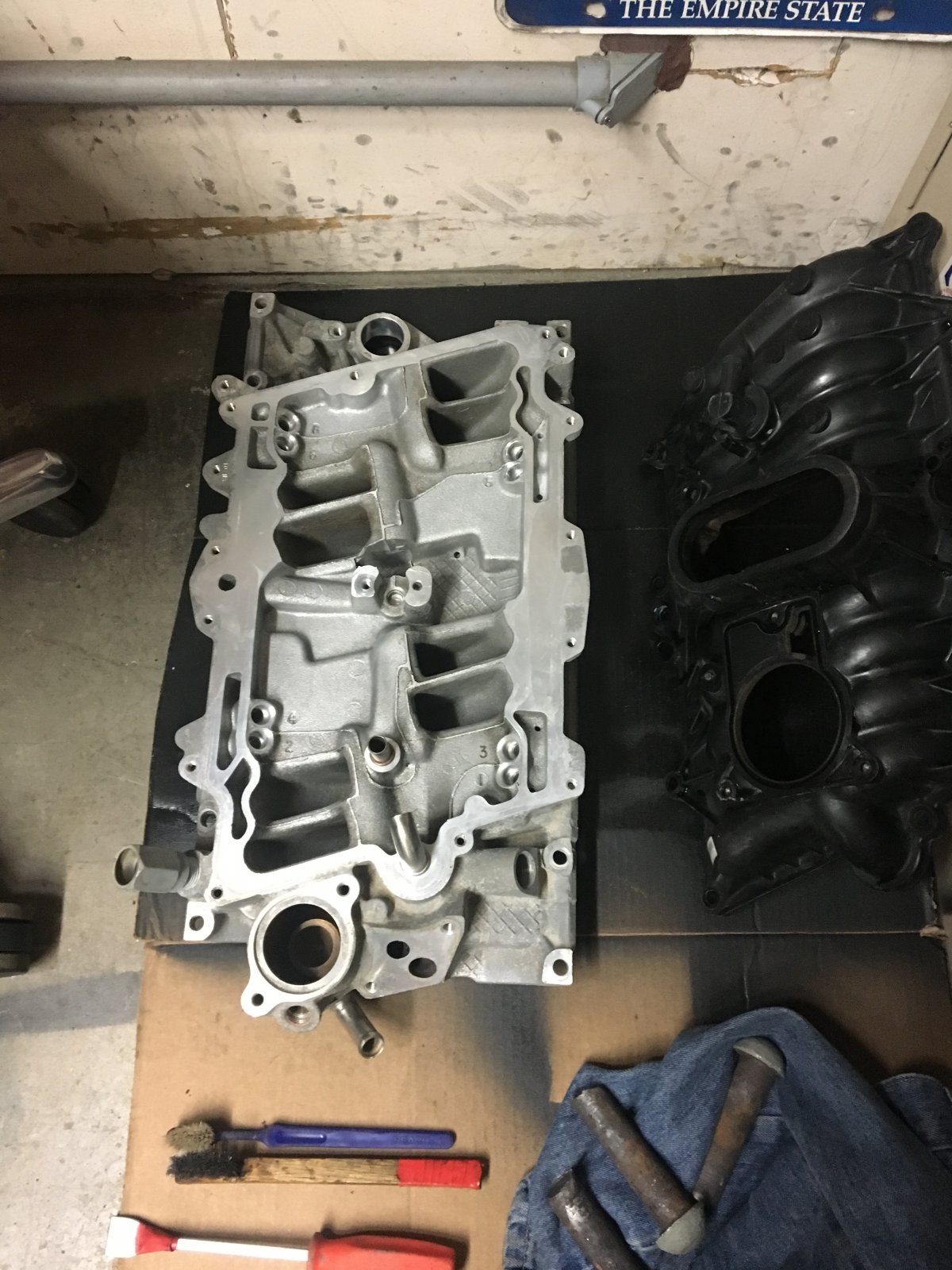

Didn’t go out last night was in the mid 20s All pulled apart. Anyone have a suggestion what to clean the lower intake with, I've seen people say they bring it to a shop to have it cleaned.
Is it blasted,parts washed, boiled in a solution, brake cleaner, or mineral spirits what would you do? Thanks
liquify33
Jan 21, 2019
351
337
Houston
That’s not bad IMHO, just make sure mating surfaces are nice and clean. I had some putting in the front corner/#1&2 area but sealed fine. Carb cleaner, wheel brush on a drill, some sandpaper and elbow grease. That’s by far the crappiest part of the job.

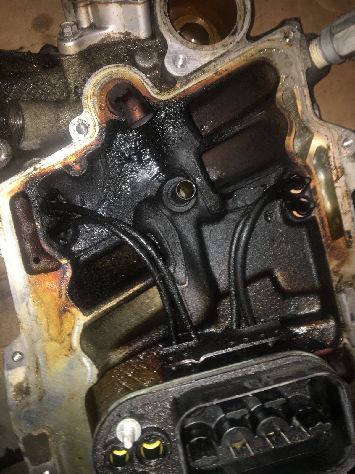

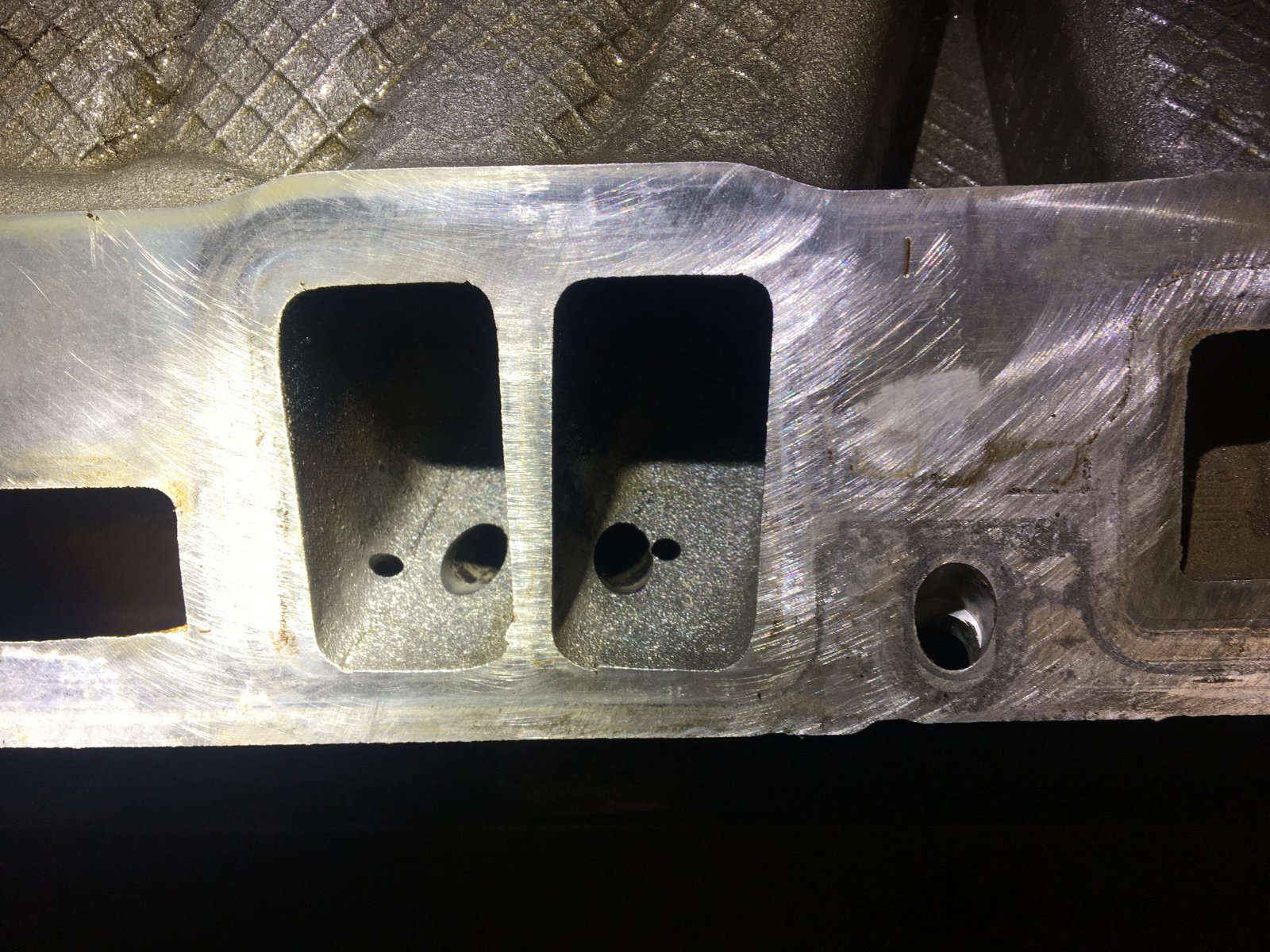

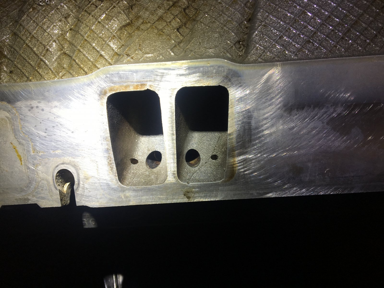

What about this can’t see other side do you think this is a crack or just in the casting and what are these holes for not all in the same spot like random one is right on the edge of the injector hole
exp500
May 14, 2017
2,026
1,985
That does look like cracks. Is there water on the other side? didn't look like it but you are there. If it is only intake valley you should be ok. Intake Manifolds around here are 35-40 junkyard.I haven't seen one crack before. Try a drop of acetone on crack to verify its not a scratch. It will pull right into crack.

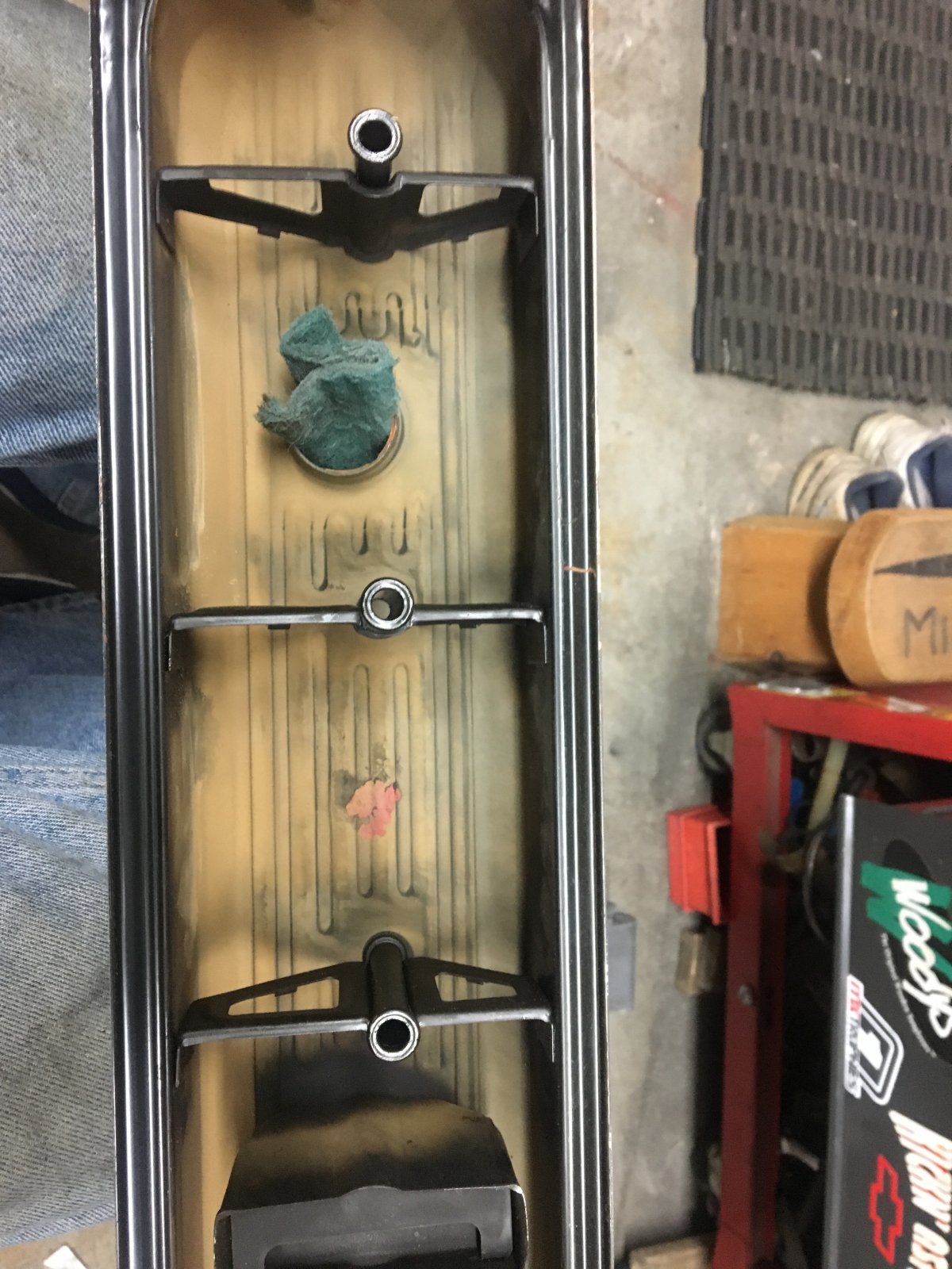

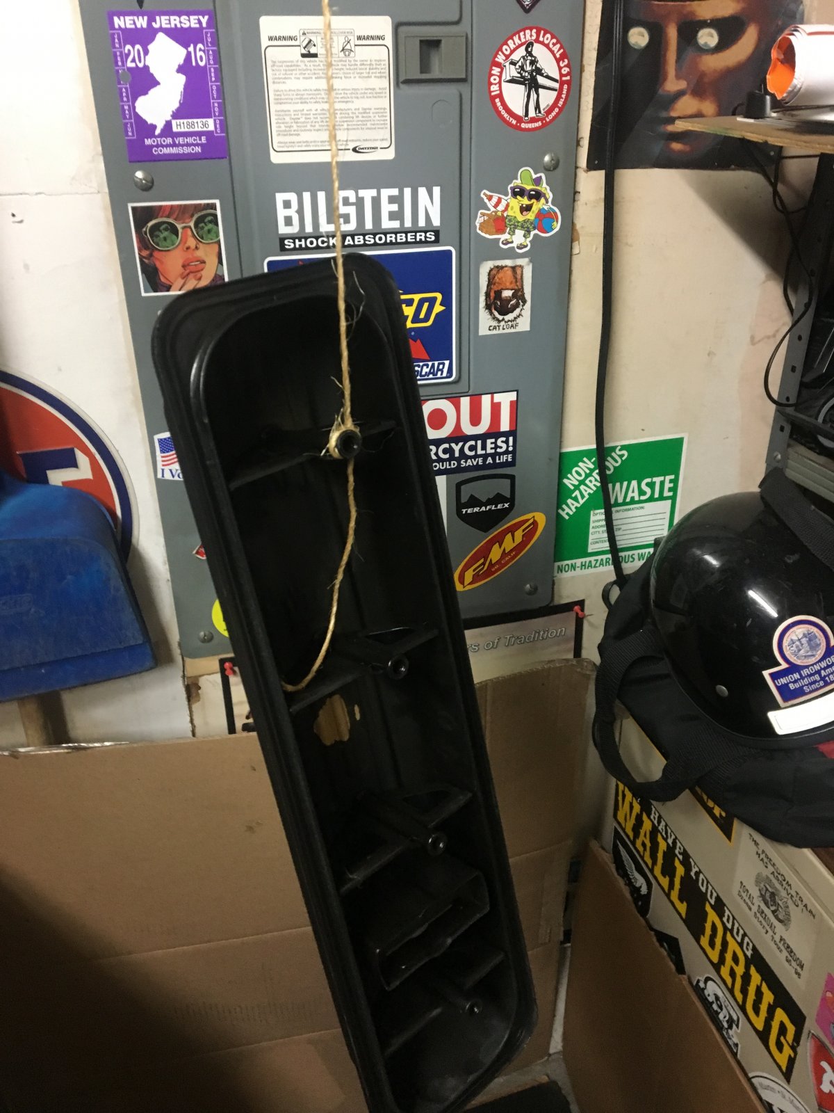

Cleaning valve covers for paint noticed inside of left side cover looks like this kind of brown finish wipes off but what is it
inside other side black anyone know why ?
exp500
May 14, 2017
2,026
1,985
One valve cover has direct vacuumn, the other air cleaner vacuumn. Clean for a hi mile. What oil you using? Valvolene Dino always makes a dark film as you call it, but the rest stays clean.

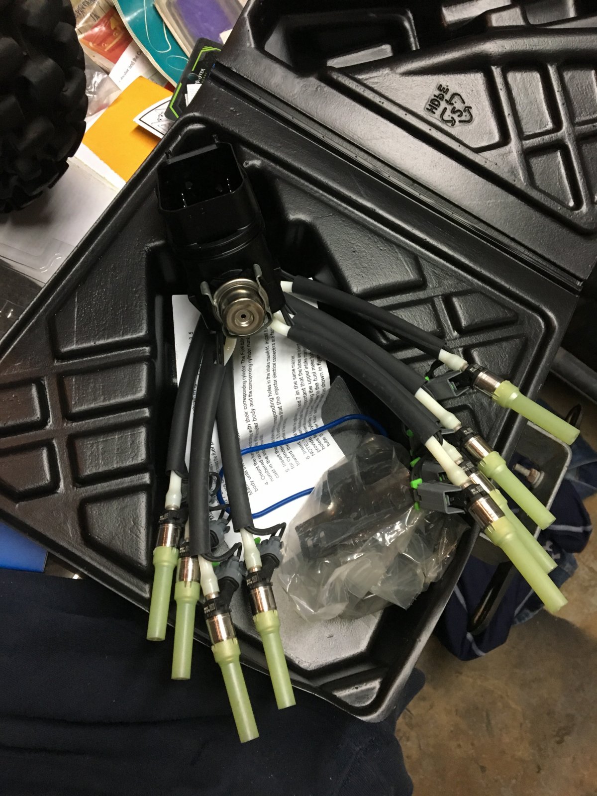

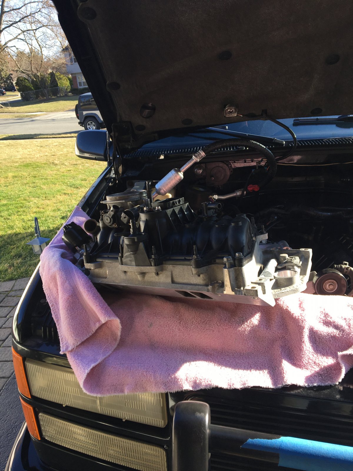

Ok upper and lower intake back in sanded,primed,and painted valve covers in spray booth now off to oven to bake on finish (top of furnace) spider was a little tough putting it in hope this is my problem one injector in way of throttle body but installed as per directions can’t really move it

Ok finished up spider conversion code 301 is gone drove and idled nice 45 minutes later boom check engine lit up wtf po154 it’s an 02 bank 2 sensor 1 clear it, back on po152 same bank 2 sensor 1back and fourth every time I cleared it so tonight I cleaned with carb cleaner swap out 02s from left to right good news now I have po134 bank 1 sensor 1 so it is safe to say sensor is bad and found this on the side of the road. Brought it back to the store earning a free pie for my honesty
