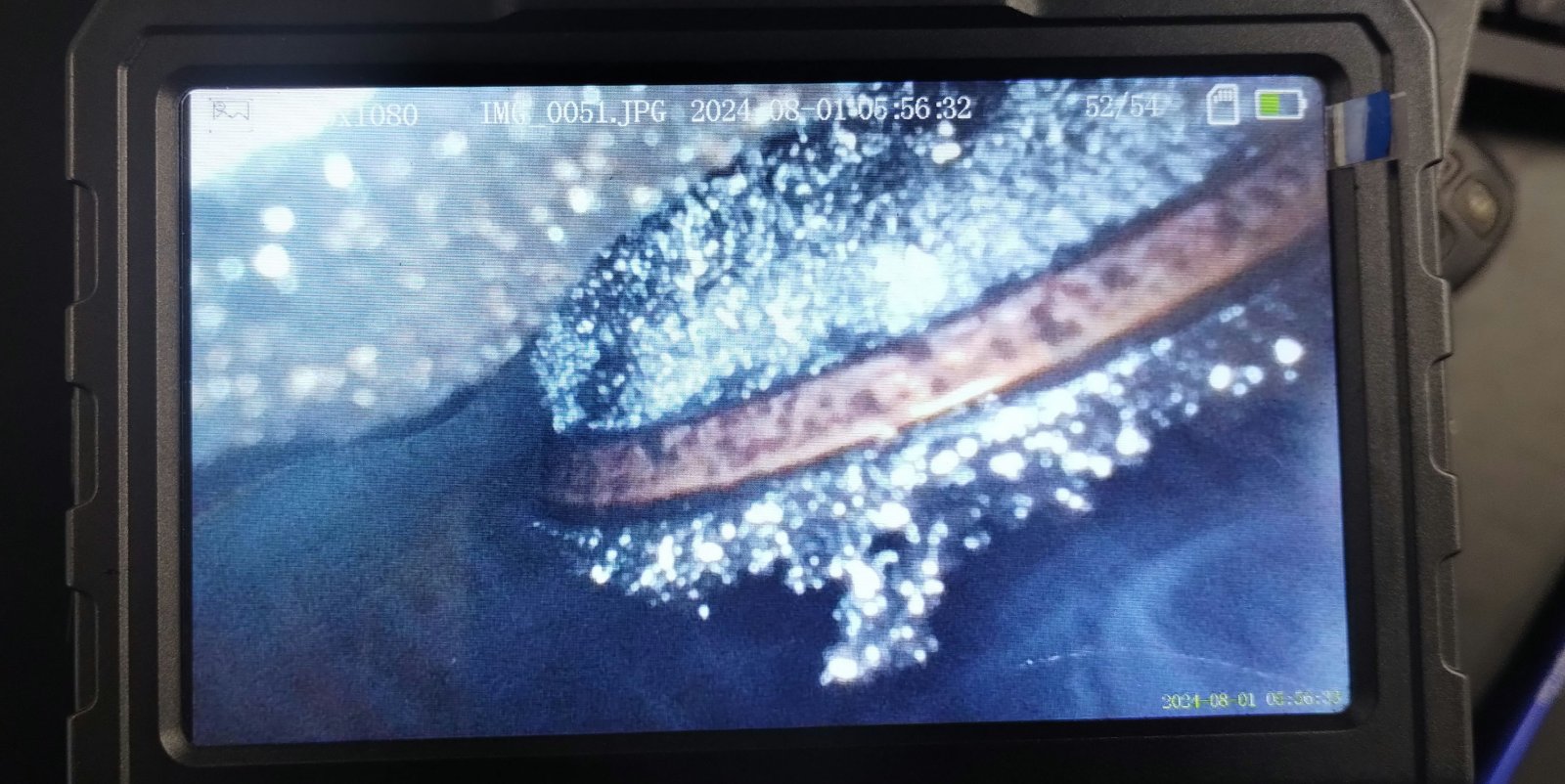

Post Mechanic Update:
The #1 cylinder is dead because from what he saw through a scope is a massive saturation of oil. In his opinion, a piece of carbon broke away and damaged the piston rings for that cylinder, and when it’s in its upstroke, the vacuum caused by the piston moving up the cylinder, is pulling oil into the cylinder. The engine is basically trying to burn oil. (There is NOT a saturation of fuel). He said when he first removed the plug, it was dripping oil and oil was running down the cylinder wall.
Carbon deposits on the valves is significant. (Photo)
In his opinion, the engine is toast and nothing short of replacing will improve it.
The #1 cylinder is dead because from what he saw through a scope is a massive saturation oil. In his opinion, a piece of carbon broke away and damaged the piston rings for that cylinder, and when it’s in its upstroke, the vacuum caused by the piston moving up the cylinder, is pulling oil into the cylinder. The engine is basically trying to burn oil. (There is NOT a saturation of fuel). He said when he first removed the plug, it was dripping oil and oil was running down the cylinder wall.
Another option is a piece of carbon is caught in a valve seat.
Take a piece of thick paper like an envelope and hold it against the tailpipe when running, let the exhaust flow push it away from the tip. If it gets sucked back to the tip in a very rapid fashion, then an exhaust valve is hanging open. If it was an intake it would pop back through the intake.
If the cylinder runs cold, you can get buildup. If it was a collapsed AFM lifter it would make a very pronounced tick.
Do the envelope test and let us know. I'm a little skeptical of the damaged ring by a piece of carbon....that's an extremely tight fit to get past the piston crown. Not saying it's not an option though.
You could have a faulty injector that's dribbling fuel instead of a fine mist...causing alot of carbon.
If I had to place a bet on a whim it would be a bad injector.
