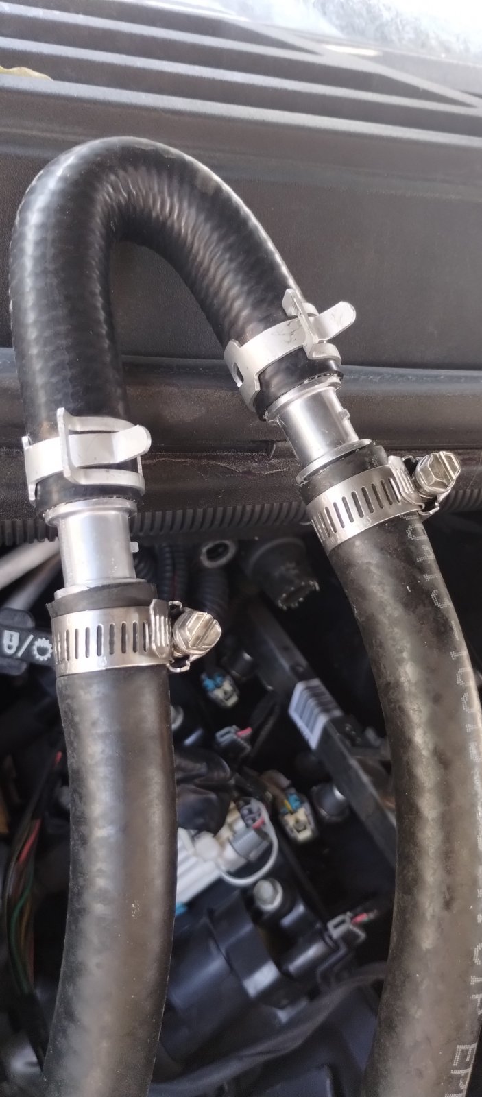

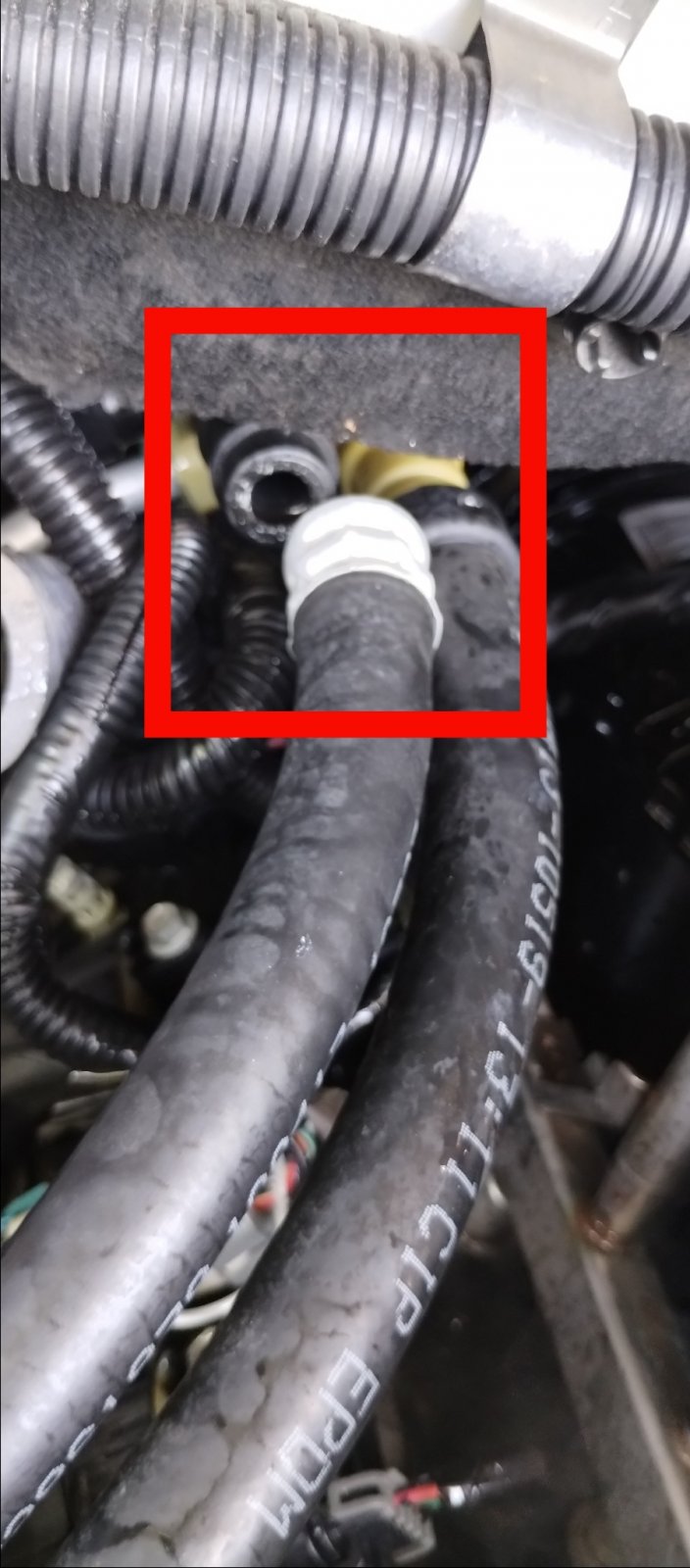

Okay, just went from bad to worse. I took her for a quick test drive and she started smoking just as I pulled back up my street. Popped the hood and found this.
Is this a line that leads to the heater core?

Connects to the rear heater pipe (one of two). If you don't have those two heater pipes then the fitting is not the correct one for your application.
I don't know. I haven't even looked yet. But thank you for the heads-up! I didn't know there were two possible configurations.
