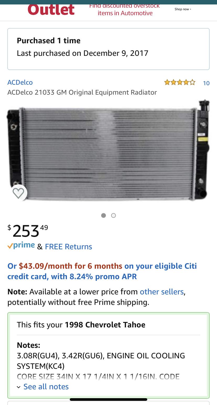

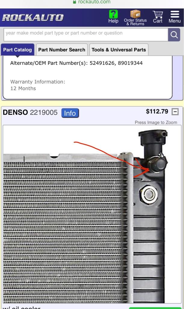

I’m going to take out radiator leaking out of same location as yesterday
If you’re going to replace the radiator, here is a “heads up” on what not to get...
A lot of aftermarket radiators have a spare port below the radiator fill that is not used on the vortec 350. They put a rubber cap and clamp on it. It will crack and leak (100% guaranteed) which you may not notice until it’s too late. Here’s a random one from rockauto:
The Delco version matches what came from the factory and does not include the spare port. I’d recommend going with that and saving yourself the aggravation. Here’s what I used on my 98 with oil and transmission cooler connections.

If you do go with the aftermarket with the port, you can get clear silicone straight tubing and cut to fit with 2 clamps and use a brass plug that has serrations at the clamp area so the second clamp has some grip for the tube when plug is inserted.
east302 is correct, that rubber cap from the aftermarket supplier will leak, absolutely 100% for certain it will.
