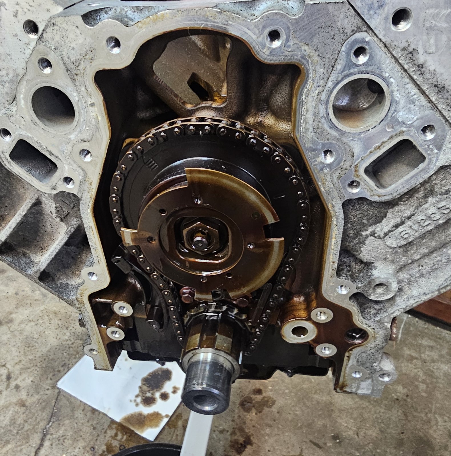

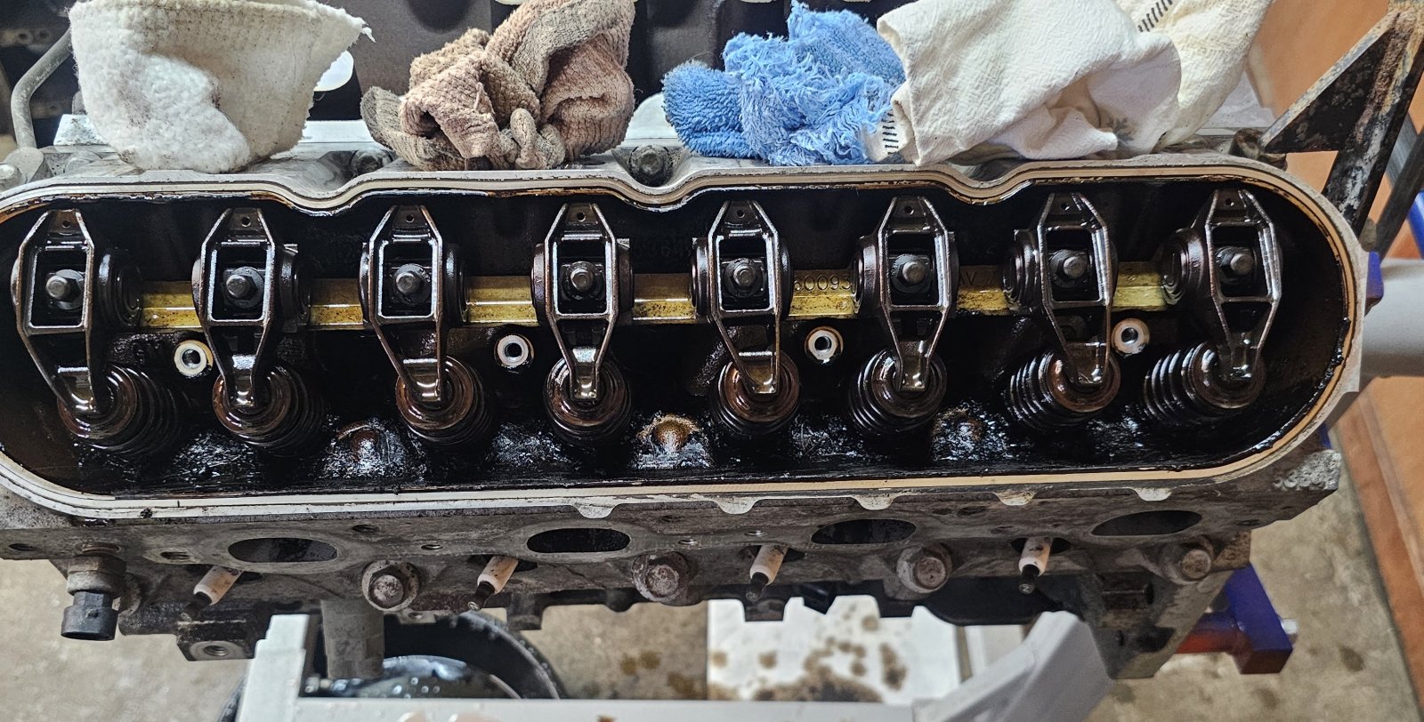

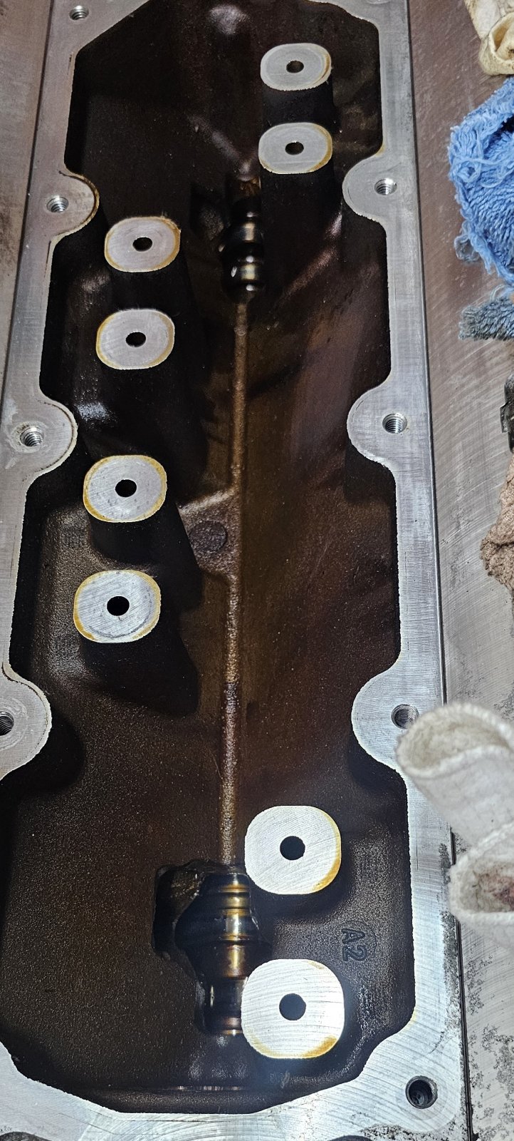

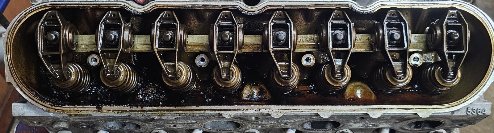

Got the replacement engine tore down for the gaskets and seals im replacing.
Overall not bad looking on the inside, but the heads do have a little sludge built up in them. It's not hard and baked, just gooey.
Need to flip it on its side to clean that out so none of it gets into the engine pita, but i can't leave it in there.
The oil pan has some gunk in the bottom like the heads, but i did not see any sparkly stuff at all and that's a big relief!

View attachment 441313View attachment 441314View attachment 441315View attachment 441316
You may want to Google info about those 5364 heads. I believe they have some issues, so if your current engine has 821/823 heads, use those instead
SpareParts
SpareParts
Sep 17, 2023
2,112
4,802
North Idaho
I actually did check on them as i had never seen them.
Are you thinking the 823 heads that are known to crack if they have a casting mark that looks like a battery?
As far as i can find reading 5364 heads are as good as the other two casting number heads you normally find on 6.2L engines.
