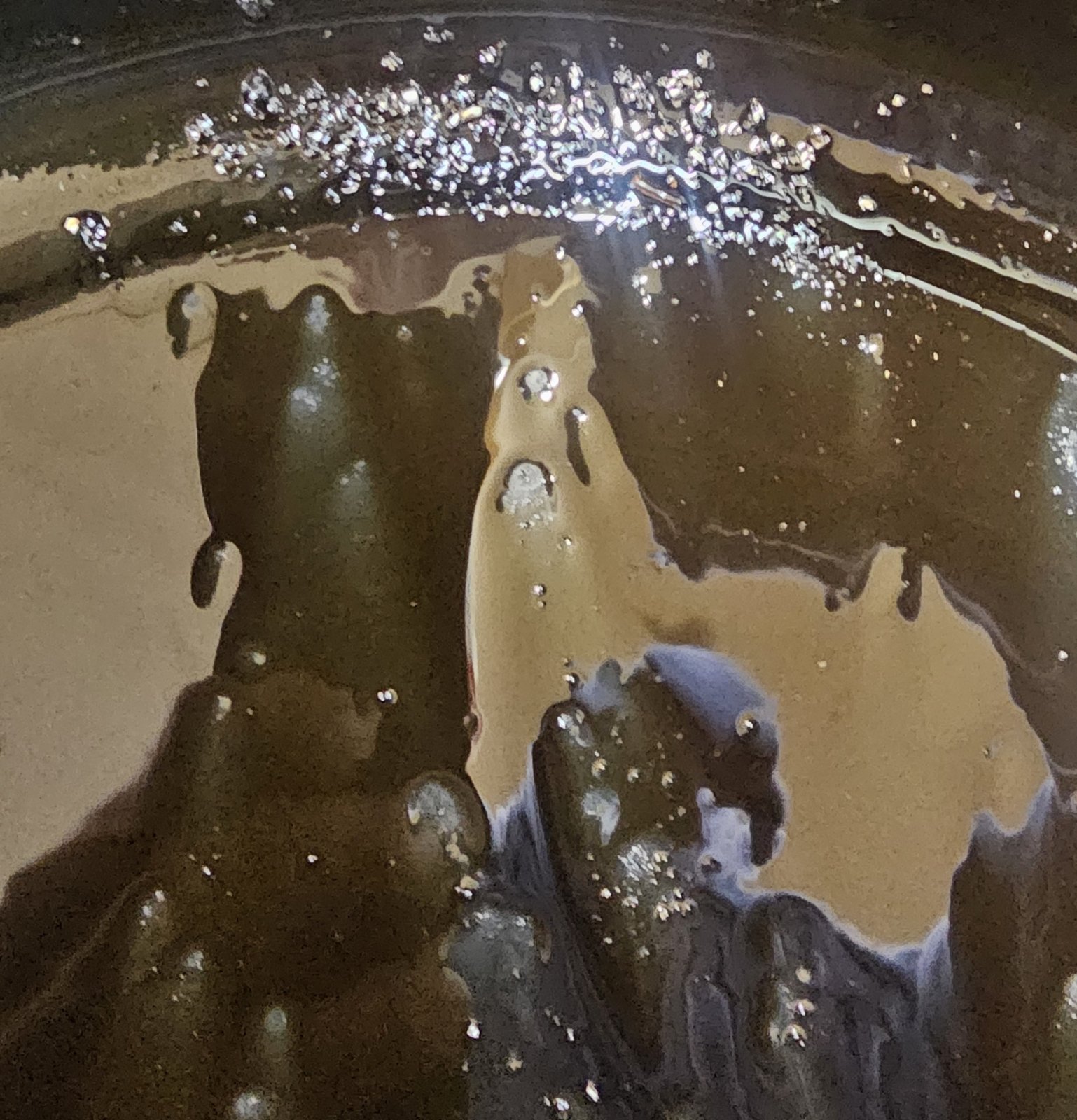

After changing oil i let the pan sit for close to a week (mostly because i was lazy but curious)
After carefully draining the pan this was in the bottom. Lots of sparkly stuff!
Nothing is going to fix that.
ouch.. is that all aluminum? wow.
any chance you have the oil filter still to cut open? I got into the habit it cutting my filters open to take a peak to look for signed it wear. so far I haven't found any yet thou.

The oil filter on the current engine was a Napa Platinum. Cut it apart the best i could and it did have a at least 8 shiny metal chips about like you see in the oil pan.
The filter on the Replacement engine was a Quaker State. Needed changed for sure but, It had no metal in it at all i could find.
After cutting apart both the filters i can say with out a doubt i would NEVER buy a Quaker State filter. It is total junk IMHO. Single layer with week pleating and nothing stopping it from collapsing, It is also has hard and brittle filter medium after use.
The Napa Platinum was constructed very well. Has 2 layers of pleated material with a mesh to help support it and stopping it from collapsing.

interesting you didn't find many in the filter as the pan. i hope you have time to take a look at the motor when you get it out. id have to go back and look but if it's a aluminum 6.2 it might be worth something if it's not damaged to badly.
