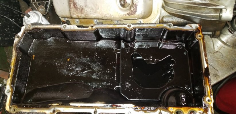

I think that's what happened to my Express van. Had the 4.8 with the 862 heads--which are known to be prone to cracks. When i sold my van the oil pressure was basically at 0. 20200114_190430.jpg20200114_190420.jpg
Your oil pan might have similar sludge too.

I think that's what happened to my Express van. Had the 4.8 with the 862 heads--which are known to be prone to cracks. When i sold my van the oil pressure was basically at 0.View attachment 443066View attachment 443067
My oil pan was very clean. Literally had to do virtually 0 cleaning when I dropped it. Was the original gasket btw. Hasn’t been dropped/ cleaned for 230k miles.
