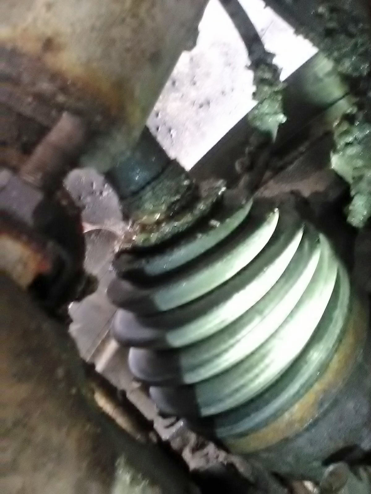

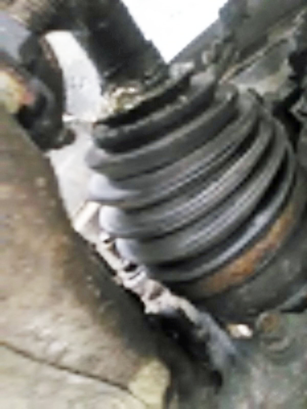

Only have poor pictures. Yes, the CV shaft at the outer end. Grease is on parts above and below but that doesn't show in the pictures.
Would make a scraping sound even if not in 4wd?

They're turning when the front wheels turn, so they could be making noise any time.
That's a problem, but it might not be THE problem. You might want to put the front up on jackstands, in 2wd, and turn each wheel by hand while watching and listening to find the sound. Also check the fluid level in the differential. The scraping could also be a brake issue.

you can replace it without to much trouble, you have to break that axle bolt loose (wheels on the ground), then jack it up by the frame so the front suspension is fully dropped, then finish removing the outer axle bolt, then you have around 8 bolts on the other end. once all the bolts are out you can wiggle and finagle it out, replacement is the reverse process, get it in there, then put those 8 bolts back in then the axle bolt, put it on the ground finish tightening the axle bolt.
that might not be your noise source though unless a majority of the grease is already gone, doesn't look that bad from the photos
if you have trouble getting the axle out you can use a separate jack under the spindle to lift the suspension a hair to help get it loose

The picture is bad because it doesn't show the accumulated grease on upper and lower suspension members (left axle); piles of grease like it's been thrown in gobs. On closer inspection the boots on the axles on both sides of the truck have the boots torn to some degree where they are clipped to the steel axle but the driver's side is the gusher.
I can not induce lateral movement in the axle at the joint but I can move it in and out along it's length enough to feel and hear.
