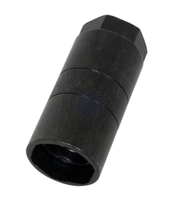

My oil gage has been pegged for sometime now (Pegs out without engine running). 5.3 LS runs and strong, no issues. Wondering if anyone had success changing their sending unit? What is the socket size for the unit? Sucker looks like it's back in there pretty good.
Let me know- thanks!
Dan
Moderator
16,670
34,512
People's Republic of Colorado
Lisle 13250 is the one. I changed one for my neighbor using it and not pulling the intake. A lot of that is by feel, but more do-able if you don't have gorilla mitts. Yours may not have that shield (that's in the way) shown in the video.
