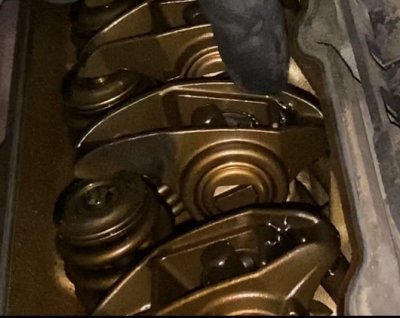

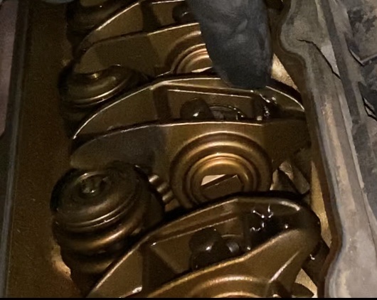

A week or two ago, while we were removing the wheel well liners, we noticed that the #4 spark plug was loose. The wire and shield were bouncing around and exhaust gases were coming out from around the plug. No misfires or CELs.
A few days later I inspected the plug, screwed it back in and put dielectric grease on the plug tip and wire that connects to the coil. All was good when we fired the engine.
On Saturday my daughters changed the oil and filter. Well, they drained the oil on Saturday and put the new filter on about 1/2 full of oil and on Sunday morning filled the motor with oil. Oil level is good. The next day we fired the motor and it made a funny sound that I cannot remember anymore and was also smoking, like an exhaust leak around #2. This turned out to be spilled oil.
On Thursday night we fired the motor again, I was at the wheel and it took a moment for the oil pressure to come up. This usually happens when the truck sits for more than a week. AFTER the pressure came up, a ticking sound began on the right bank, around #4 or #6.
Tech-2 shows no misfires and turning off those injectors results in dropped rpms. Took her for a test drive and she runs normal and as before, even on the highway. Traffic did not allow me to go full throttle.
Today the motor started again quiet but seconds later the tick started on that side. When using the mechanics stethoscope, we hear it in the injectors, loudest on the right bank and at #4. The exhaust manifolds are quiet, intake is quiet, touching the valve cover bolts, you can hear it a little. It can barely be heard on the driver's side outside, but you can hear it good on the passenger side even walking towards the rear of the truck.
The motor is on E85 currently, 3/4 tank. Fuel Trims are great, better than normal and at or close to zero (LTFTs).
Any ideas?

Funny that you say that. The shop manual mentions no such thing but everywhere else does. When we initially tightened the uppers and lowers, we positioned them as if the truck were sitting on its tires. When I do pull the wheels to tighten the rear nuts on the uppers, we're going to make sure that the arms are where they would be if the truck was sitting on the ground as before.
Post a video of the noise.
Your not "messing" with viscosity or brands of oil in anyway are you? even if the filter were dry everything should pump up within seconds without any brand changes in filter/oil vis. I dont have the afm system but it sounds like one lifter is jammed in the ramp area and needs to be freed up. Can you activate afm and allow the system to do its thing and possibly fix itself and then turn it off again? As you can tell i dont know shi! about afm, lol
Nope, same brand of oil and filter too. Good idea about AFM, thanks!
Sat one of my kids down yesterday to listen to some youtube videos of folks mentioning the same problem. She said it sounds like an exhaust leak to her and just like one of the videos. With all of my ailments, I'll trust her senses more than mine right now.
So after that I decided to take the truck out for a drive. My wife was suffering from a touch of cabin fever and joined me. I threw in all the straps and tow gear in case something happened in the back and off we went. About a quarter mile down the road we heard a clanging noise as the 22mm wrench my little one left on the upper control arm bolt fell away and onto the road. Turned around and picked it up and then got on it pretty good to get up to speed. The tires spun and traction control came on and the motor was running great.
Drove out to the Martin Road Scenic Highway and then back around towards town where we went off road to run in 4HI and 4LO for a few miles and got the truck covered in mud. After that we went to dinner. From inside the cab the sounds cannot be heard. Frankly, I think it is an exhaust leak now, there's no way the engine would run like that with a partially collapsed lifter and not throw codes or even a single misfire on the Tech-2. Could I be wrong?

Well, I guess the collapsed lifter cannot be completely ruled out. In my experience, a ticking lifter does not necessarily mean a collapsed lifter.
Don't hear anything amiss when the listening probe touches the manifolds or heads or valve cover bolts. The noise resonates through the injectors and is loudest at #4. I did not get a chance to put the probe under the manifolds at the head, would like to do that or even a piece of paper to see if the exhaust blows on it.
Very sore today and it is gorgeous out, so have been fiddling in the garage enjoying the weather and trying to rest my eye balls.
