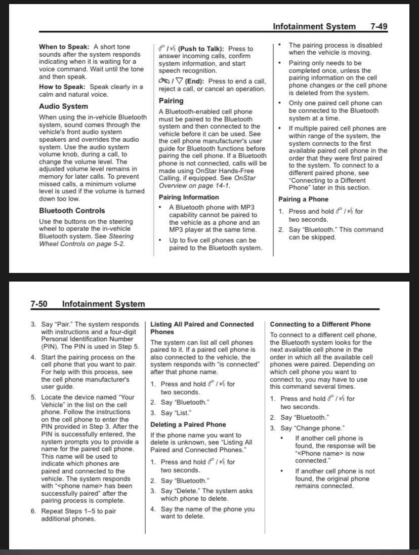

Not trying to assume anything here so if you don’t have a manual, here are the pages covering this.
This is the same instructions that I just tried on our 2013 as my new work iPhone was never paired. It also worked with my wife’s iPhone 8 when we first got the vehicle.
Make sure your phone isn’t plugged into the USB port in the console.

I do have my manual and have tried saying “Bluetooth”, “Pair Phone” and “Pair”. None of those commands do anything. All I get is a beep when I hold the phone button.
