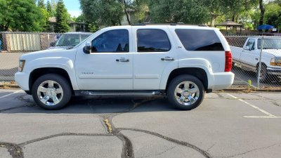

Here it is with the rear springs and shocks in.

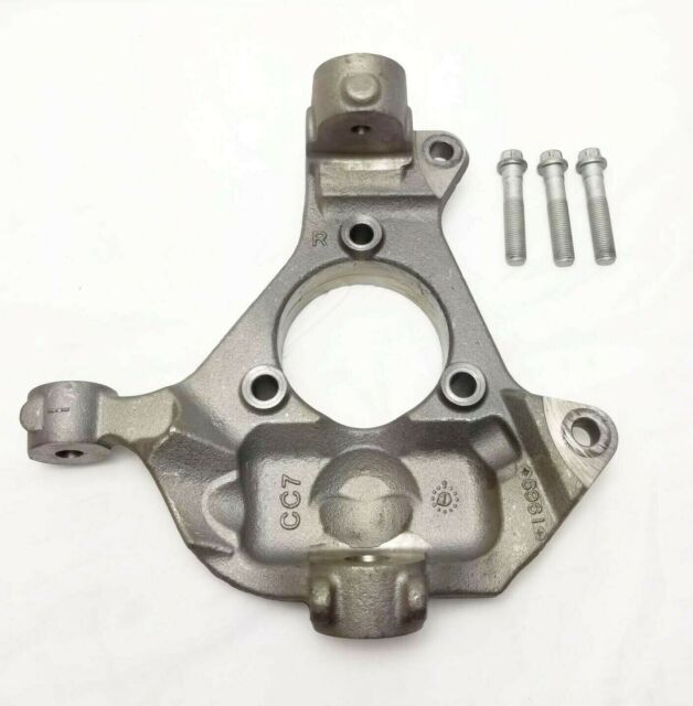

Awesome, looks better already and helps with the confidence going forward. This may have been asked. Are you sure they didn’t use drop spindles up front? @iamdub is there any easy way to identify drop spindles if you don’t have both?

Hard to tell but if the dealer says they’re stock we’ll roll with that. Your picture of the truck just looked a little lower in front but they may have gone the cheaper route. Which is good for you.
All you can really do by viewing from the back side with the wheels on is look at the position of the hub. It should be about centered between the ball joints but a little more toward the upper ball joint. On a lowering spindle, the hub will be 2" higher/closer to the upper ball joint. This puts that upper bolt hole in line with the upper ball joint and, on McGaughy spindles, it is eliminated and a screw-in stud is used.
Backside of OEM spindle, note how that top bolt hole is well under the upper ball joint boss:
Backside of drop spindle, note how that top bolt hole is much closer to the upper ball joint boss:

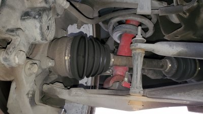

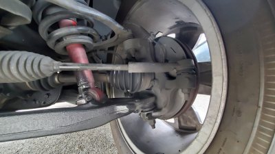

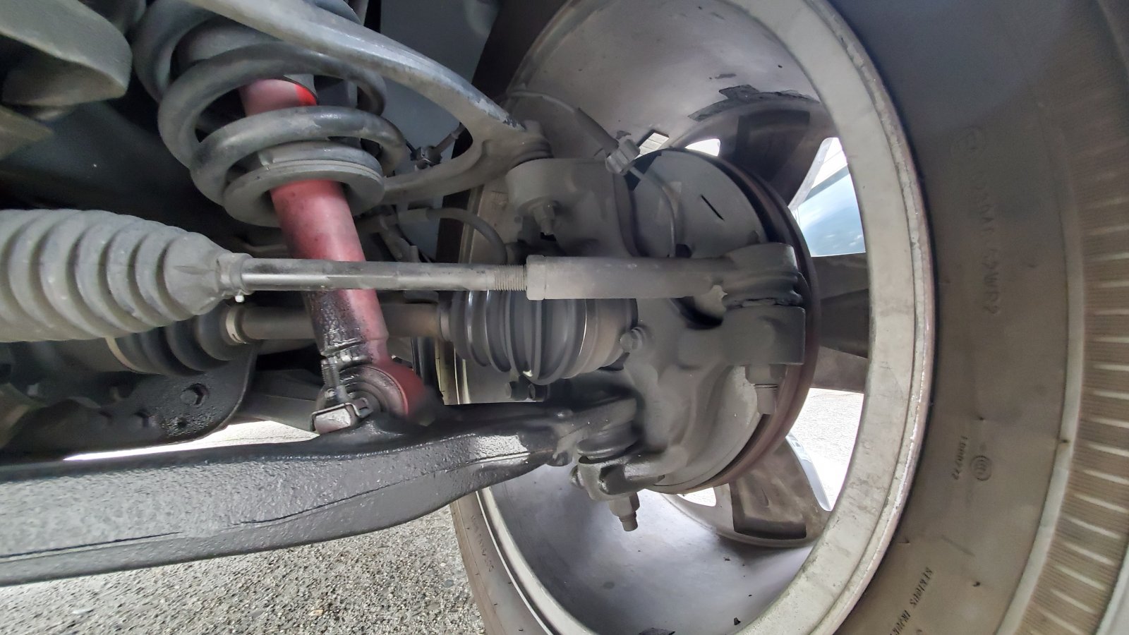

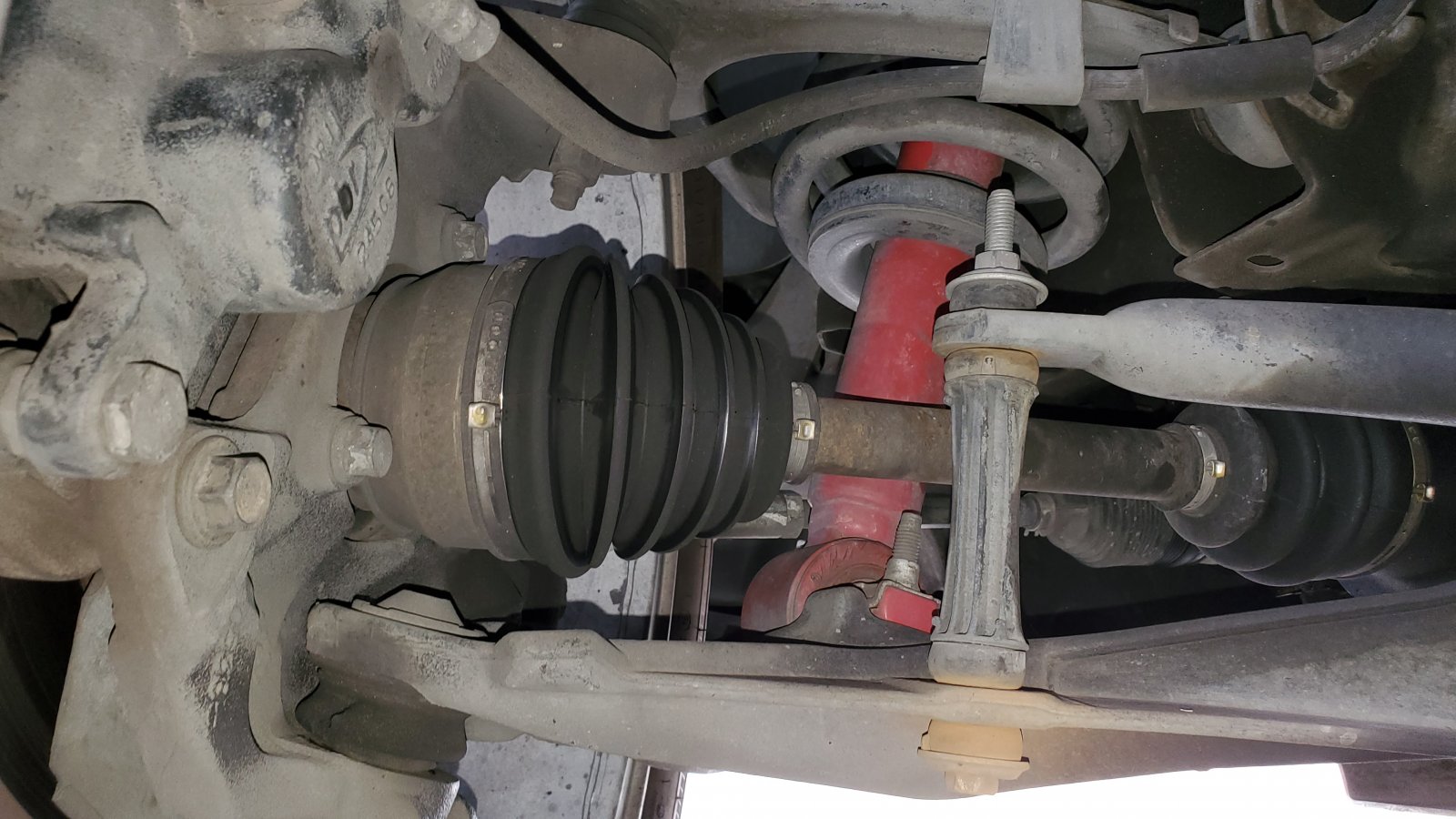

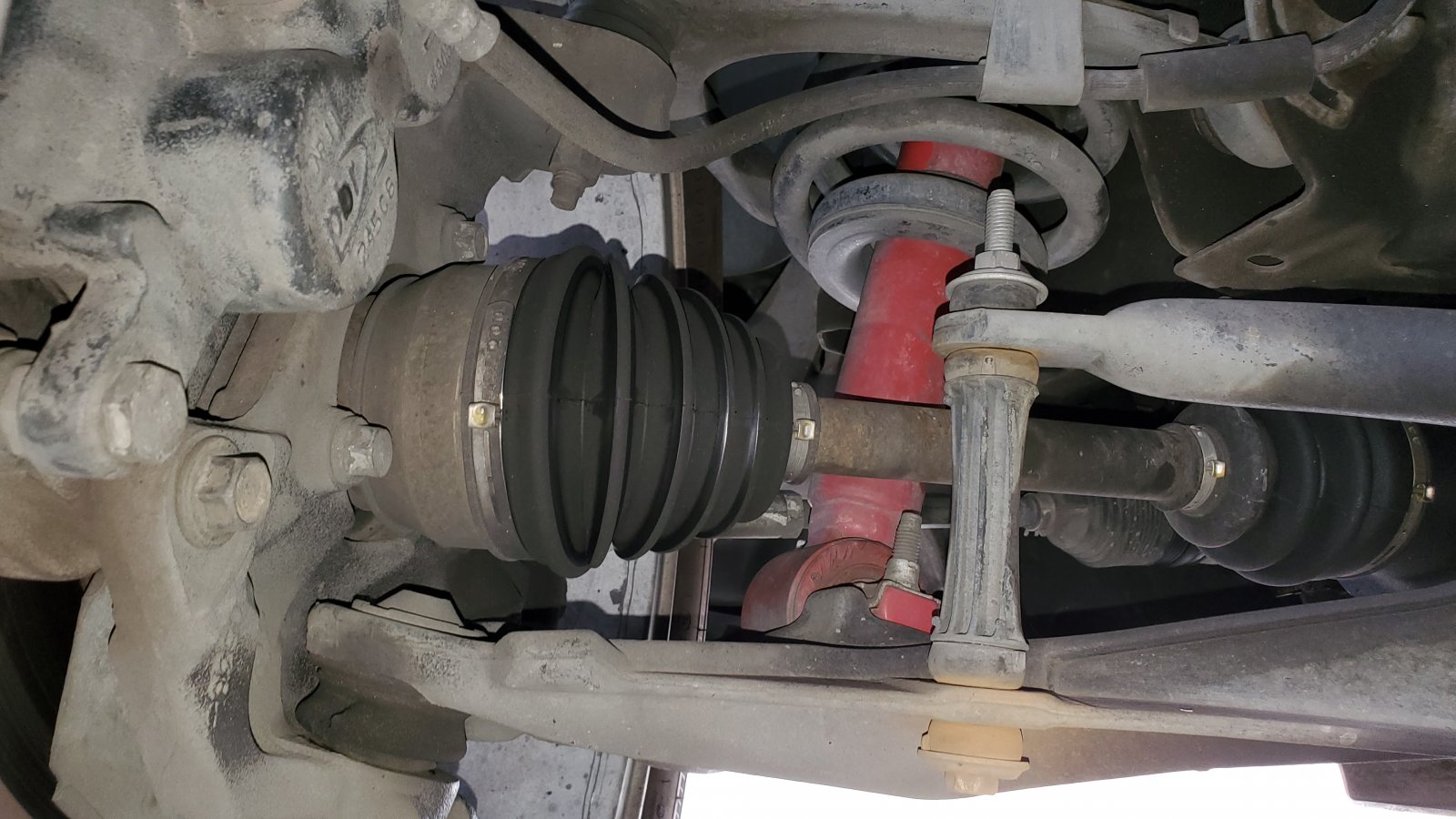

@Big Mama @iamdub Here are some pictures I took of the front, hopefully they are clear enough.
Definitely stock spindles. On a 4WD, since the hub location is moved upwards 2", the outer joint of the CV axle hits the stud and nut of the upper ball joint. The stud has to be trimmed and/or ground down flush with the nut. Sometimes the nut has to be ground down as well or a thinner nut is used. This is probably just with some aftermarket upper ball joints that have longer studs for whatever reason.

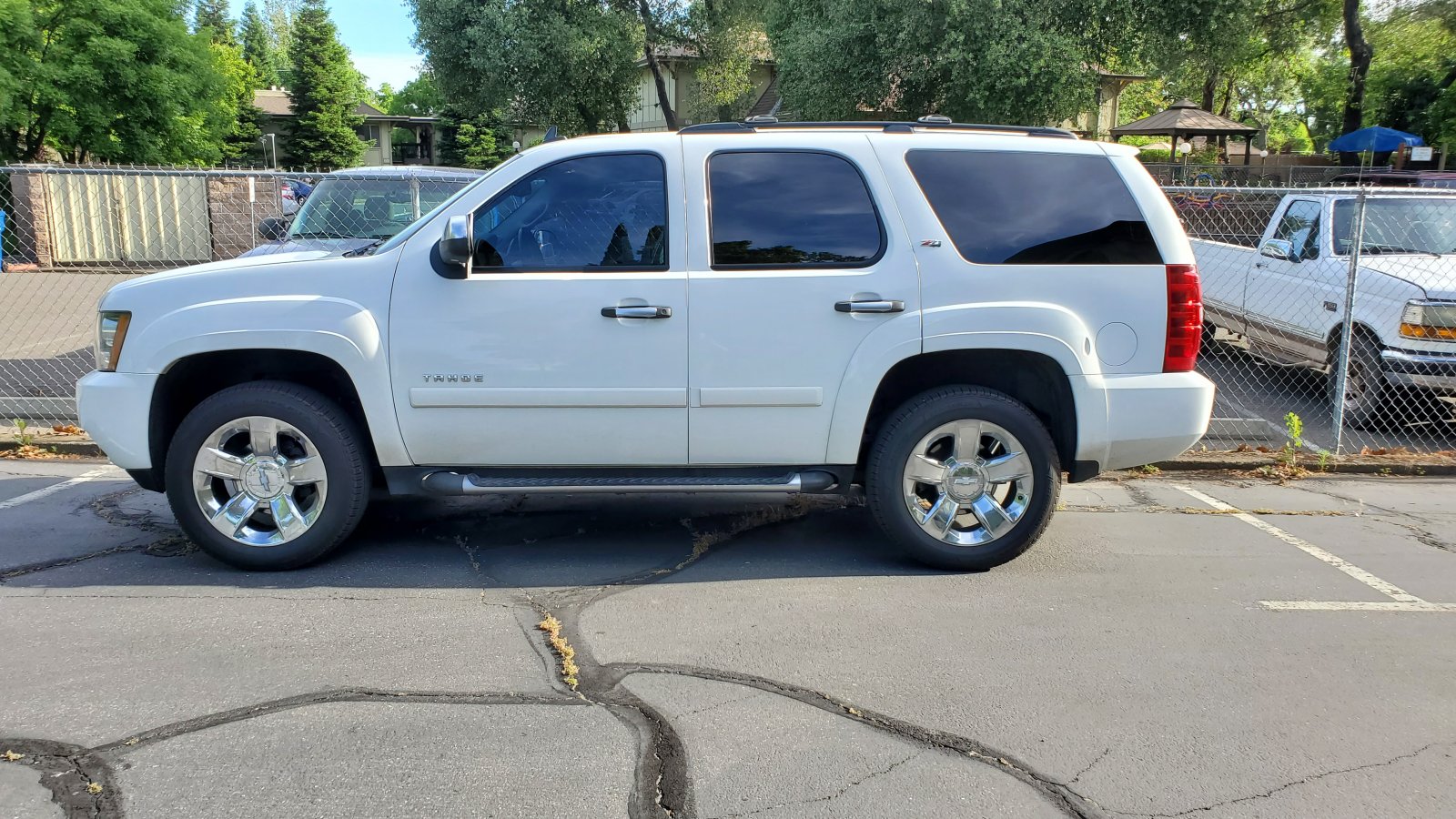

@iamdub @Big Mama @PNW VietVet Gentlemen I did it. I appreciate the assurance that I can do it myself and this weekend I finished up the front and now I am done and saved $1,200 in installation! Here is how the Tahoe sits with Bilstein 5100s set to factory height with MOOG 81244 springs in the front and MOOG 81069 springs in the rear.
