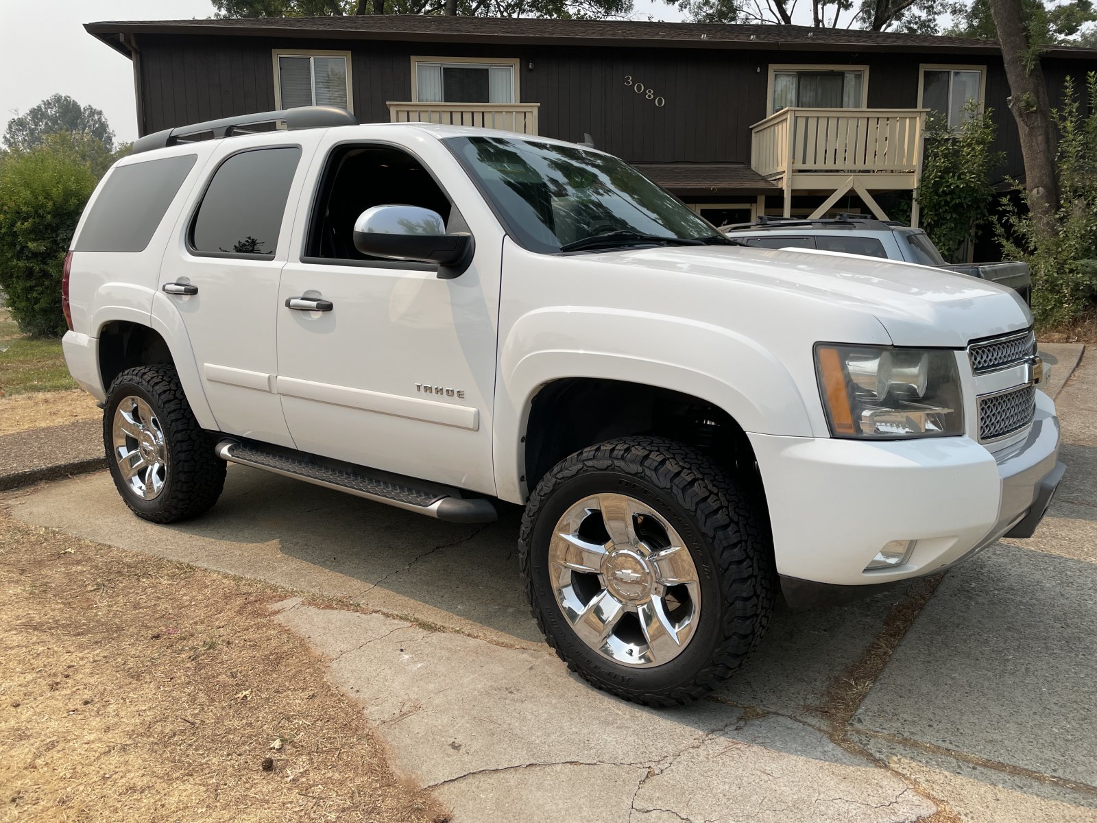

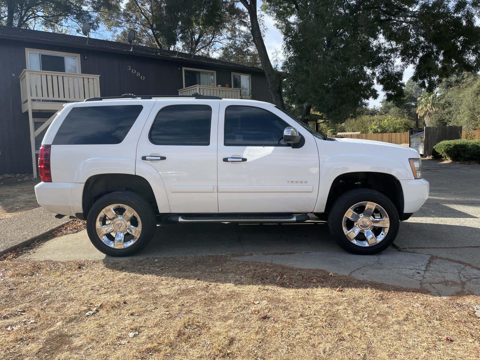

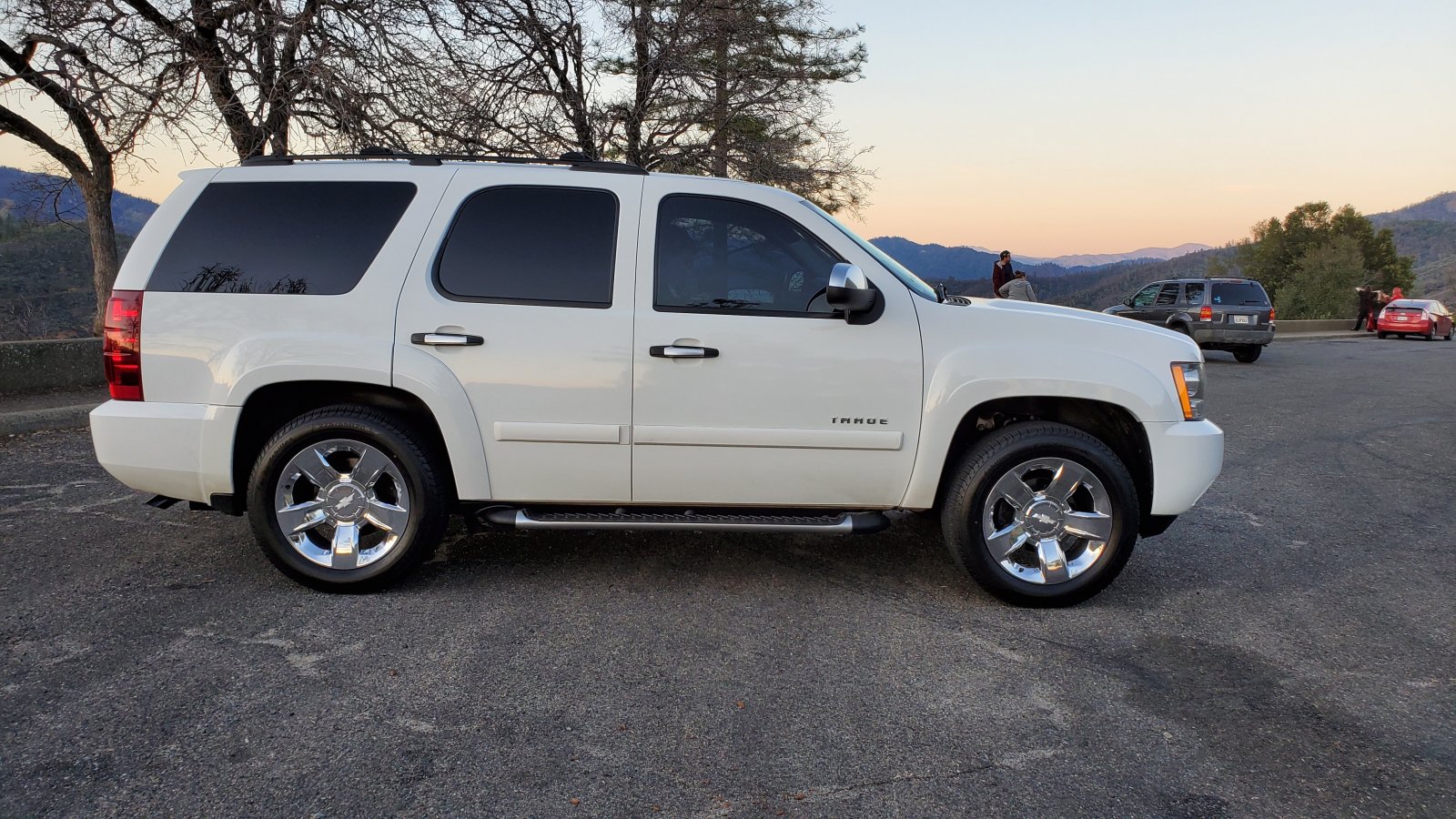

Update: I have installed some more goodies on the Tahoe and figured I'd drop a before and after pic of the rig comparing it to how it was when I got it compared to the work that I have done to it. I am not done yet. I think it looks a little goofy with the tire size on this lift but that will have to wait until I wear these tires out.
Thoughts?
Before:
After:

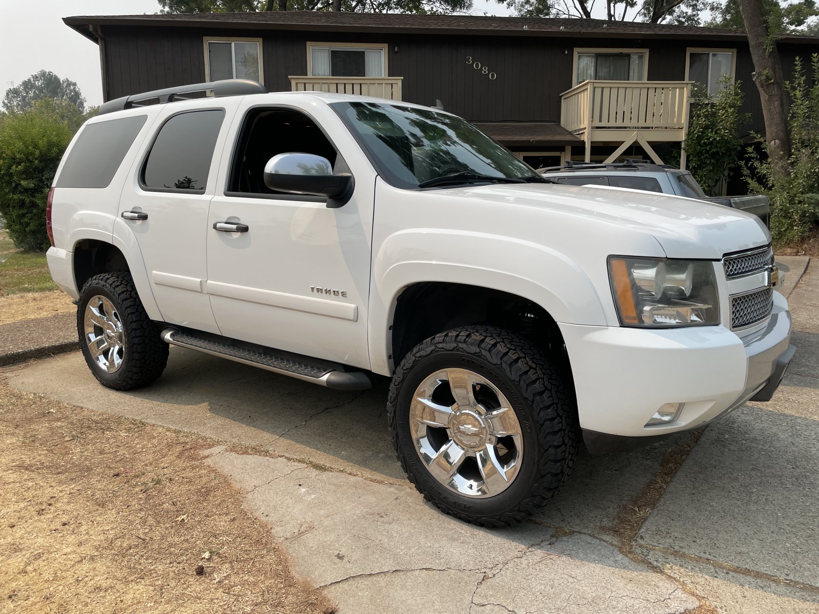

I just wanted to update everyone on my Tahoe.
All of the parts I have installed are holding up beautifully with the exception of the MOOG front tie rod ends, I am not a fan of the half dome rubber bushing design. I have ran this setup for about a year and I love it, my fiancé loves it, everyone loves it.
I just went and had some 275/60/R20 KO2 tires installed. I am running wheel spacers so I had to do some trimming but everything worked out.
I installed a 2nd gen Z71 roof rack about 6 months ago.
I installed Rough Country's rear shock extension brackets from their 3.5 inch lift kit to give my rear shocks more travel.
I installed an adjustable Spohn rear panhard bar to center my rear axle, after 3 inches of lift the rear wheels will start to stick out the passenger side as the axle becomes uncentered.
I installed JK 3 inch lift sway bar end links in the rear of my rig to help the rear sway bar work better.
I had a clunking on hard acceleration and it turned out to be my motor mounts. I replaced both of my mounts with Hummer H3 mounts and they are working great. No more clunking.
In conclusion I like the height I have it at, In the future I will get coil over of the proper length so that I can ditch the spacer lift parts but other than that I just drive it to work every day and take it on vacation.

Great tires! Aside from the function, they look SO much better. Beautiful rig, sir.
