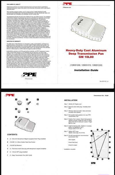

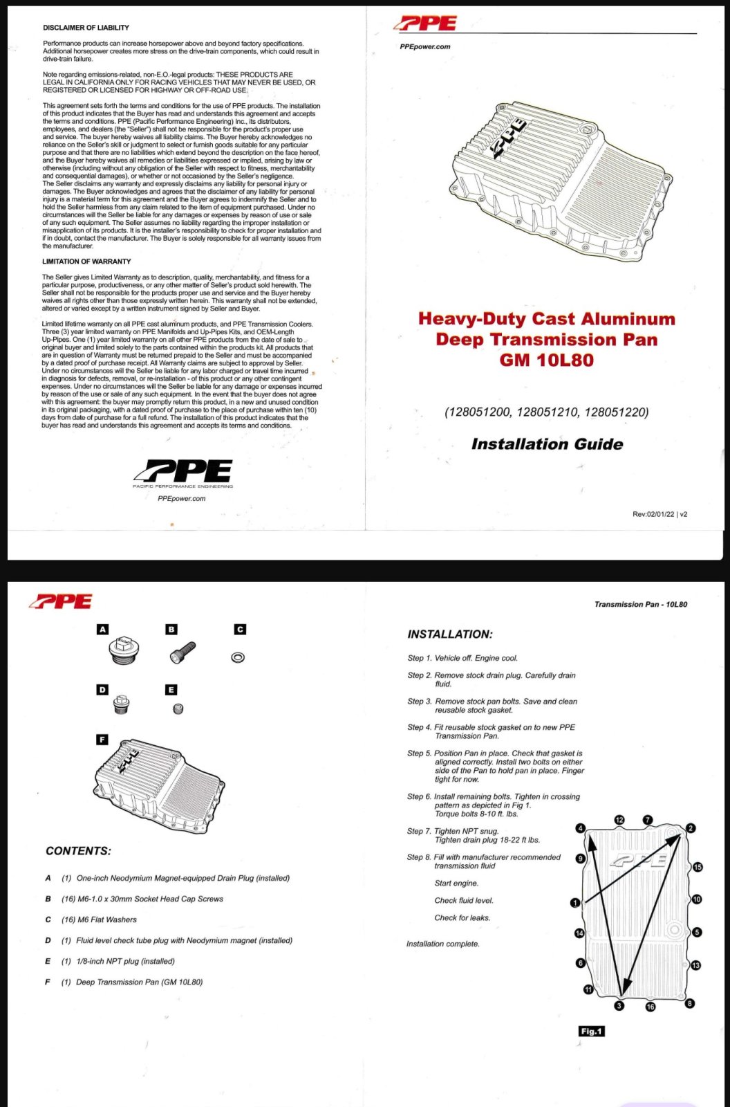

Thank you for the reply and my apologies about this late of a reply from my end. Somehow I missed the notification about this.
For dropping the Y-Pipe, did you have to do anything on the rear half like disconnect it from the hangars or was disconnecting from the front enough clearance? That's good to know about re-using the gaskets. I too tried prying with my 5 foot pry bar and stopped when I felt like I was going to break something (or myself).
Yes, the PPE pan comes with instructions and a better set of pan bolts. Here is an attached scan of the manual as a thank you for your reply.
