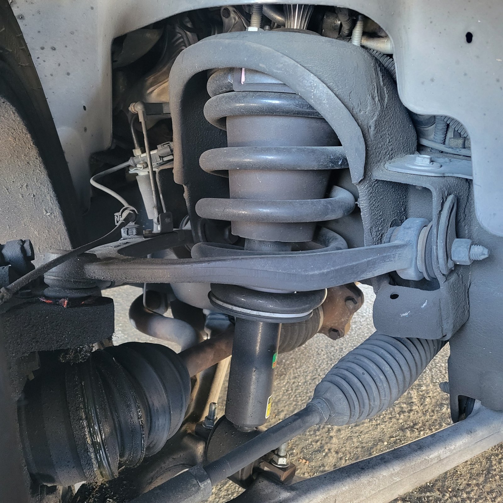

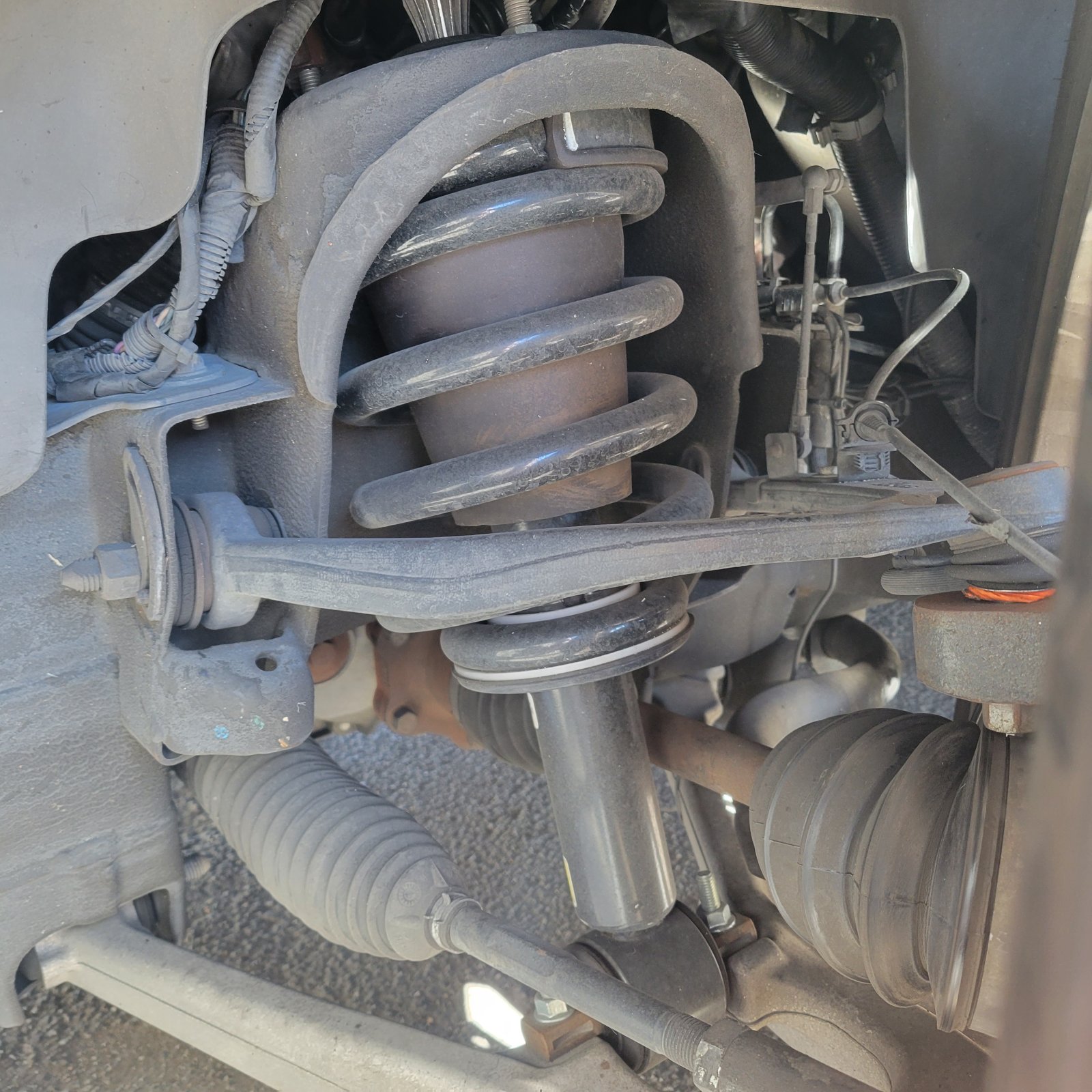

can you take pictures of the front shocks and upload them here, just like turn the wheel out so there is a clear view and snap a picture of each side.

Do you have caster max'ed out?
It looks like the front upper arm bolt is all the way out, so I'm guessing the back bolt is all the way in..
Curious what your caster is with those settings? (Because I want to adjust mine, though I'm not lowered)
A lot of the end up like that, especially with age once the bushings are worn.
And what is your caster with those settings?
When I took it to the alignment shop, the guy did say that he could not get it in perfect alignment even after he maxed out available settings.

mikez71
Mar 9, 2023
3,339
4,142
Thanks for that.
Guess the belltech spindle changes alignment some.. Maybe your rear bolts aren't all the way in if they can't get any closer...
Personally I like more neg camber than stock anyway, which call for -.7 to .5 positive..
I don't know why they let positive camber be in spec at all..
