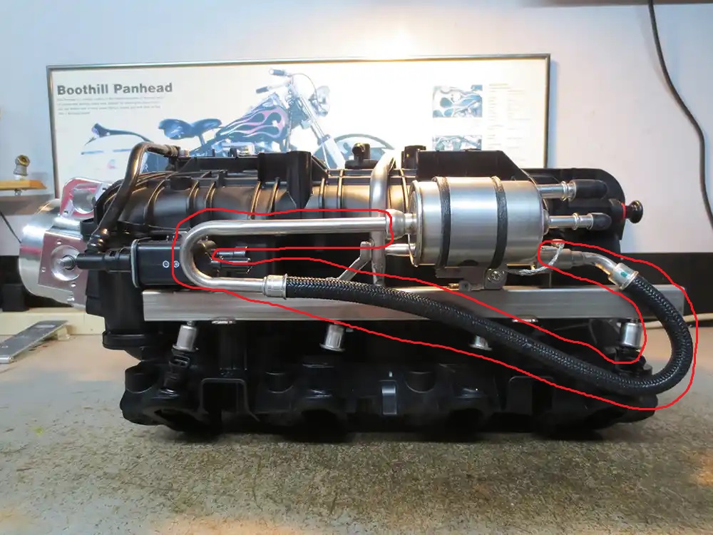

So I have all the parts required for the TBSS upgrade for my engine build. As I was piecing the components together I was not happy with how the C5 corvette filter/regulator would push my fuel lines further back towards and possibly against the firewall. So back to the drawing board/research. A member of this forum ( @Buggdave
) posted the attached picture. Looks like the direction I want to go. So currently researching companies that might be able to build the circled fuel line. Thoughts?

What kind of fittings are on the ends? If they’re GM quick connects you can make your own with AN fittings. I made a fuel line extension for mine.

@Rocket Man Mark, yes, they are gm quick 3/8 fittitings. I've never done that kind of thing before. Any background info would be appreciated.

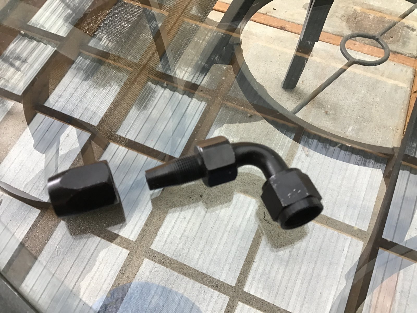

3/8” line is AN-6 so you need a bit of 3/8” braided line and the proper fittings. Jegs or Summit have pretty decent selections. You’ll need AN-6 to GM 3/8” quick connects for each end and it looks like an AN-6 180* for the left side in that picture. I have a 90* if you want it along with one quick connect, but I’m pretty sure you’d want a 180*. Just look until you find the ones you want. Assembly is super easy- remove the ferrule and slip it over the hose end and slide it down the hose a bit, slip the hose over the barb up to the threads, and screw the ferrule down. You just need to cut the braided line clean and if it’s nylon braided you need to melt the edge so it doesn’t fray otherwise you’ll never get the ferrule over it. I wrap the end with electrical tape before I cut it in the middle of the tape and then hit it with a lighter, then remove the tape. I am no expert though, I’ve only done a few.

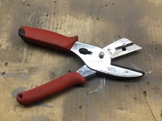

I use a cutter like this but don’t know what it’s called, utility cutter I think. The Craftsman one is hard to find now but there are others. They use utility knife blades. I’m sure there are other ways but I haven’t found a better one.

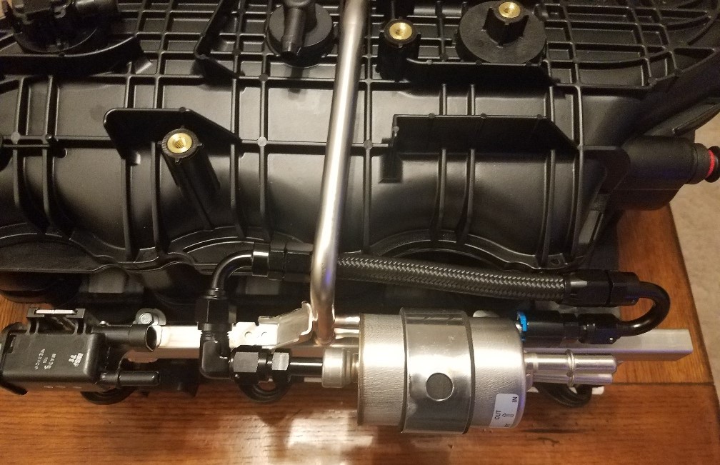

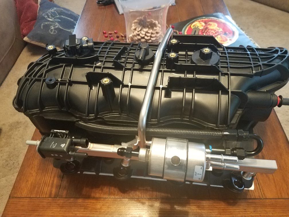

So the rest of my fittings were delivered. This is the final product. Looks great, takes up much less room than other solutions I have seen. Thanks again @Rocket Man . Hopefully, there will be no leaks. Now I have everything to install this bad boy. Just need a tune from BBP. Still have not heard from them yet. I will reach out again tomorrow morning.
