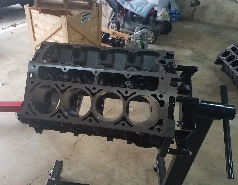

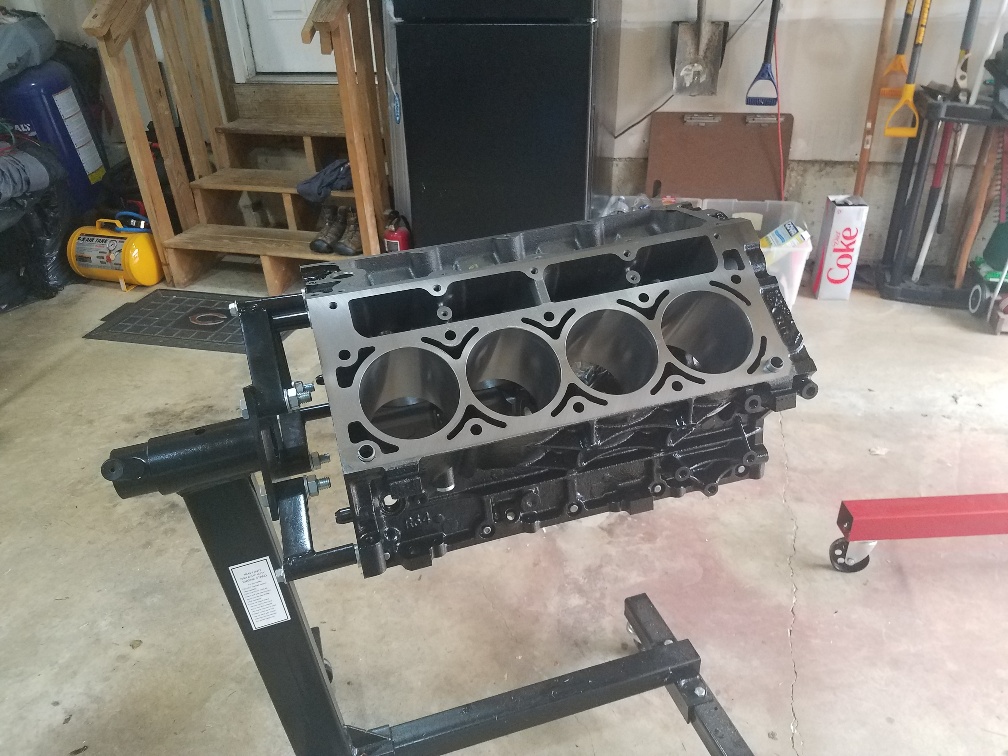

My block arrived this afternoon. The block looks clean and refurbished correctly. Checked the cylinders and they are correctly bored to 4.03" with great crass hatching. All flat surfaces have been cleaned and properly machined. Getting closer.

So last Friday I completely inspected and measured key components of this block and everything was super clean, outside painted nicely, preserved and the flat surfaces were measured to be flat. The bores of the cylinders were nicely honed and the bores were measured to be 4.03". Additionally, I was going over my notes and reviewing my Rotating Assembly order and realized I somehow ordered my crankshaft with a 58x reluctor wheel vice the 24x. Called them up and they were able to make that change for me. Glad I stumbled across this error before the rotating assembly was delivered.
