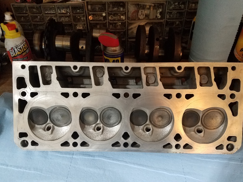

So after detailed research and understanding what I want from this build, I decided to utilize the 862 heads I have on hand currently. They were refurbished, modified slightly and already have double springs for my previous engine that threw a camshaft bearing. They only have 5K miles on them. So my decision was simply based on what I'm trying to do - increase low to midrange torque. I'm rarely above 5.5K rpm and I do tow our camper more and more these days - getting older you know enjoying the quiet times. I talked to Roger and my machine shop and they agreed that this was a good choice: will increase the compression ratio and match well to the custom cam he is making me. I know people will question this decision, I did too, but it will save me money and provide what I'm looking to achieve. So, let the cleaning begin.
