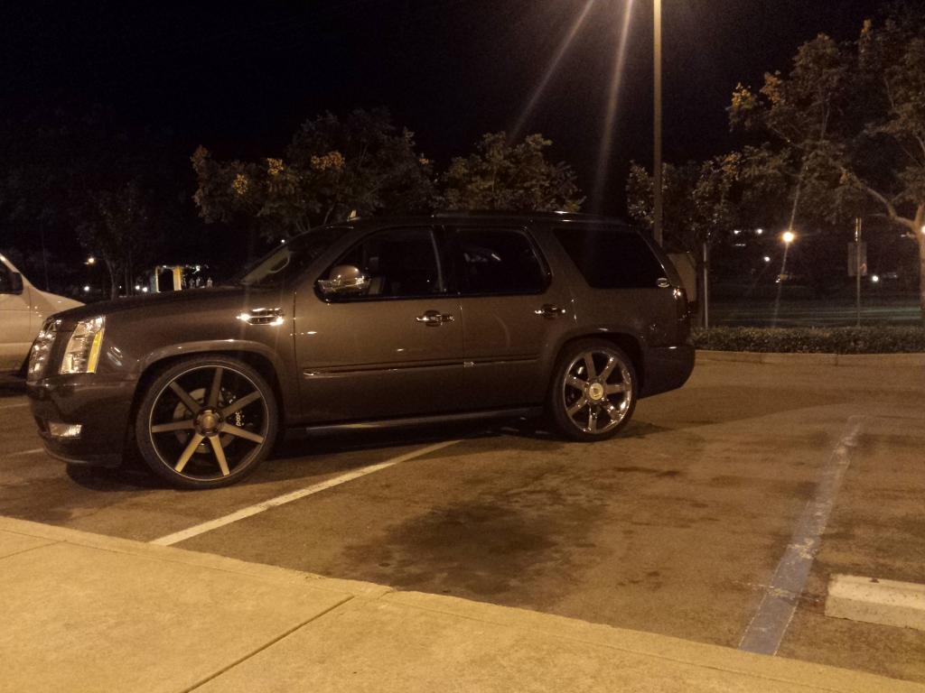

Today was fun. Moved the lower spohn control arms 3/4 of a inch back and the uppers moved 9/16 back. Welded on the autoride bracket onto the upper a arms and dialed it all in. Truck feels better now that the del sphere arms are in and rear end looks centered.
Now in front im going to have to roll the fenerwells tomorrow to get more clearance.
Also truck now sits at 33.25 in front and 33 9/16 in rear from ground to fenderlip.
Im going in at 8pm tonight to work and work till tomorrow 2pm and then going to clean truck and take nicer pictures.

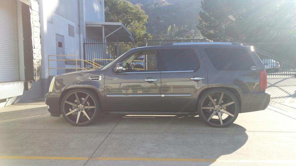

i was thinking about tinting chrome but i like the looks of the 24s when i go back to them. if i do anything i just might use plastidip to tint it lol
50,933
19,327
Those rims look good!!!
shundal
Sep 3, 2010
809
25
NorCal
Matches the exterior color pretty well. Really considering getting these wheels.
