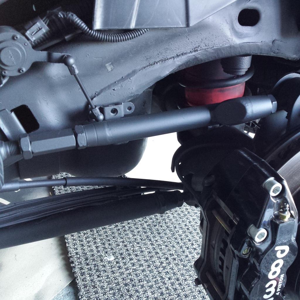

REAR AUTORIDE SHOCKS GONE. ended up putting the belltech sp shocks on and truck came down to 32 inches from ground to fenderlip. Put 15 psi in helper bags and back sits at 33 3/8. Perfect height and ride is better. Just need to wire in resistor tomorrow
Oh and I did my trick to the back of the truck to get both sides to sit even and now back sits even no more lean to drivers side.

Looks kinda cramped in there for an air nozzle but maybe it's just the pic

Aired up no issues. can get air hose in there pretty easy.

well clip broke on the wire harness htat sits on the outside of the framerail which will contact tire. So going to have to relocate the hanress since tire will make clip break again since will contact it at hard full lock.

what are you doing for the Brake line when you remove the factory panhard bar ? DO you just zip tie it to the new panhard bar ?

Duct tape. Always use duct tape
