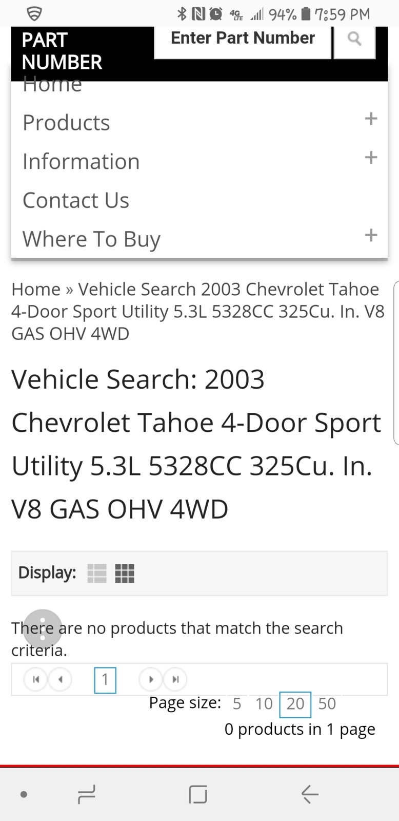

No problem I figured it out. I was trying to figure the inside diameter of the inlet/outlet pipes. Which if it’s 16g pipe, it would be 2 7/8” ID. Hopefully my math is right.
