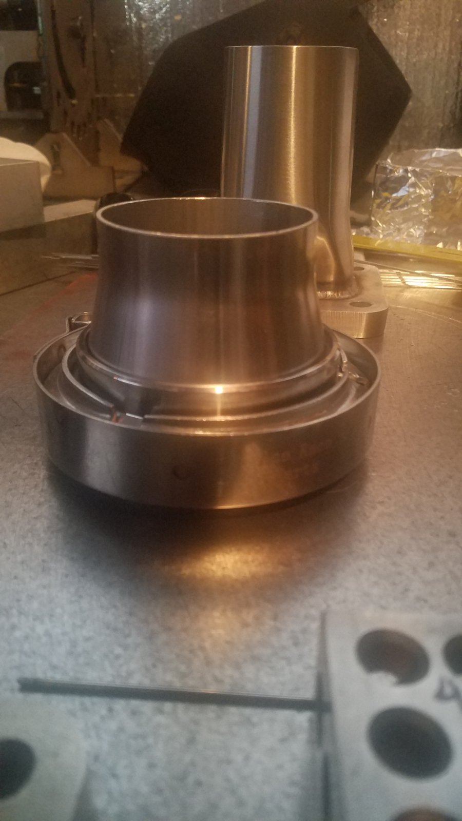

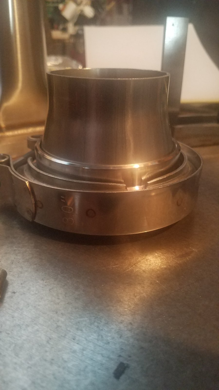

edit: Sorry, crappy pictures. This is what I'm doing but, this is going to be a full cat back system. I need to make a better reducer to fit the v-band a little tighter. But, you can get the idea of where I'm going. I used 2.5" ss tubing to make the reducers. I'm cutting the factory 2 bolt ball and socket and replacing it with a v-band to make it easily removeable. And I will make the rest in sections if I want to change things around.
