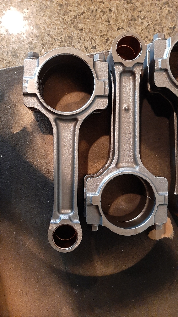

So the connecting rod mystery continues. I ordered another set of rods w/o the oil relief. They are refuebished and look like new. However, there is no casting number anywhere on any of the rods... It is super weird.
