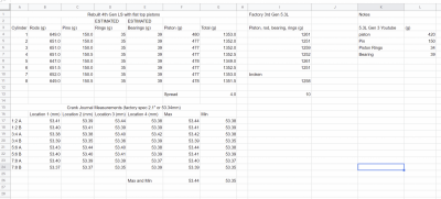

I'm on track to refurbish the parts, do some cleanup, and balancing. Worked for a long time on weighing the reciprocating mass (rods, pistons, etc). Chart with some figures thus far below.
Was amazed to see the factory rods spanned a weight range of 10 grams (granted they are not cleaned up). Gives and idea of tolerance on balancing.
I'm slowly but surely constructing a jig to measure the rod ends. Then I will remove material as necessary to balance the spread down to 1 gram or at least better than 4 grams.

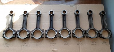

I'm trying to get equal weight on my connecting rods. The older style have a place to cut weight on them (counterbalance area). These new ones do not. I see some people just cut the rod itself at the ends. I don't like that idea as the most stress is on the rod ends.
Long story short, I think I'm just going to buy a bunch of used rods. Clean them up and use the ones that have the closest weight. Then sell the extras on eBay. I need to understand the casting numbers though.
