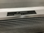

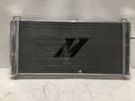

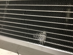

I'm still gathering parts, and I was thinking...my radiator is original. My friend who has been hooking me up with the cam and headers, also has a radiator that has 2 small dings that make it ugly if it's something you'd even see everyday. He's selling it to me for $350 and it's never been used.
Sorry for crappy quality, I copied his pics. Once I have it and put it in, I'll snap better pics.
33,344
51,834
View attachment 248885 View attachment 248886
If possible, you should pressure test it. Just to make sure the tubes didn't get damaged.
I have that radiator its really nice!

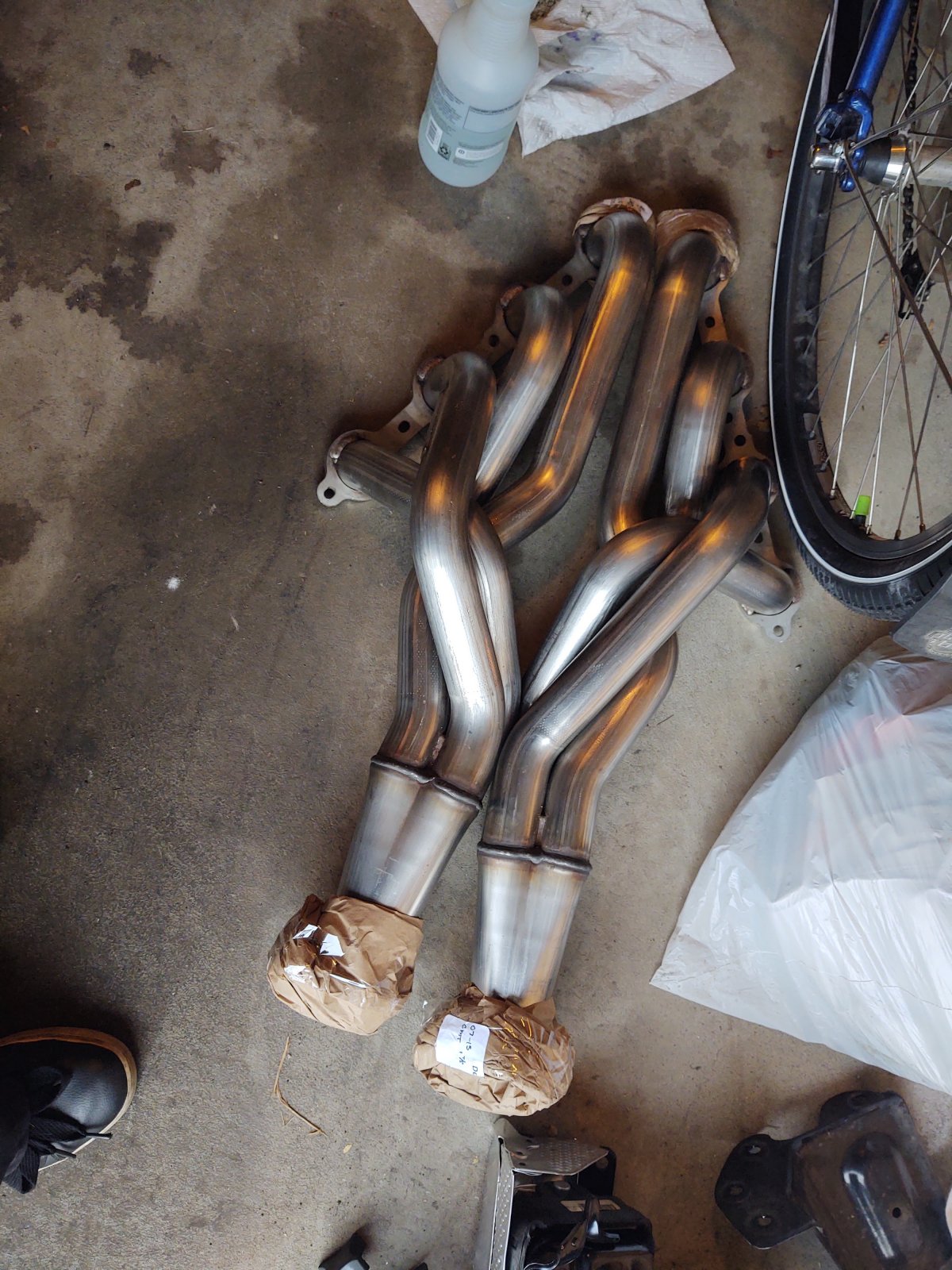

Man those headers look awesome!!!!!!!!!

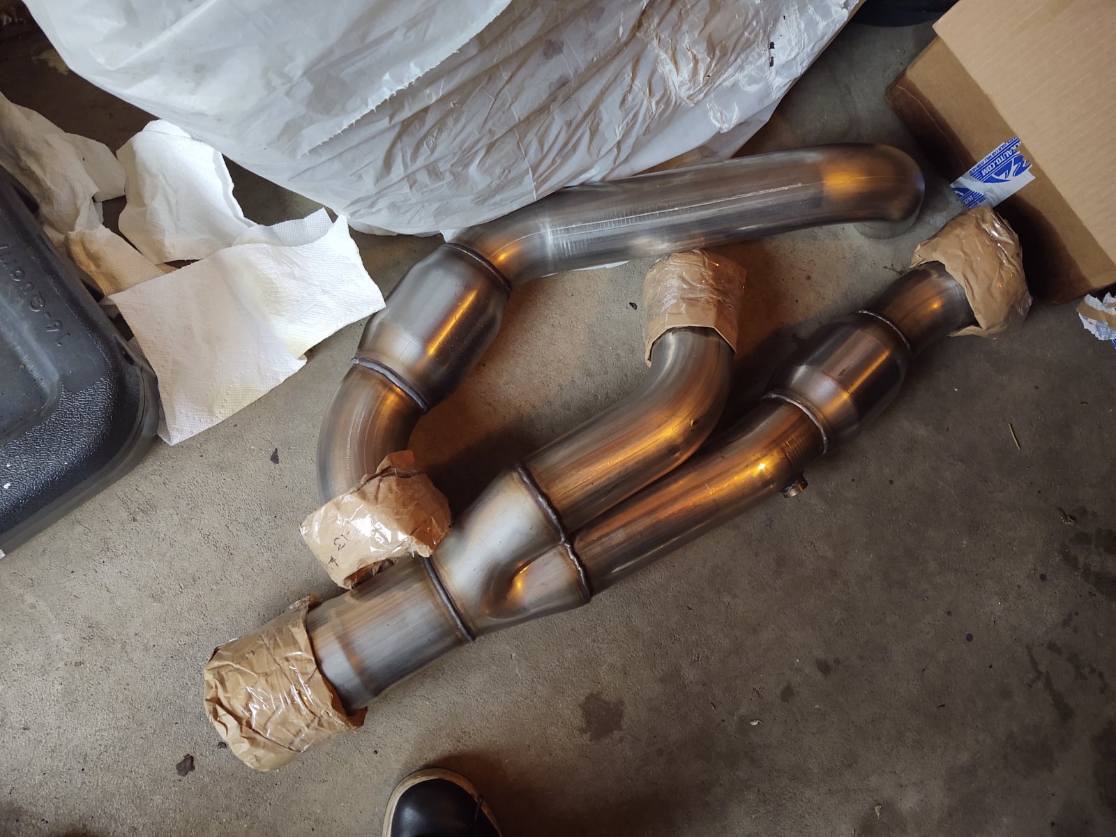

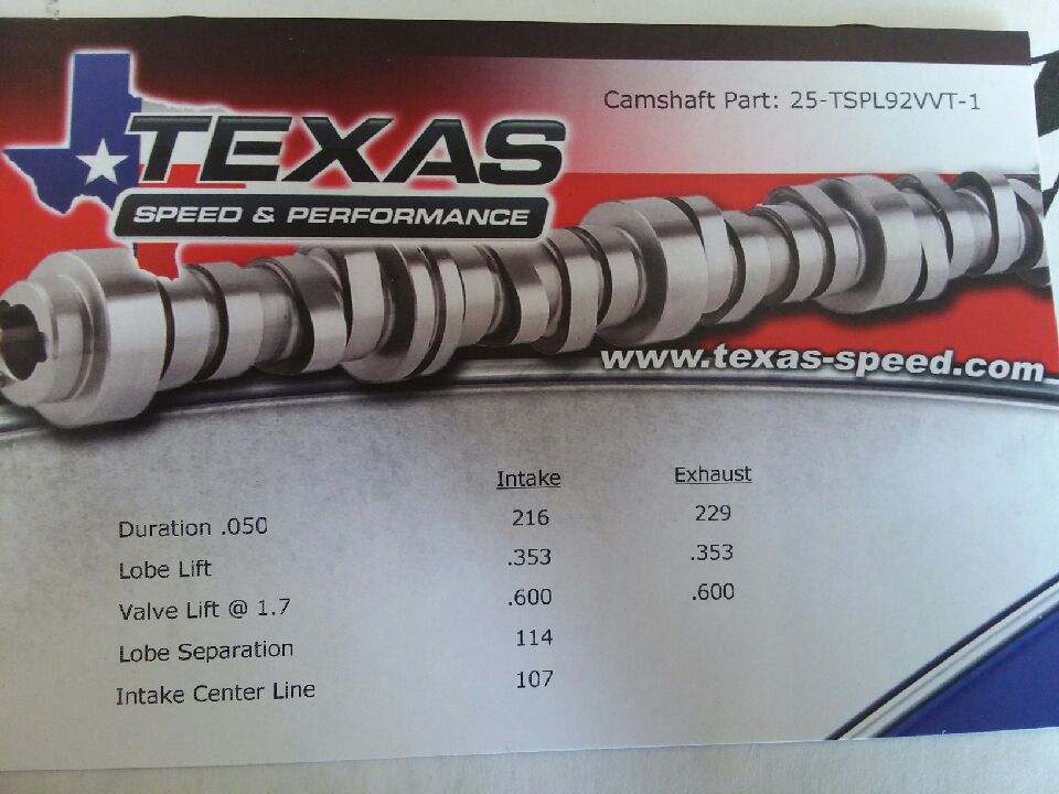

The new lifters haven't arrived yet, and I will also wait for my updated tune. I got the cam the other day, so today I can give Blackbear the specs and have a retune done so it'll at least run. I can't wait to get it all done though, this 6.2 is gonna scream.
After I get this portion of my build paid off by fall, I am going to the muffler shop, and add 3" true duals and exhaust cutouts for each bank.
